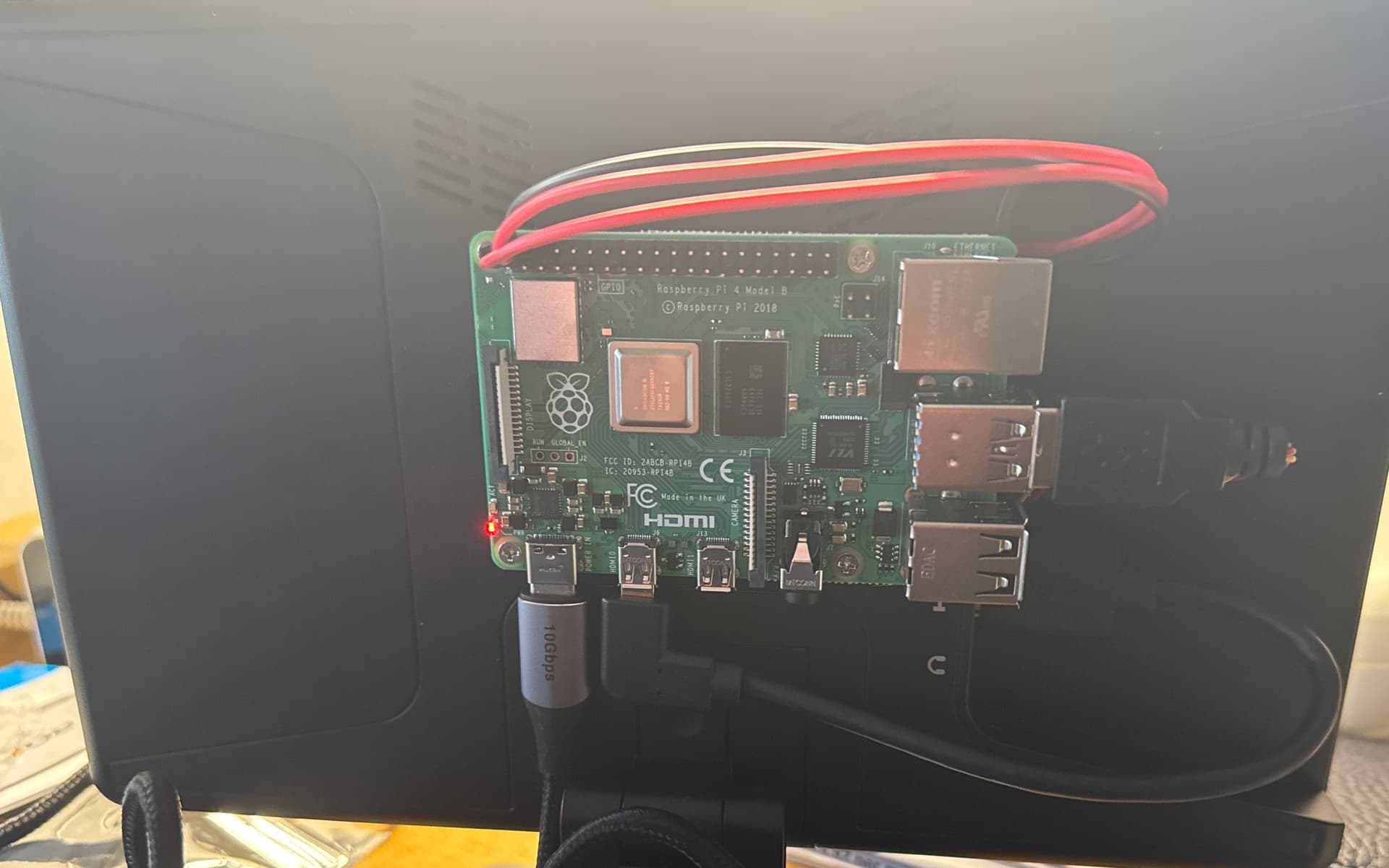

Picture frame with Roon interface
After recent comment in one of John Darko’s videos, I realized it would be neat to have a standalone Roon “now playing” display. I also thought when not playing music it could make a nice digital picture frame.
A quick weekend project later, here is roFrame. Link if anyone is interested:
Enjoy!

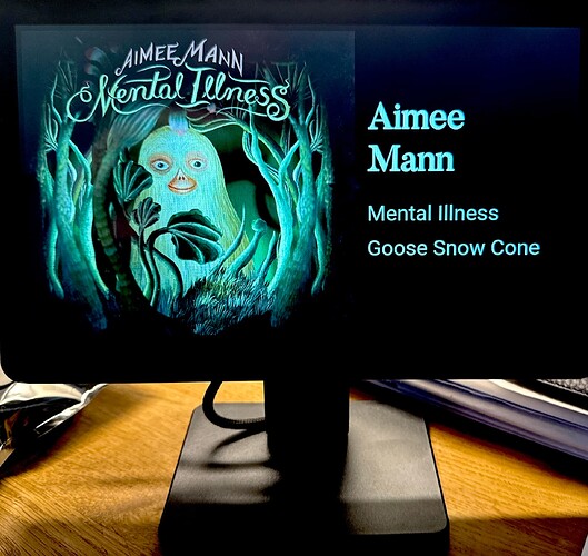

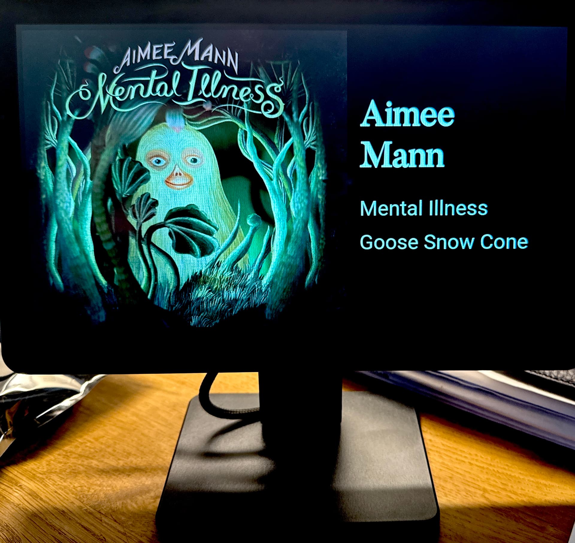

Thanks, Jaime, got my “now playing” display working with a slightly different monitor and it all seems to work well.

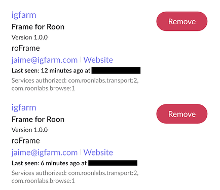

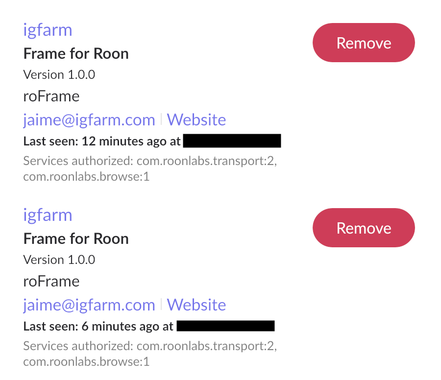

Only issue I see is that if you reboot the Pi you seem to get multiple entries in the Extensions / View and have to remove old ones and sometimes re-enable? Could just be me…
Thanks again, a great extension!
Thanks Russ! Happy is working for someone else :slight_smile: I’ll take a look at the multiple entry issue. I do see it in my Roon too.
