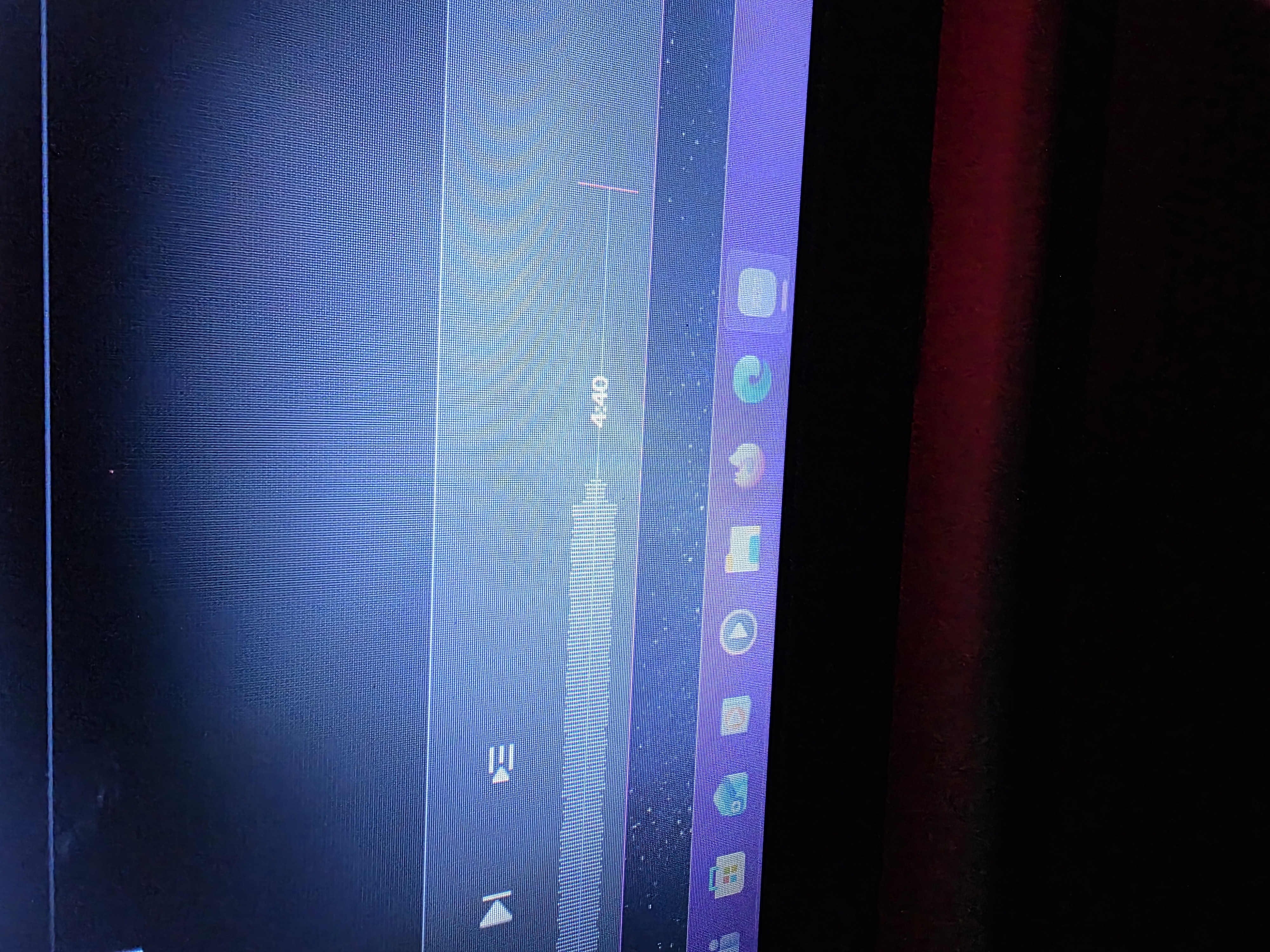

· On the play bar on bottom of screen, the red line keeps moving past end of song while a new song is playing. Also the play clock keeps moving . The artwork doesn’t move to next one. Never had this issue before. Been using roon for years. I tried everything I can think of, but it’s probably a bug or something. But this has been happening last couple of days. What is causing this?

It did it again. It restarts the song and then it passes clock on right side of playbar with a new song playing. Red line doesn’t stop. This happened after hour and half of listening playing music. An later has gone by it did it again. So it’s temporary to logout and log back in, but that’s not fixing issue.

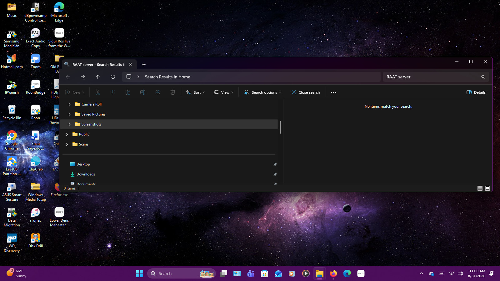

We’re unable to connect to your Roon Server to enable diganostics, so we’ll need a set of manual Roon and Roon Server logs in this case.
Can you please use the directions found here and send over a set of logs to our File Uploader? Once logs have been uploaded, please let us know so that we can check the server for your files, thanks!
I looked in my PC and not able to locate it.
I apologize. I did locate it. I sent the most recent folder. Let me know if you recieved it. Thanks.

A handful of your files are simply longer than the length Roon has recorded for them, and the progress bar is faithfully reporting that.
Take “Station to Station” from your 2016 remaster. Roon has it recorded as 10:17, so it expects the track to end there, but when it reads the file, the audio doesn’t run out until 14:42. Roon can’t move on until the file genuinely ends, so the timer keeps climbing and the artwork stays put, because as far as Roon is concerned that track is still playing.
It’s happening on exactly three albums, every track of each:
  • Blackstar (24/96), running ~25% long
  • Cracked Actor (Live) (24/96), ~27% long
  • Station To Station, 2016 remaster (24/192), ~43% long
The other 323 tracks you played across five days of logs all finished on time, and it’s perfectly repeatable, “Station to Station” overran by 4:41 on three separate plays. Your DSD256 upsampling isn’t the cause either: one Blackstar track played with DSD conversion off entirely and overran by the same amount.
