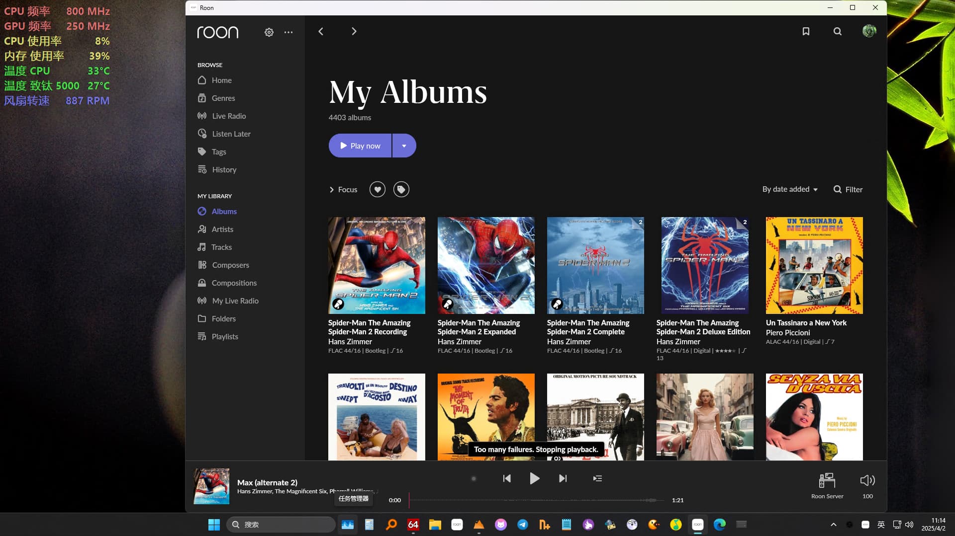

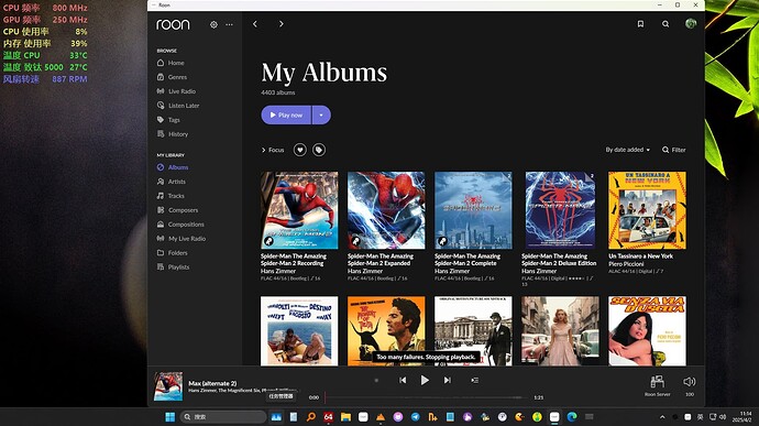

can't play music(no sound and switch to next track after press play button) display "too many failures,stopping palyback"
openwrt router and 10G+1g switch
Hi @Leslie_Zhou,
Thanks for reaching out to us about this issue. I think the next step here is to enable some diagnostics on your account so our technical staff can get some more insight into what’s going on here.
First, can you please reproduce the issue once more and note the time at which the error occurs. Then respond here with that time, and I’ll make sure we review the diagnostics related to that timestamp.
The issue occurred in the Beijing time zone on April 2, 2025, between 10:50 and 11:00.

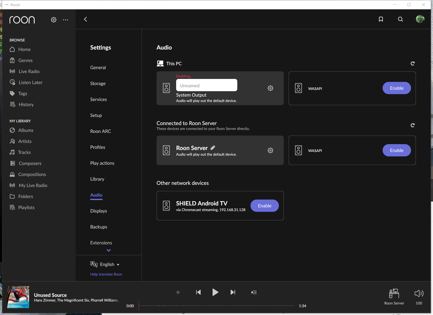

Other PC
Open Roon Remote on another pc within the same local network and enabling System Output audio, it continuously displays “Enabling…” in red text.

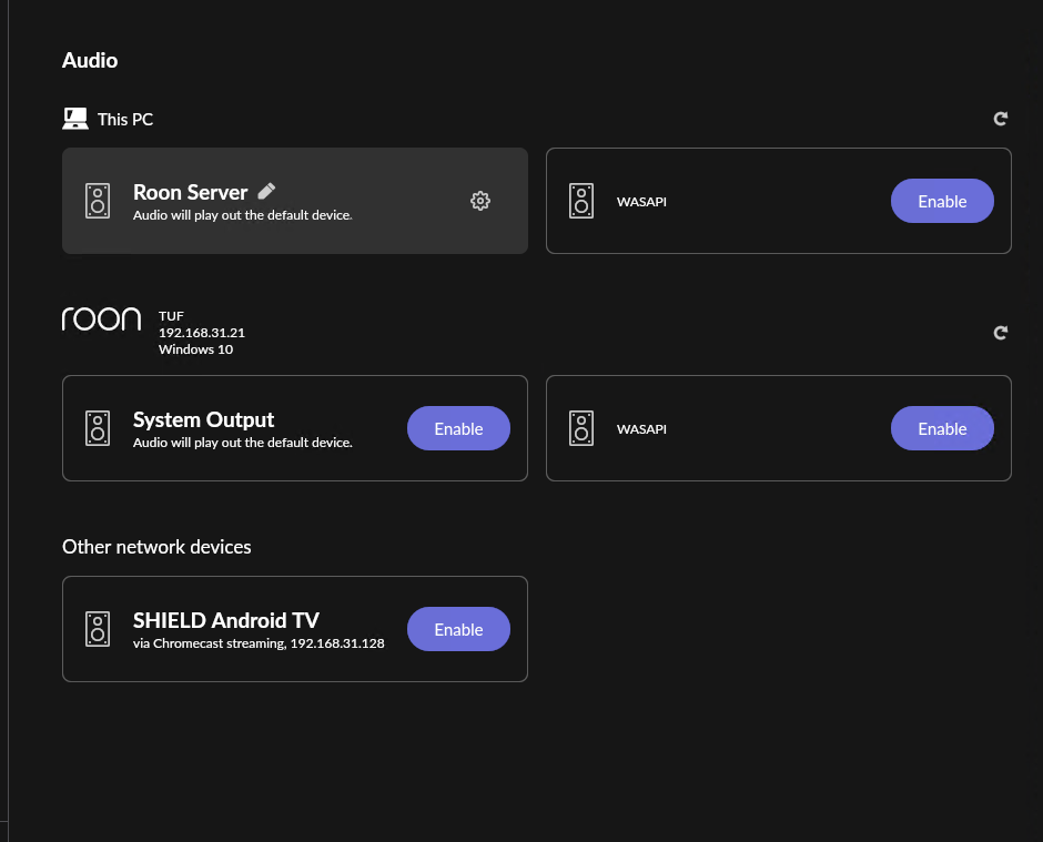

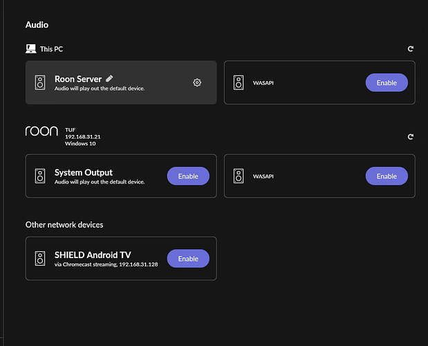

Roon Server
RAATserver folder renamed, but Roon remote app on the server still can not play music. (the test time is the same as the reply time)
Other PC (same lan with server)
Roon remote app is ok now. I don’t know why.
