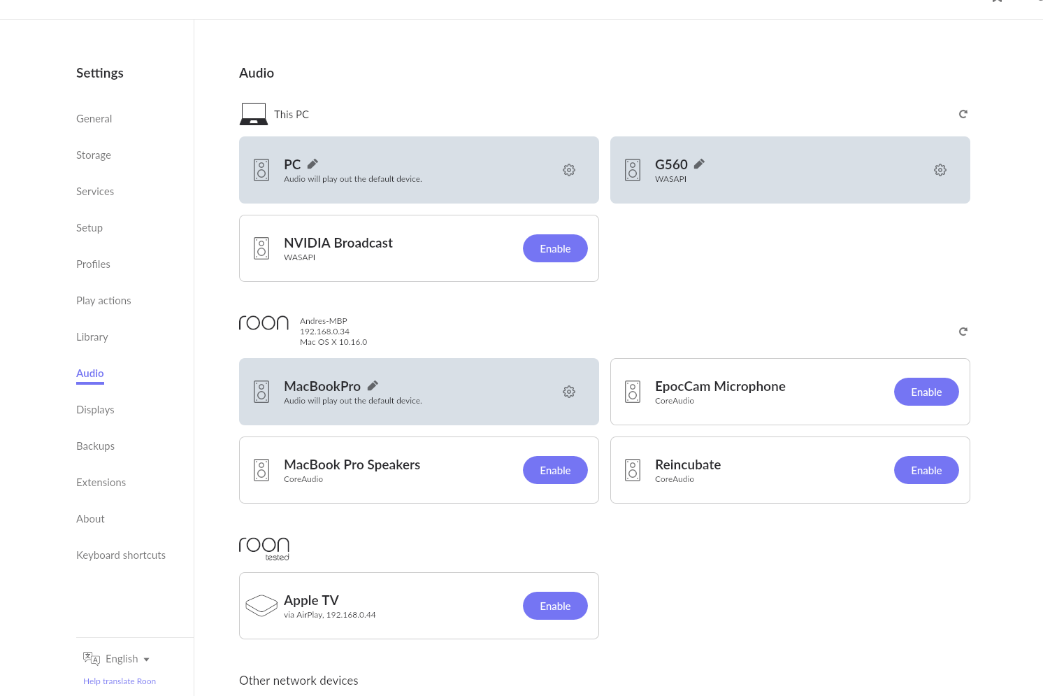

Playback in Roon is not possible with my Logitech G560 speakers "Too many failures. Stopping playback."
wired to a 1GbE switch
I also wanted to add, playback works with other local audio zones on my PC, but can’t get it to playback to my Logitech G560s attached via USB to this PC (will work via bluetooth on my laptop using these speakers as well). I’ve removed and reinstalled the driver for these speakers within device manager (don’t see a way to do that via Logitech’s G Hub - did confirm I’m running the latest firmware on these speakers).
This often happens when in Roon’s zone setup the zone is set to two channels only but Windows expects a multichannel setup for the device. Can be resolved by setting the zone to 5.1 or 7.1 in Roon’s zone settings. See also:

Thanks for the suggestion. Unfortunately, I tried setting it to 5.1 and 7.1 and have the same issue of all my audio tracks not playing (skips them).

Are you still seeing this issue at the present time? Looking over past threads, it looks like this might be related to the G560 driver somehow, if you try to play to your System Output zone and redirect System Output to the Logitech does that work? Related thread here:
Hi Noris. Same issue and, unfortunately, tracks continue to skip when I choose system output zone. I plan to remove the G560s and revert back to my old faithful Logitech speakers via optical out which worked fine. I switched as I wanted to try a new pair of speakers. Oh well! Not happy with the audio quality of the G560s anyhow.
