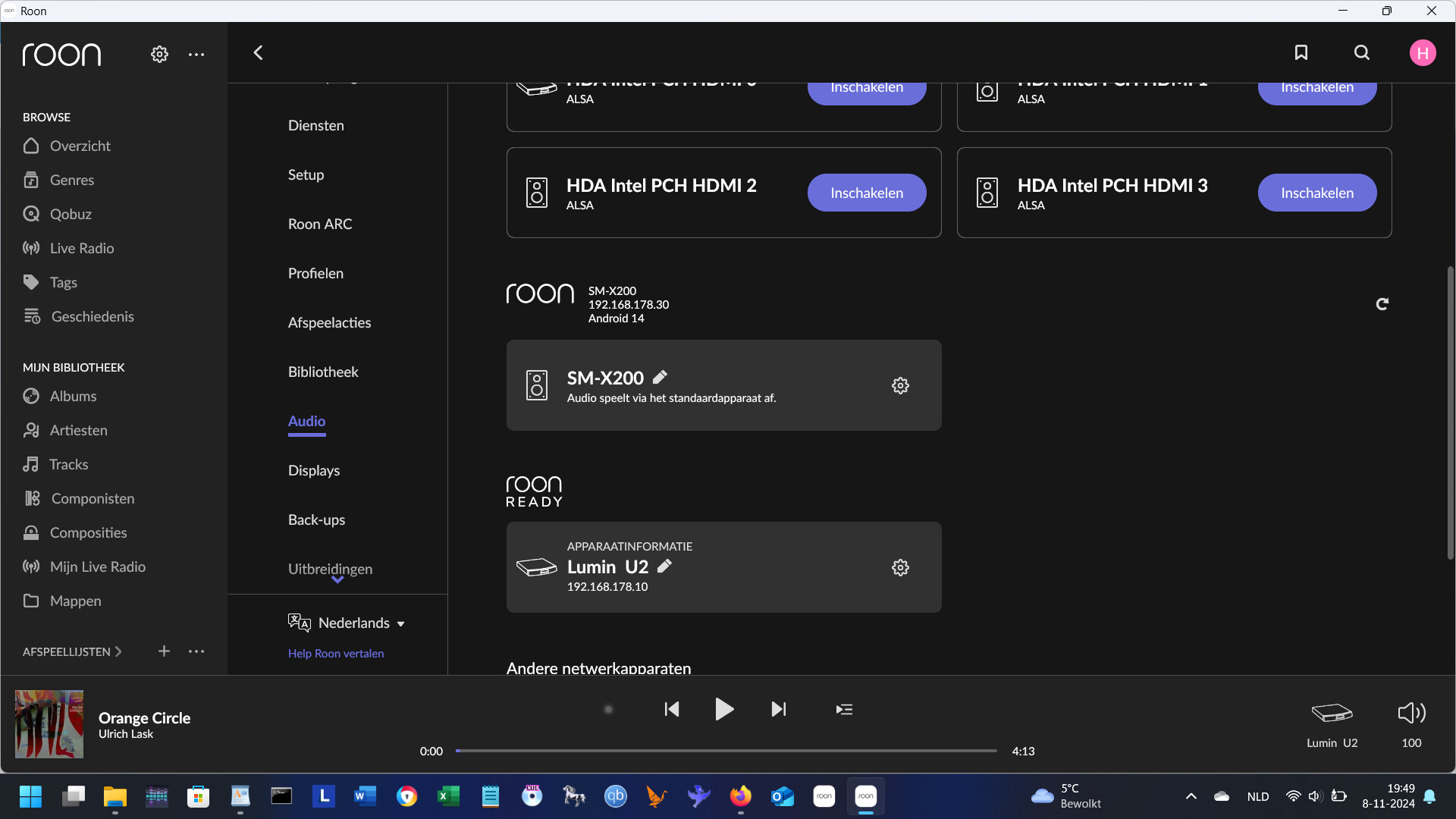

I installed a switch between my router and my NUC and Lumin streamer. On my network I can see all the software from Roon and my music on disk. If I click on the "STAR" next to the back-button, I don't see any strange things. Also I see the streamer and the DAC in the list.Also I can choose music files or playlists from disk or Qobuz. BUT: If I press PLAY the counter stays on zero and after a few seconds the player jumps to the next file. I already did reset my router and the other gear

Can you please share a screenshot of the device setup page for this Lumin Zone in Settings → Audio? Click on the gear icon :gear:.
