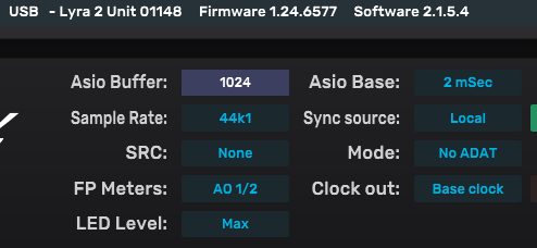

Using a Prismsound lyra2. As of the recent update to Roon, playback appears to fail at random and Roon skips tracks until it times out. The interface is connected via USB and their driver is installed and running. No prismsound drivers or firmware was updated prior to or after the Roon update. Previously the lyra2 would automatically switch sample rates if it differed from the previous track/current configuration. I suspect something in the new update broke interoperatibility with the Prismsound driver since using a singxer DDC to bypass the Prismsound driver works fine.

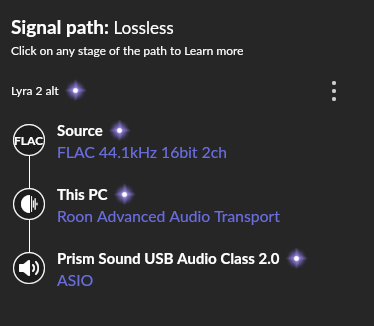

We need to clarify your setup a little. Please share a screenshot of the Signal Path in Roon for the configuration you’re using with this audio interface.

Here’s a screenshot of the signal path:
And the Prismsound software:
