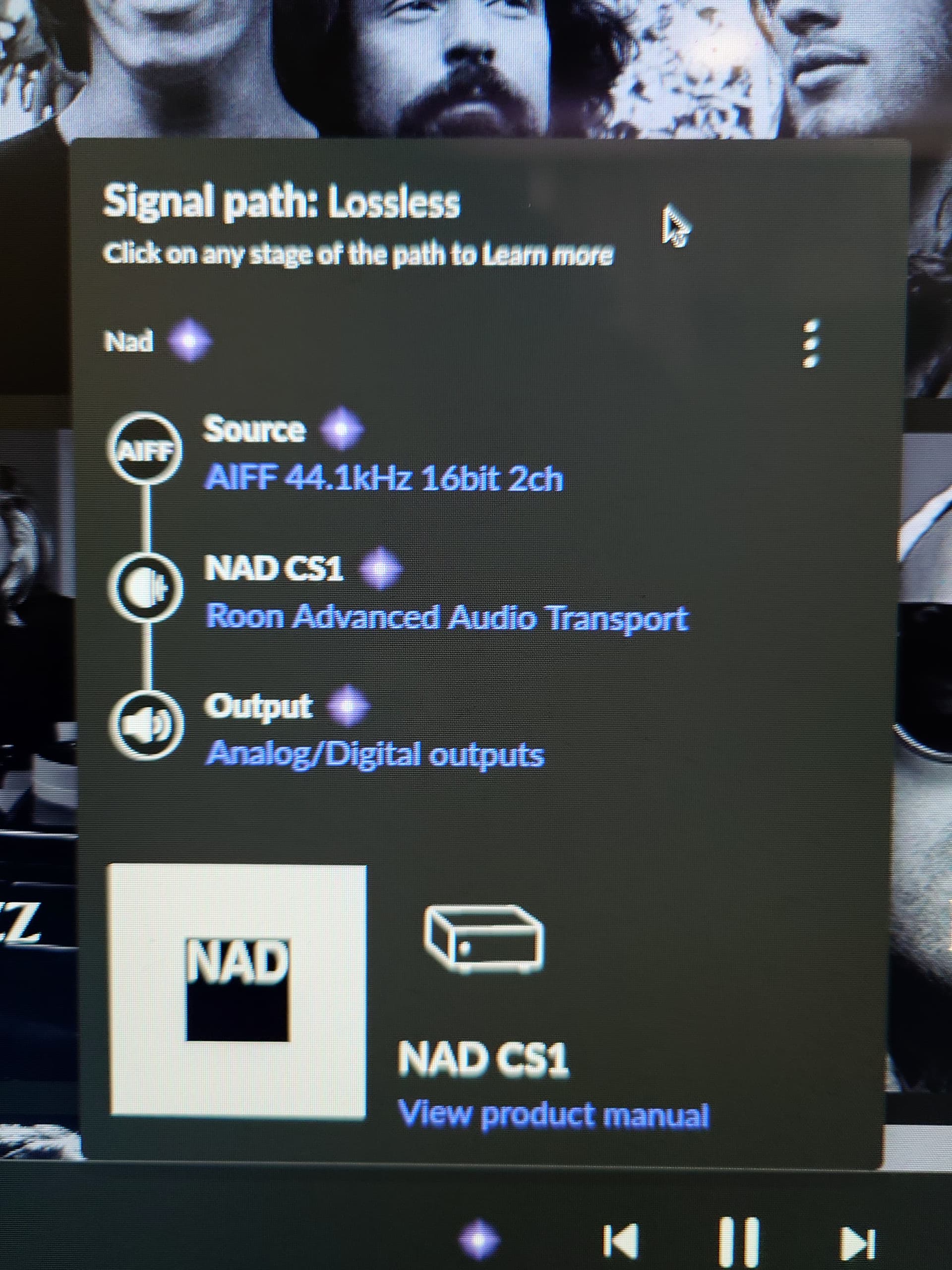

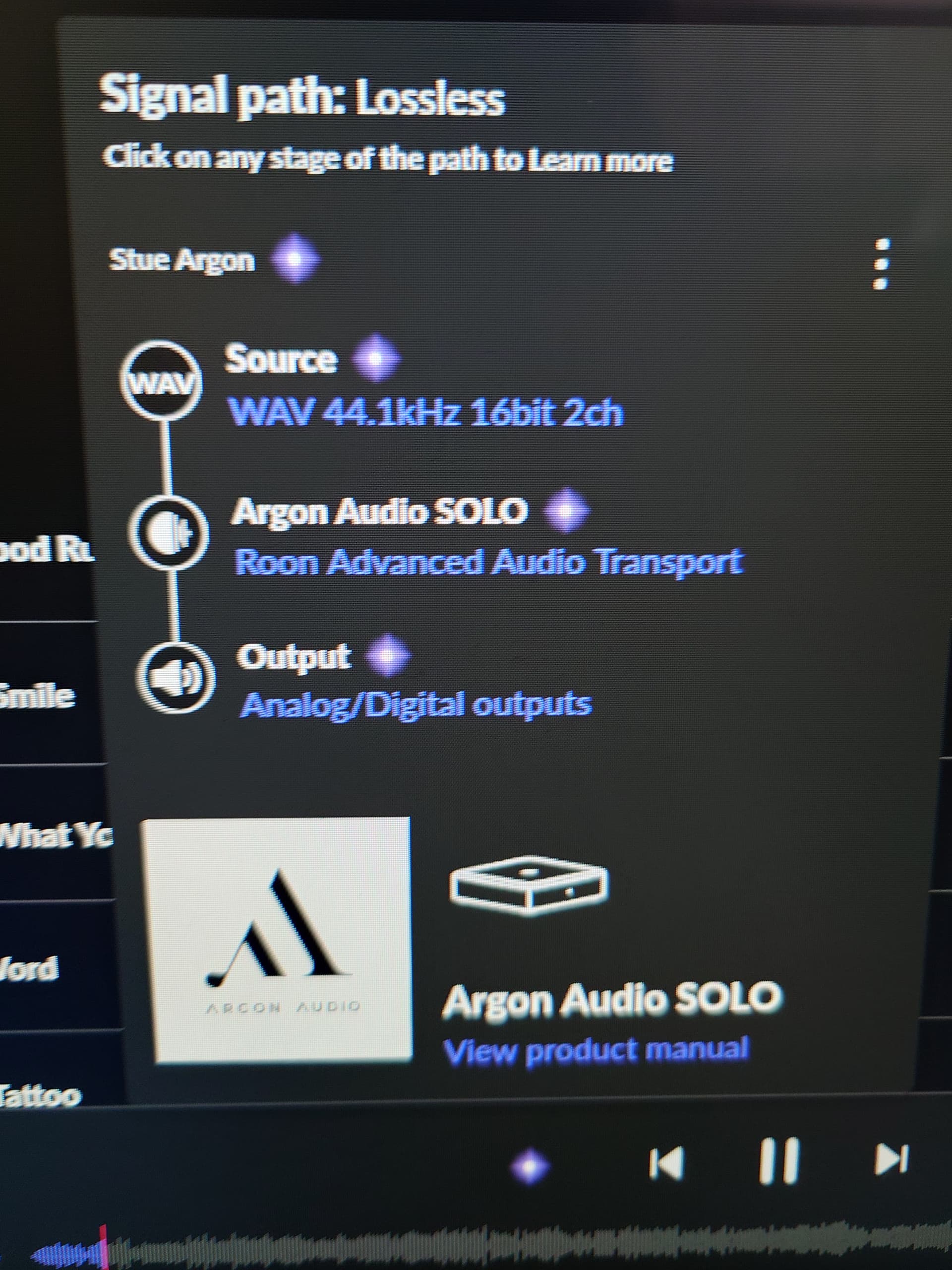

Hi @Jabbalabba,
Thanks for writing in to let us know about this issue. Please play to those streamers again and upload a screenshot of your signal path in Roon.
Hello Daniel,
Here’s the shots you requested

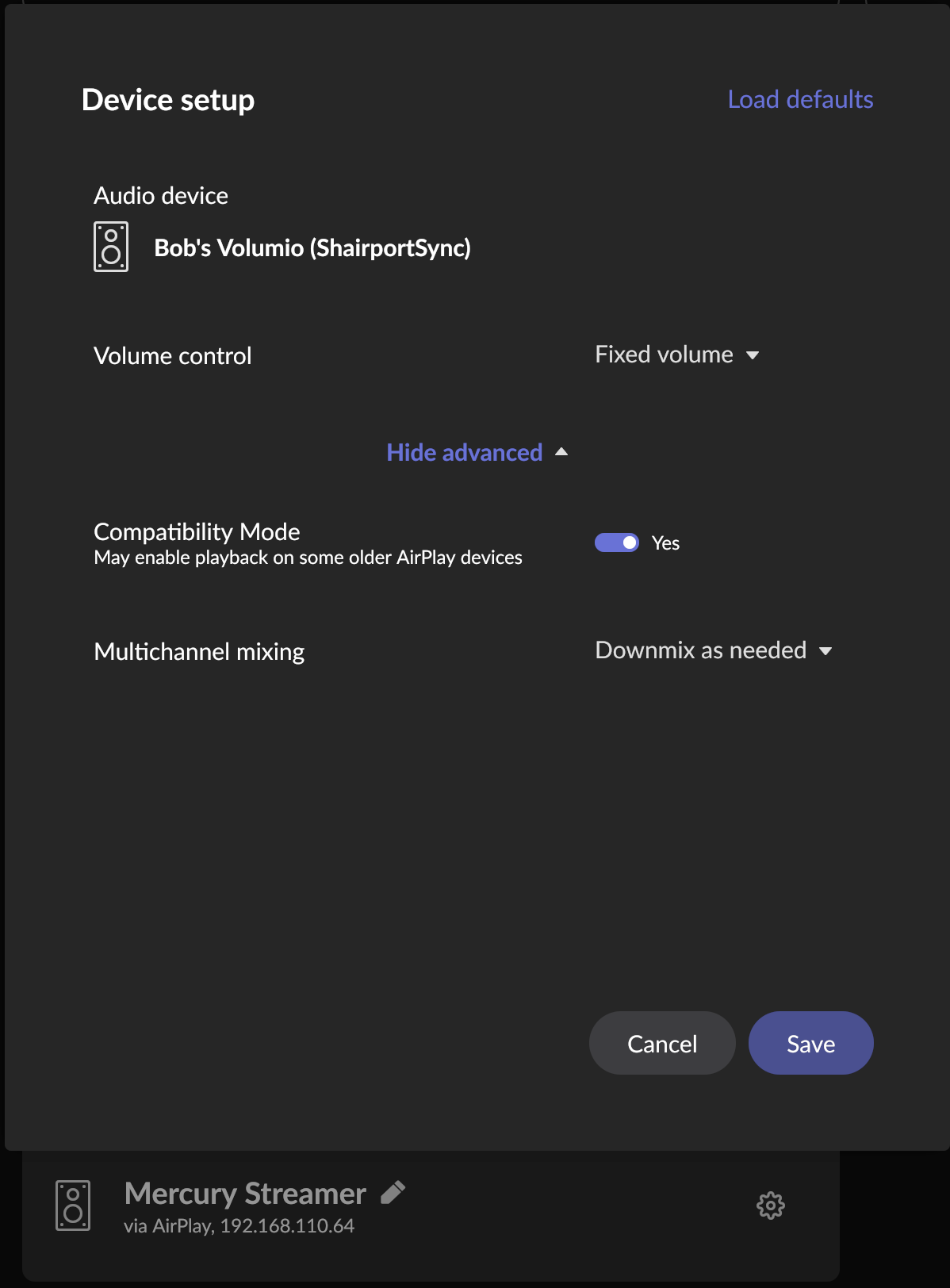

Hi…I, like you, would like to have a little more understanding about the Fixed vs. Variable settings “in Roon”.
After the software update, Roon was delivering a music file stream to my DAC (as my DAC clearly indicated this, but like you I had no sound when manually adjusting the volume knob on my amp/preamps). How could the signal be present but not responding to mechanical volume adjustment? (Because of the Compatibility Mode of AirPlay issue?)
My situation involved both the (new?) Compatibility Mode AirPlay (1 vs 2) switch AND the Variable vs. Fixed choices for Volume Control.
Changing The (new?) Compatibility Mode AirPlay switch to “Yes” (for older gear) and keeping my volume on “Fixed” facilitates music being audible and mechanically controlled on my system.
I now understand the Compatibility Mode AirPlay situation thanks to this forum, but want to understand what the terms/words “Fixed” and “Variable” Volume mean in The Roon Software.
Is “Fixed” in Roon a very low volume signal (gain?) in the Roon Software that I control manually on my device?
Is “Variable” for volume controlled with-in the Roon Software (which I do not use in my set-up).
I am just trying to grasp what the words “Fixed” and “Variable” practically refer to in the menu. I might be a slow learner. :grinning:
Thanks.

Hi! :grinning:
…no…I got your part! …that you had an issue on “your” device …but you (like a chiropractor cracking my back…AHHHHH!!), may have just helped me! I think I “get it” now.
In Device Set-Up (in the photo I attached), …
The Volume Control is for the Airplay Volume (not my devices volume?). I am using a Roon Browser on my MAC to control ROCK on my NUC Server. My Roon Core is not on my MAC it’s on my NUC (Roon Server). Is your Roon Core on your MAC? This may explain our different experiences.
Not sure, though.
:man_shrugging:t2:
