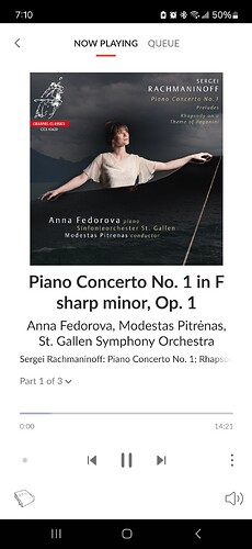

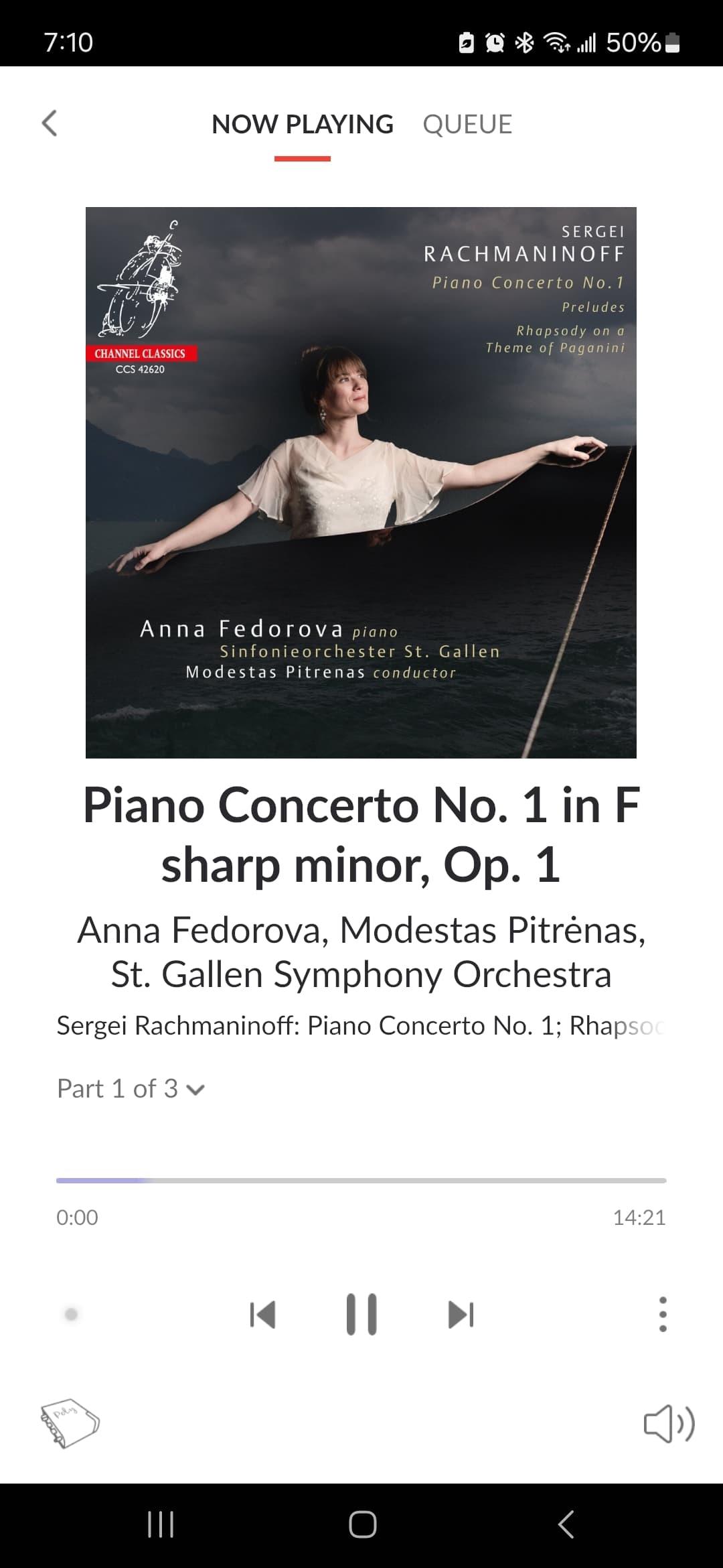

Roon plays for several minutes and then stops. When I go to the track it shows the timeline cycling back and forth. Other than the timeline cycling it appears Frozen. Other tracks won't play

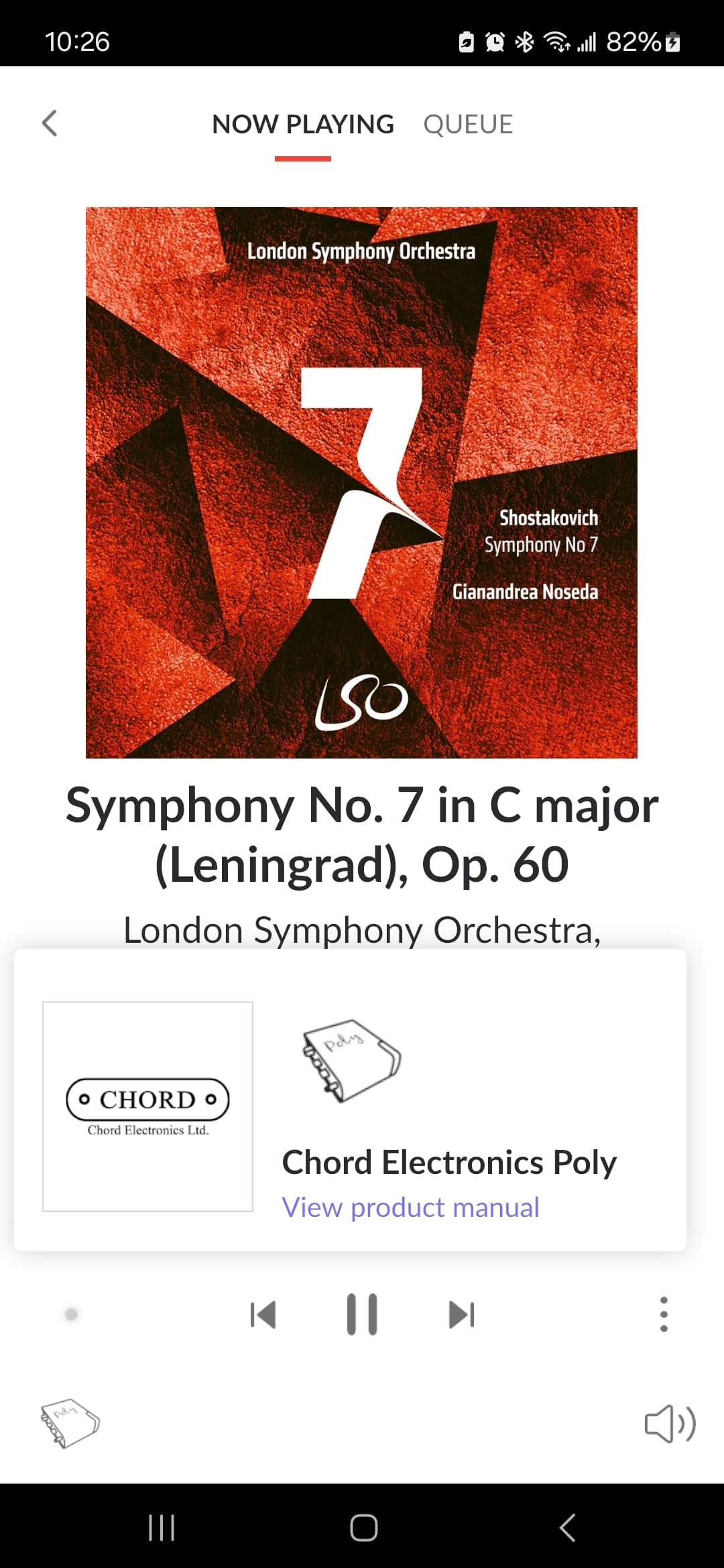

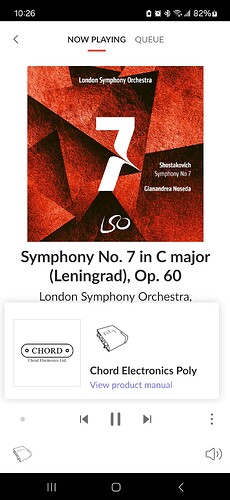

Here is a screenshot. The blue dash on the timeline cycles back and forth from beginning to end quickly.

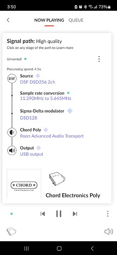

This is a screenshot of the path. It seems like somehow chord Poly isn’t finding the network. The only thing showing on the path is the court poly.

Rebooted the router. It did not help. Started “cycling” after about 5 minutes of playing properly. This is a screenshot of the audio path when it’s playing properly.

One thing odd that I noticed is you have an unnamed endpoint? I’ve observed strange behavior when that occurs you may wish to name it then restart the server
