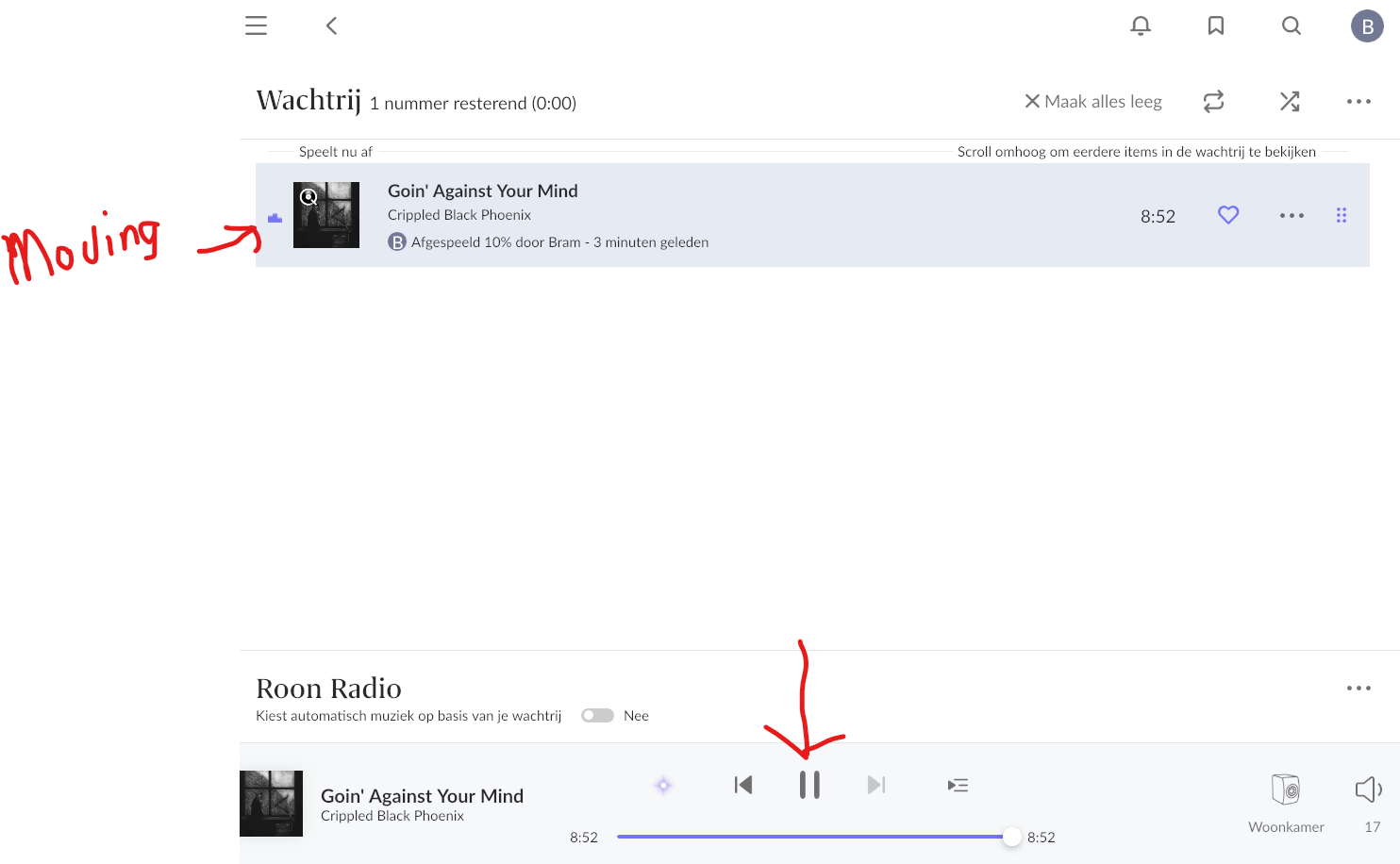

Playback stops just before finishing the last track of the qeueu. Instead of clearing the queue, the timer stops (most of the times) one or two seconds before the end of the track. It's not playing, but the play/pause button suggests that it is in fact still playing. If i dont pause manually, the NUC starts heating up and the fanspeed increases.

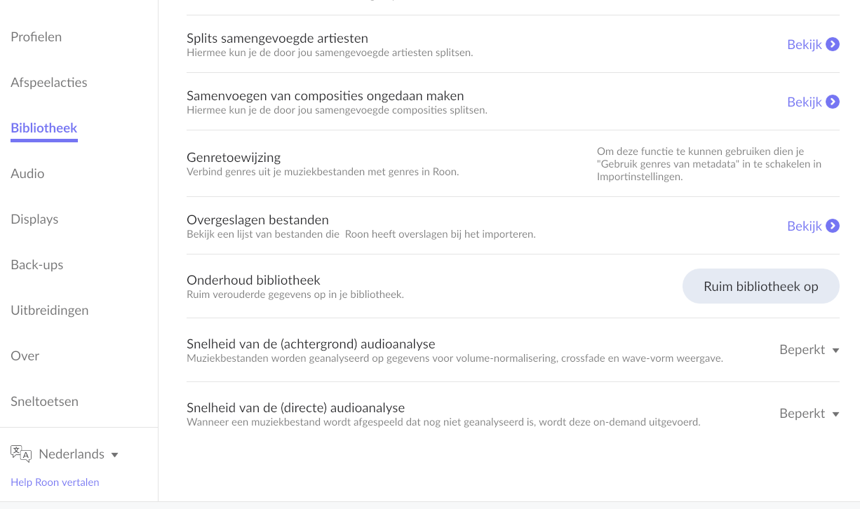

It does sound as if your music has not been analysed and it has to do this on demand as you play a track.

Music analysis is set as shown below. It’s in Dutch. I think the correct English term is ‘throttled’?
Also: when I play another song or when stop ROON Server via the rock.local interface, the fan immediately slows down.
