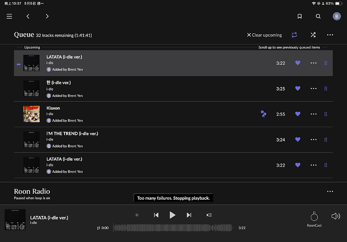

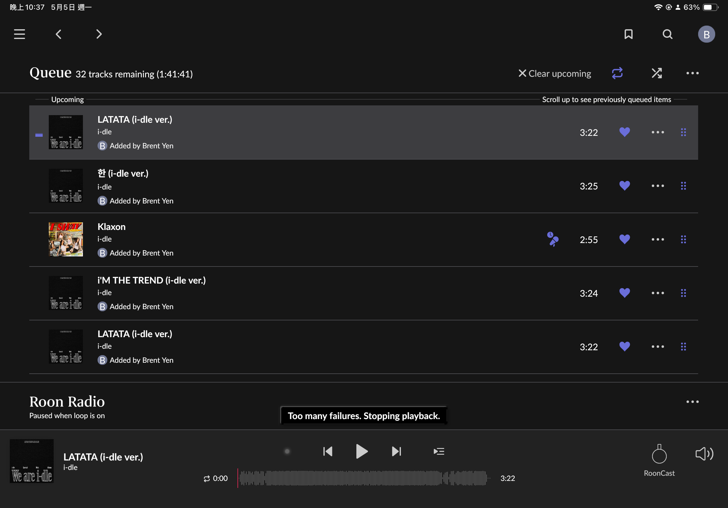

However, I have also tried to get hi res files, stored it in a NAS, built a playlist that contains both streaming songs and local file songs,
The play back will stop sometimes, and showing “too many failures, stopping playback”. I have noticed it was happening (mostly) when moving from a streaming song to a local file song. And it will skip 4 songs then shows the error message. But I have zero idea what causes the error.

Hi @POCHUN_YEN,
Thanks for the update and sorry to hear your issues persist. From a recent diagnostic report, we see the following error when playback is attempted:
Error: [cast/client] [CastRoonApplicationChannel] Media error: { "sourceId": "18554d99-e5ee-4423-928a-69ebe0ada2cd", "destinationId": "sender-83709", "namespace": "urn:x-cast:com.google.cast.media", "payloadUtf8": "{\"type\":\"INVALID_REQUEST\",\"reason\":\"INVALID_MEDIA_SESSION_ID\",\"requestId\":299513}" }
