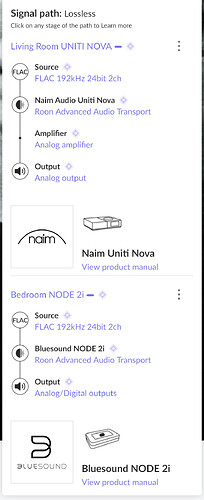

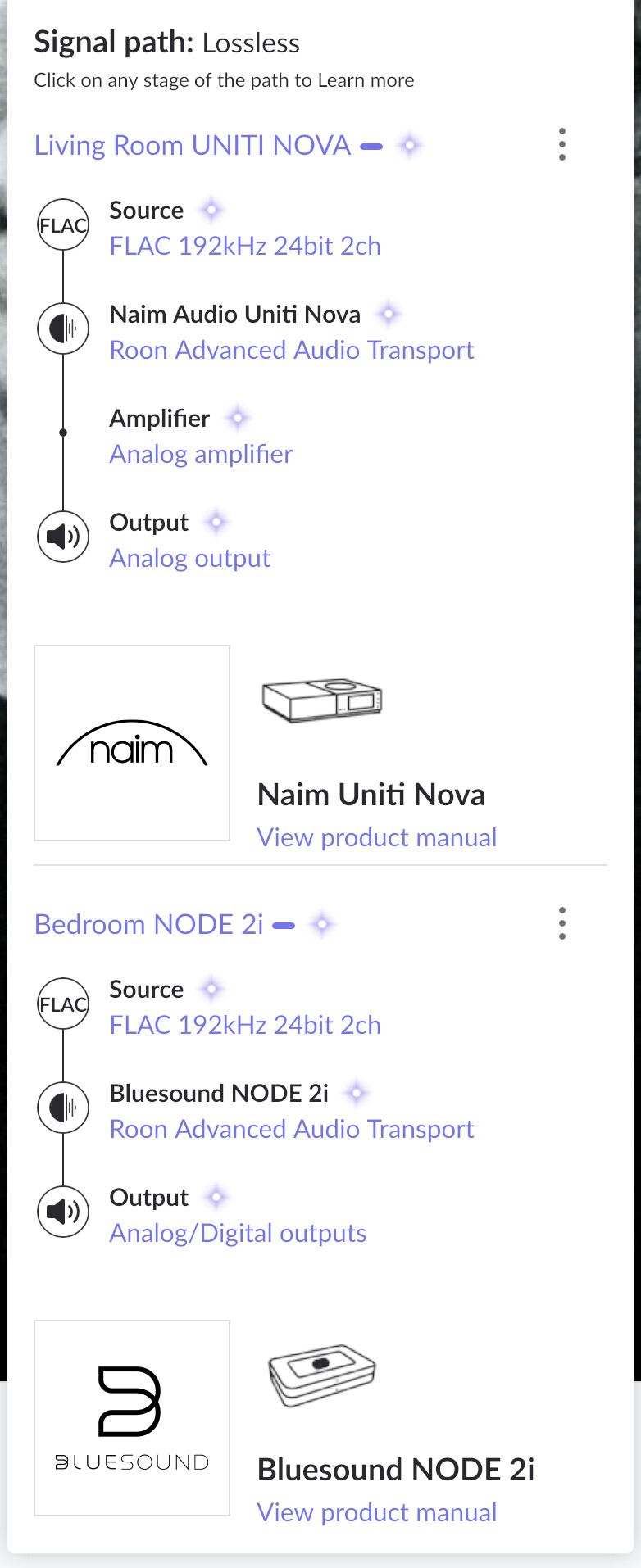

Please post screenshots of Roon’s Signal Path when playing to the Nova and to the Node.
Plus, your wifi router’s admin page should show the wifi band (2.4 vs. 5 GHz) and the bandwidth for the Nova and the Node. They might be on different bands and/or achieve different bandwidth. You didn’t say if they are in the same spot, so it may cause a difference if they are not, or the respective wifi implementations in the two devices may achieve different results in your particular setup, even if if they are close to each other - wifi is somewhat unpredictable.
I’ve got an Atom and nodes and all of them work wirelessly on high res tracks. I would look to your network. Roon, for better or worse, is really fussy about WiFi and will glitch if it is less than ideal.
I’ve flooded my house with mesh nodes to overkill the issue.
OK so no difference there, meaning that the difference is in the wifi connection
