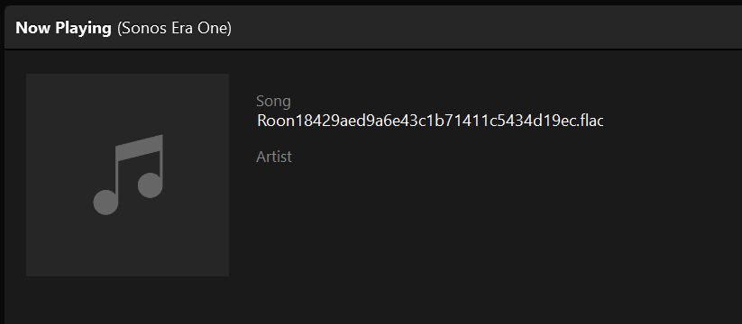

· When I use Roon to play tracks from my server (Synology NAS 3018xs) and use a Sonos Era One as the audio device it shows as playing but no sound on the Sonos. If I open the Sonos app it shows a .flac file is trying to play but the encoding is not correct.

BTW the randomly named FLAC file appearing in the Sonos controller is normal. It’s just a container for the stream.
