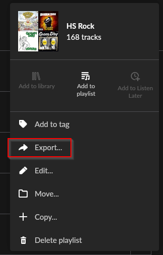

If you navigate to the playlist you want to export and click the three dot menu there is an export to CSV option. Are you able to see that option?
I can see it but it’s no better than trying to export to excel…just keeps running with the “Saving…” pop up animation on the screen. If it helps, I just tried it again, starting at 07:29 NZ time on 8 April.

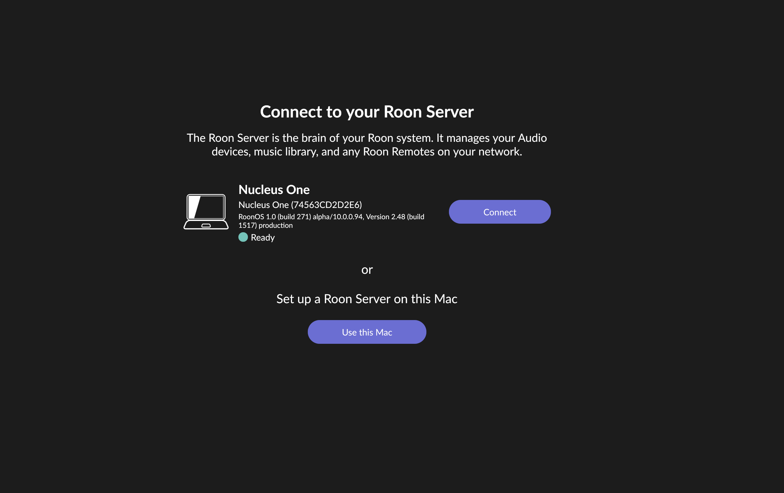

Roon creates a RoonServer instance if you’ve enabled RoonServer on that machine at any point - this is a step taken in the Roon application when you first sign in and select a server. For instance, “use this Mac” below will automatically create a RoonServer folder on my MacOS machine and then start RoonServer as a background process. I can log out of that RoonServer and sign back into my Nucleus, but RoonServer will remain installed on this machine.
To uninstall RoonServer itself and just keep Roon, you’ll need to locate and delete the RoonServer folder itself on your Windows laptop. Make sure you have a Backup of your Roon library since you may be encountering issues with hardware on the ROCK. Use these steps to *navigate to your RoonServer’s Database Location and then delete the “RoonServer” folder - don’t delete the “Roon” folder, as that contains the stand-alone GUI, regular Roon (Roon Remote).
