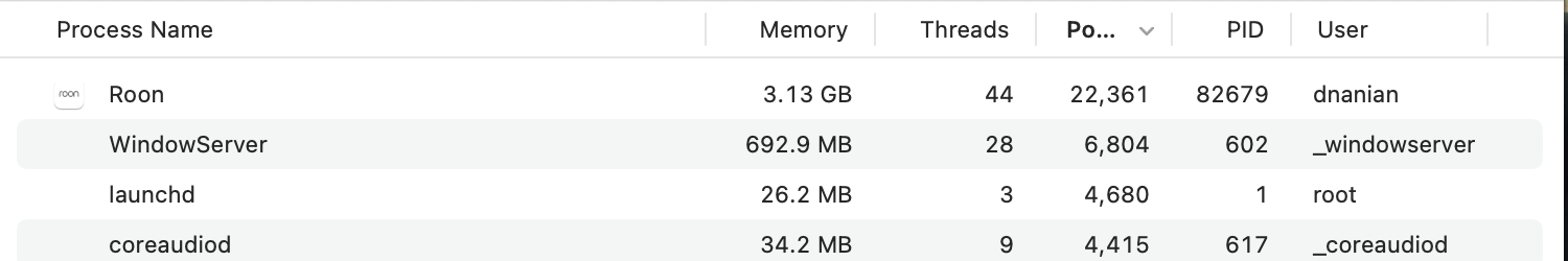

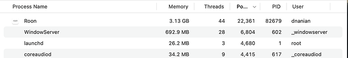

Note, BTW, that the app also leaks ports like crazy. After about 12 hours, here’s what it looks like. This is sorted by number of open ports…nothing else comes close (and it gets worse and worse over time). This isn’t RoonAppliance - this is just Roon, running on a MacBook Pro.

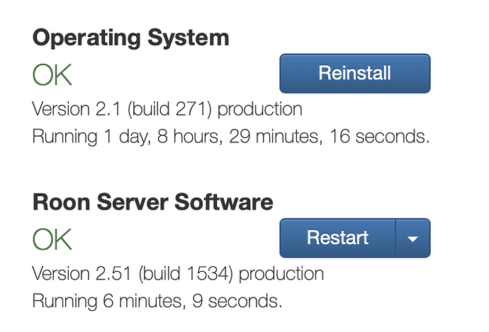

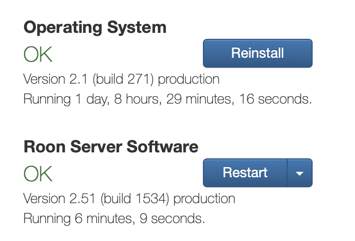

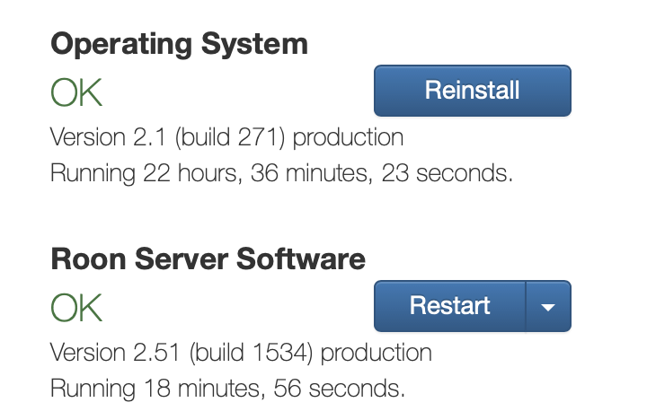

So, I don’t know if it has crashed at other times overnight, but checking it this morning, it has clearly crashed within the last 20 minutes, despite not being in use at all. See stats:

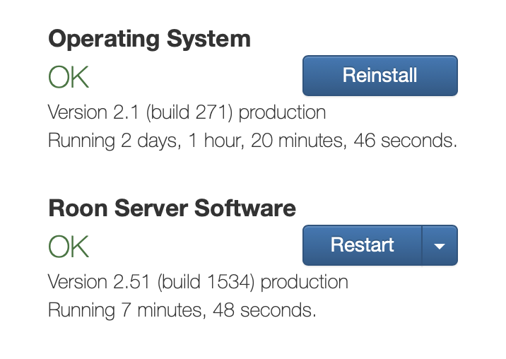

And I just opened Roon again to do something and it crashed, again, four minutes ago:

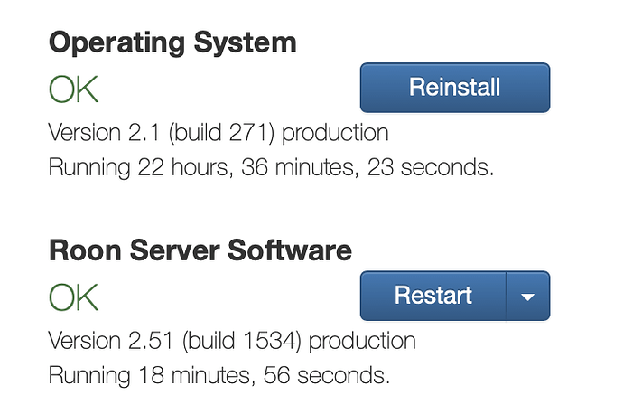

And it has crashed yet again, idle.

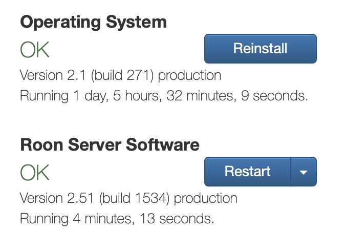

And, when I just went to try to play something, it was starting up after having crashed 7 minutes ago:
