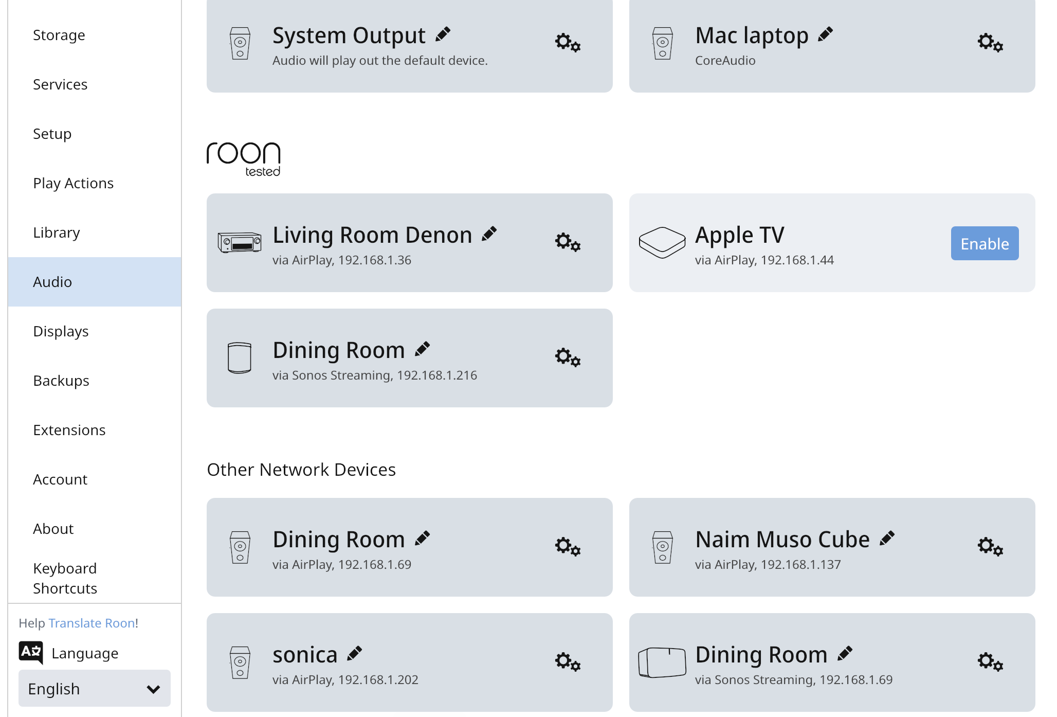

Not 100% sure if this is what you mean but here is settings/audio:
Your Mac core doesn’t appear to be seeing the usb connection to the sonica dac, which on the Mac will only support up to dsd256 but it should work. Instead of a usb-c to b cable try a usb a-c cable and a usb c to a adapter
I can try this tomorrow with my sonica dac and my 2018mbp but it’s 1:25am here now
The sonica you are showing in other roon devices is the networked airplay instance…it’s going to sound horrid

It doesn’t look like the USB input for the Oppo is showing up under “Connected to Core”. It’s possible that its an issue with the USB connection, but I would check to see if you have any firewalls or Antivirus active that might be blocking Roon, this could also be a reason why the DAC does not show up with the native driver.
You can use these instructions from Apple to add Roon and RAATServer as exceptions to the native Mac Firewall, and I would try temporarily disabling any other Antivirus or Firewall software you may have (McAFee/Kaspersky/Bullguard/Little Snitch/ect.) as a test to see if the “Connected to Core” field populates with the Oppo.
thanks very much @noris - adding roon to the firewall and disabling the antivirus software seemed to work - as the following then showed up under the Sonica when the cable was connected (nothing wrong with the cable, as I initially suspected):
