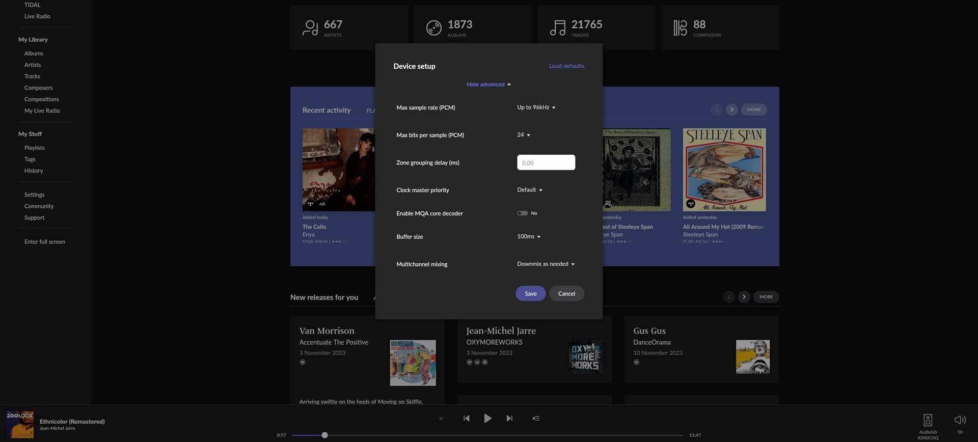

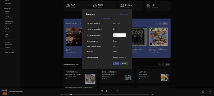

I’m hearing brief stutters or pops every 20 seconds or so. I’ve tried multiple setting changes, including removing all DSP, loudness controls and resampling instructions without eliminating the problem. Have also experimented with various buffers sizes, and added a powered USB hub between the NUC and the DAC. Problem still there.
