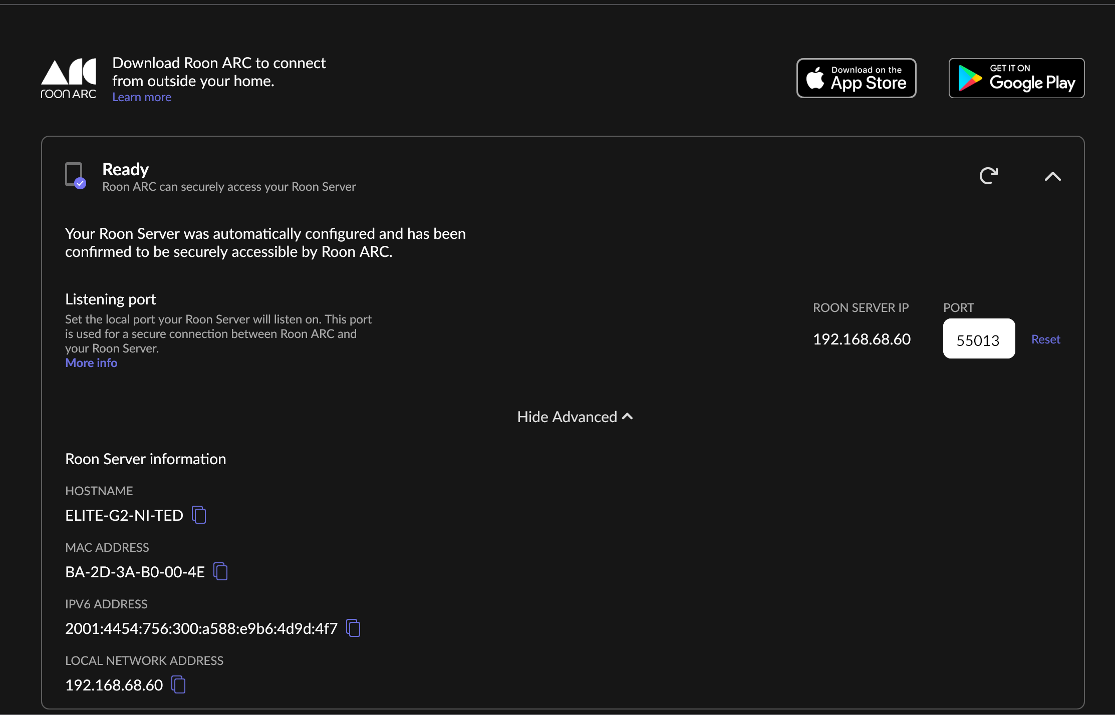

As mentioned above, are there any specific error codes displayed in the Roon Settings → Roon ARC tab? If so, can you post the error here?
Do you have an IPv6 pinhole configured in your router to allow ipv6 TCP connections to your Roon Server (at the ipv6 address shown in the Roon ARC settings page) on port 55013?
If so, this will be enough for ‘Ready’ to be reported on the Roon ARC Settings page that you posted a screen shot to above.
An ipv6 firewall pinhole will be good enough for remote ARC clients to connect using IPv6 - but if the remote is connecting by an IPv4 only service, then the working IPv6 connectivity will not be any good to you.
Incidentally, the IPv6 ip address of your Roon Server that is visible in the screenshot is a public ipv6 address and should probably not be shared online.
If you disable the exception in the IPv6 firewall, you may see some diagnostic text which will give more clues as to what might be going wrong.
However, looking around on the internet, it appears that PLDT PHILIPPINES use CG-NAT. If that is the case you will not be able to get IPv4 connectivity working unless you can get PLDT to give you a public routable (possibly static) ip address.

It makes perfect sense that the port forwarding options are not available on the Tp-Link router once it has been put into Access Point mode. This mode disables the network address translation (NAT) and DHCP services on the router so that it turns into a switch and media bridge (connecting the Wifi network to the Wired network) and thus there is no NAT layer to forward across.
The good news is that, now you only have one subnet - 192.168.1.0/24.
The fact that the ARC settings page in the ordinary Roon client is now reporting ‘Ready’ suggests that uPnP on your ISP router has successfully opened port 55002 as used by the Roon Server to support ARC.

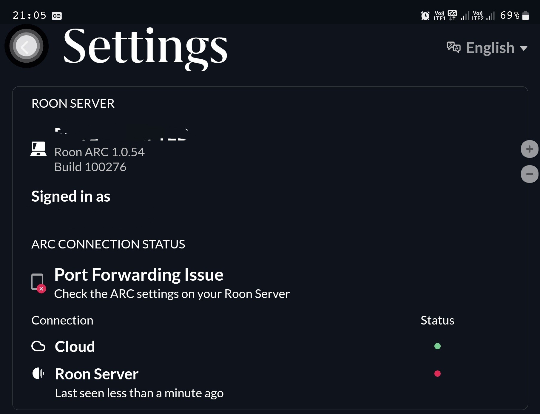

unfortunately, disconnecting and reconnecting did not solve the issue.
the roon ARC app is still displaying the error message “PORT FORWARDING ISSUE (check the ARC settings on your roon server).”

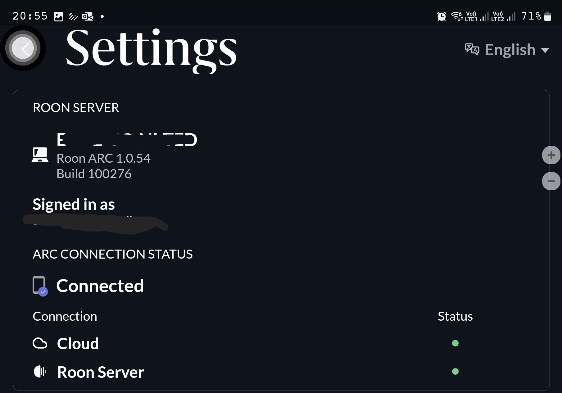

will revert back from access point to router mode and check out tailscale. thank you.
Hello Wade!
tailscale works! installed it on all devices with roon ARC, and in an instant, everything worked seamlessly.
thank you for all the help and advice!
