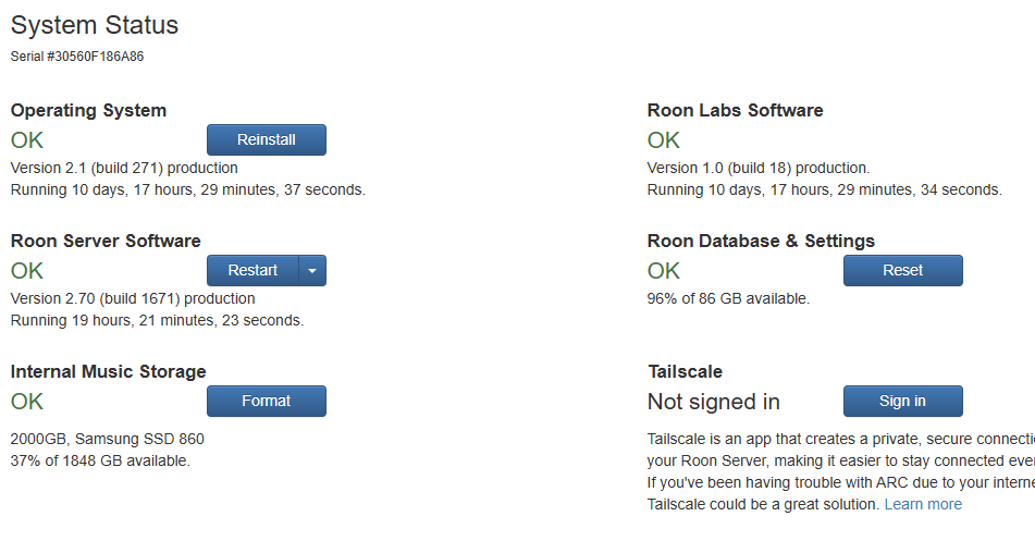

Ever since I purchased a replacement for my NUC (I went with Nucleus One) I have been having multiple problems. 1. ARC fails to download. 2. Roon is slow (takes a while to find server, takes a while to add files, regularly stops playing music mid-way through a song, says it is having issues. It was difficult to fill out your forms for this chat because it asks very specific questions but does not allow multi-select. Truth is, I am having issues with majority of items on your list. Of course I truly do not know what the problem is, but a simple view: I use NUC, everything works great. I replace with Nucleus, everything starts behaving poorly. I also want ARC to work in the worse possible, way, but it SUCKS. Sorry, but I have reported - you have done updates - it is a great idea, but it does not work (but that is another ticket I suppose). Basically, I am having buyers remorse. I pay for lifetime + Nucleus - your branding implies high quality, but gives nothing bus problems. Please help me troubleshoot this and/or refund purchase.
typical home setup.
