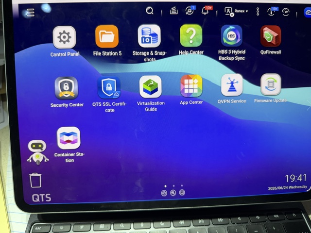

  4. I was unable to find the YAML despite a diligent search. However, I did find information that includes the line “network_mode: host” about which Connor asked.
services:
roonserver:
image: Package roonserver · GitHub
container_name: roonserver
network_mode: host
environment:
  • ROON_INSTALL_BRANCH=production
  • TZ=America/Los_Angeles
    volumes:
  • /share/Container/roon:/Roon
  • /share/Music:/Music
  • /share/Container/roon-backups:/RoonBackups
    restart: unless-stopped
    logging:
    driver: local

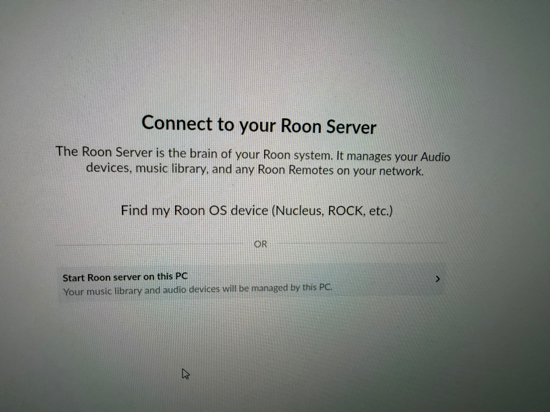

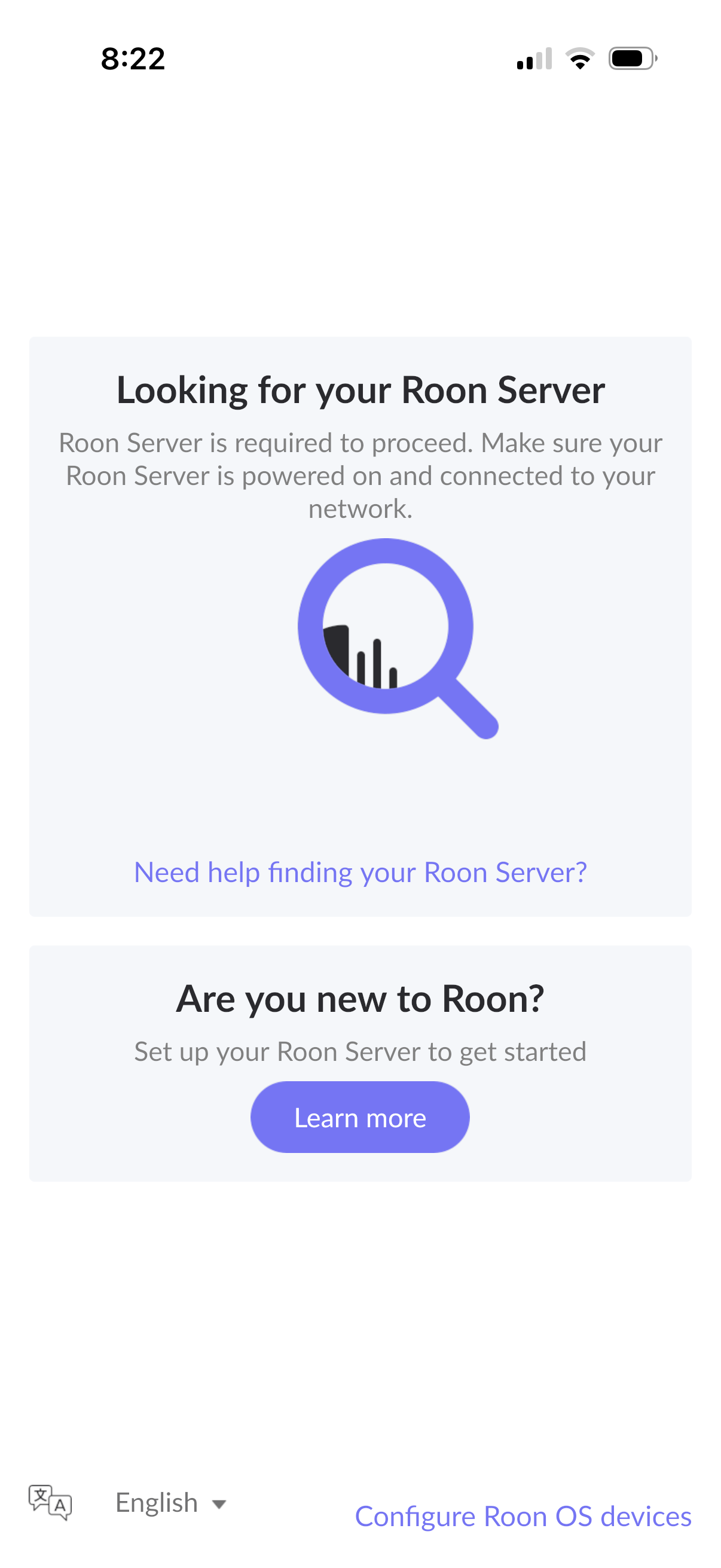

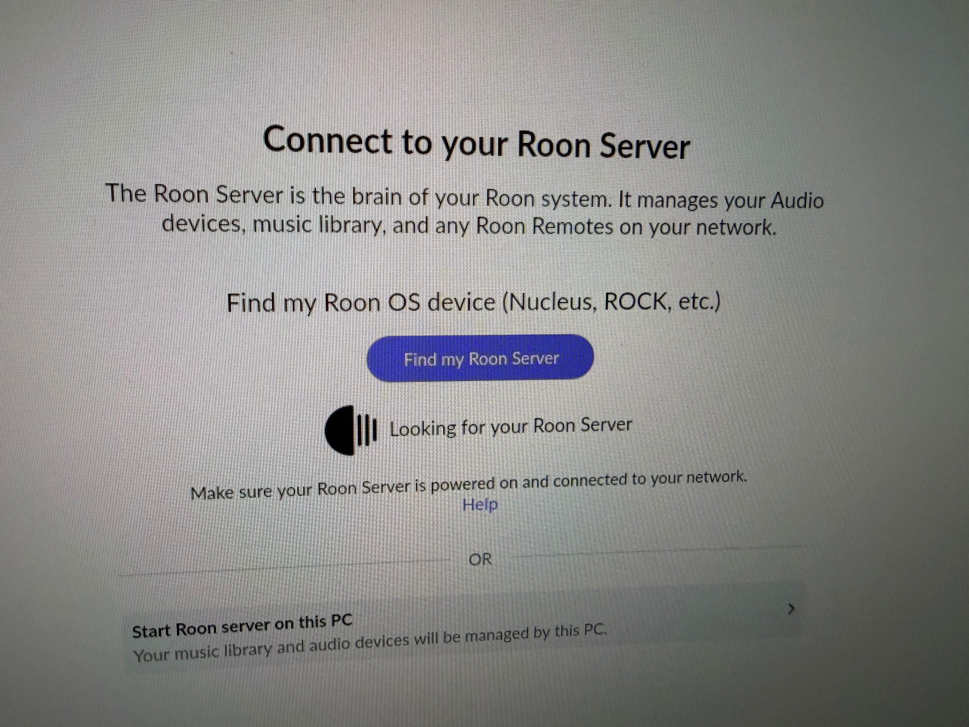

Let’s try something. On the Windows machine, when you encounter the “looking for your Roon Server” screen, please follow the prompts to try to setup a fresh Roon Server instance on that computer.
What do you see? Please share a screenshot here. We’ll watch for your reply.

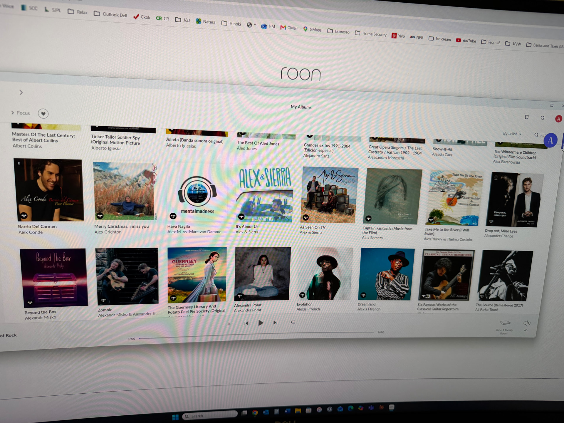

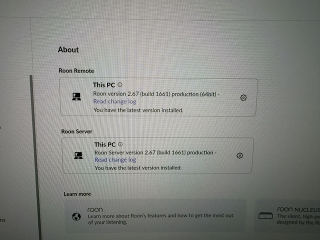

Hi Connor, Thank you for your note. Before following the prompts to try to setup a fresh Roon Server on my Windows 11 PC, I followed Vadim’s recommendation of 5/12 and uninstalled Roon and its settings and database files on my PC. I downloaded a new installer to re-install Roon. Here are the screenshots.
Thank you.
Hi @Alan_C,
Thanks for the reply! It looks like you’ve been able to successfully set up Roon Server on your PC without issue, which is a helpful data point.
Did this have any effect on connecting to your NAS? Or, were you still unable to connect?

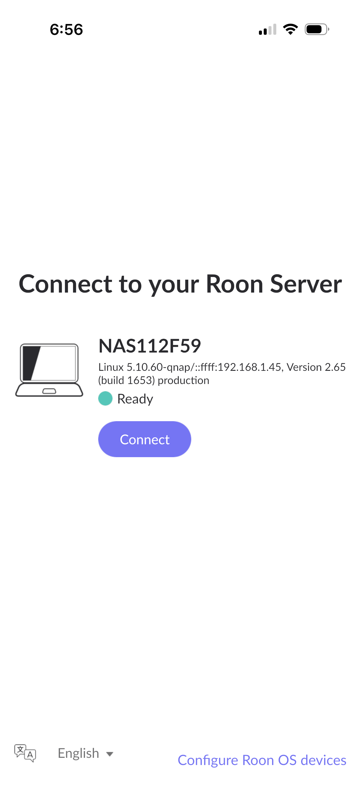

Hi, Benjamin,
Thank you for your note. Unfortunately I am still unable to connect to Roon on my NAS from my iPad.

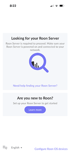

Can you please share two screenshots to help fully illuminate the current status from our side?

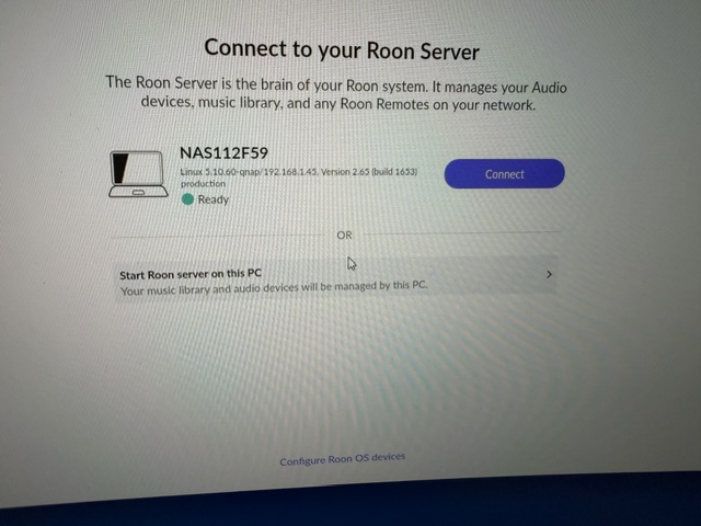

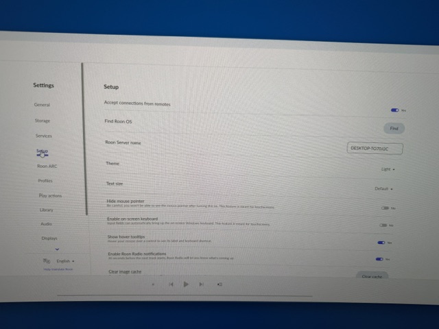

  1. You mentioned that you’re able to now connect to the QNAP itself from your iPad and PC. What do you see when you connect there?
  2. What do you see in Roon on the PC when you disconnect from the current server in Settings → Disconnect?

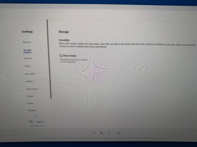

  3. Your screenshot from June 11 showed a screen from the Windows server itself, post-login. What specifically do you see when you try to log in to Roon on your PC? Can you share a screenshot from the app itself?
We’ll proceed urgently from there. Thank you!
Hi Connor,
Thank you for your note. Please find my answers below.

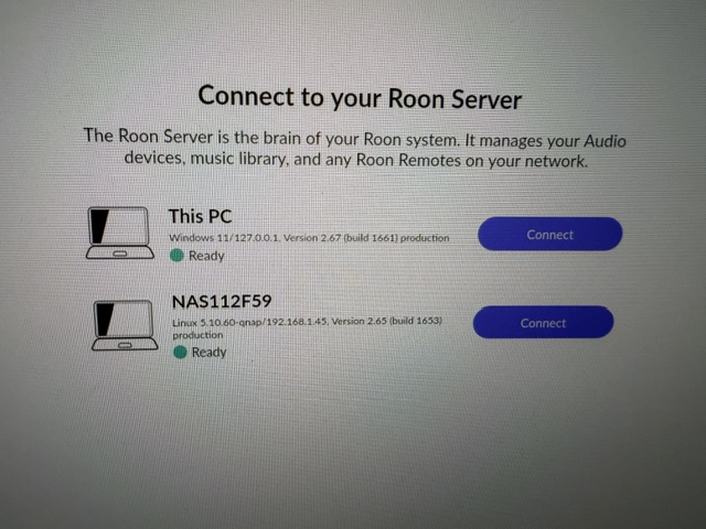

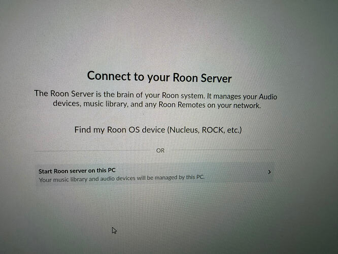

  1. To clarify, I have had no trouble logging into QNAP from my iPad or PC either before or during this issue. I see the QNAP GUI as shown in the leftmost photo.
  2. Please see the middle photo below regarding what I see when I disconnect on my PC. The PC and QNAP NAS are both shown as ready.
  3. I’m not sure if I understand what you are asking. If I select “connect” on the screen in the second photo, regardless of whether I choose “This PC” or “NAS112F59,” I see the symbol of a connection attempt shown in the rightmost photo.

What do you see if you:
  1. turn off the QNAP Container running Roon Server (or power the down the QNAP entirely) and then
  2. navigate to the “Connect to your Roon Server” page on your PC from the middle screenshot you shared above and then
  3. attempt to connect to the PC itself?
This sounds circular, but we’re gathering diagnostic logs on the backend to identify the precise machine allocation failure and/or any login authorization failures. This should help us (finally) resolve this problem.
Thanks for your patience.

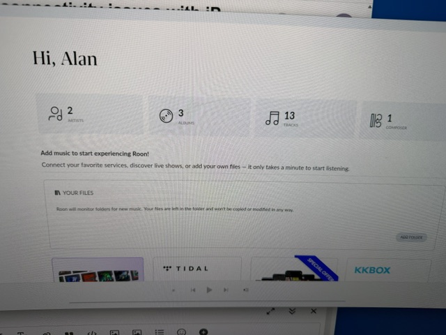

Hi Connor,
You
are correct that I was able to connect the PC and use the Roon. Of course, I didn’t connect to the QNAP NAS so I didn’t have access to the music and playlists I had stored there. I did have access to Tidal and my speakers.
In response to your numbered questions, please see the pictures above and my responses below.
  1. I powered down the QNAP entirely
  2. I navigated to the "Connect to your Roon Server: page on my PC
  3. I connected to the PC itself. As previously, I had access to Tidal and my speakers.
Thank you!
