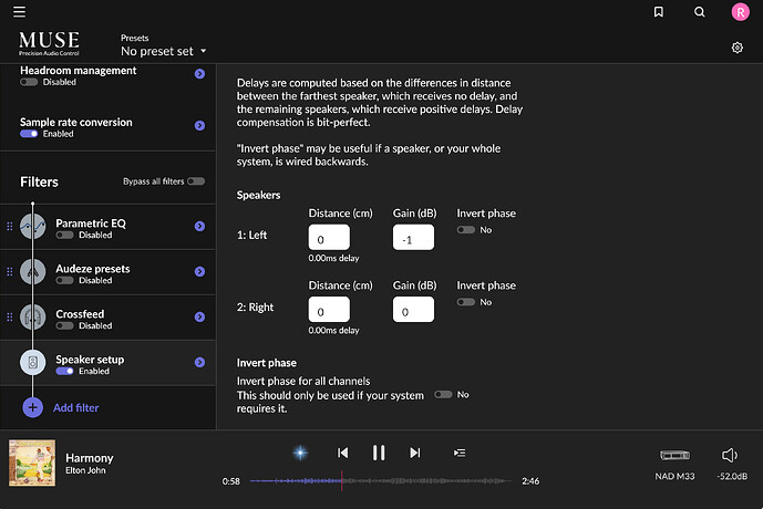

If the Wiim pro doesn’t have a lip sync delay available it would seem difficult to get them to sync up. Now Roon has a speaker setup function in muse/DSP that can set a delay based on speaker distance, not at all sure how far this can be pushed out though. Might as well give it a go nothing to lose.
Thanks - wasn’t aware of that particular setting (Muse). WiiM Pro does have a ‘Sync Audio’ setting (Auto or Manual), but I can’t quite get it precise (I may be using it wrong). And of course Sonos has its own ‘Audio Delay’ setting as well. I’m not seeing a similar setting for the Echo Studio speaker.
