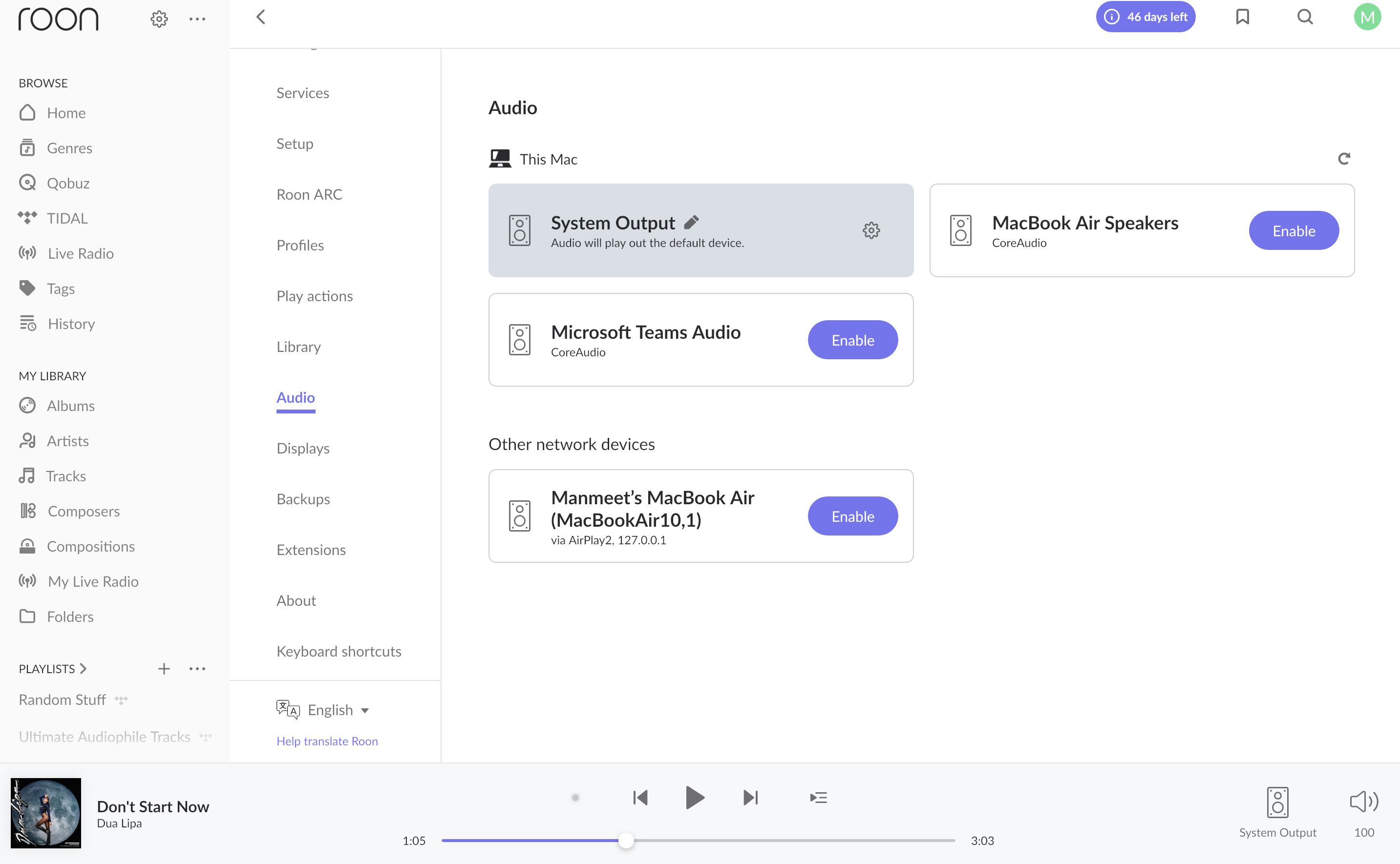

My MacBook Air is currently my Roon Core, and my streamer (Primare NP5 MK2) is hard-wired to the network. I previously set it up with Roon and it was working. This morning I noticed it’s no longer listed, along with all Chromecast enabled devices. They are all missing as output devices from Roon.

Welcome to the forum! As @Suedkiez 's linked thread mentions, please check macOS System Settings > Privacy & Security > Local Network, and make sure Roon is allowed. If you have verified this, please also try to perform a full restart of your Roon Server and ensure that there are no firewalls which could be blocking Roon from communicating with other devices on the network.
