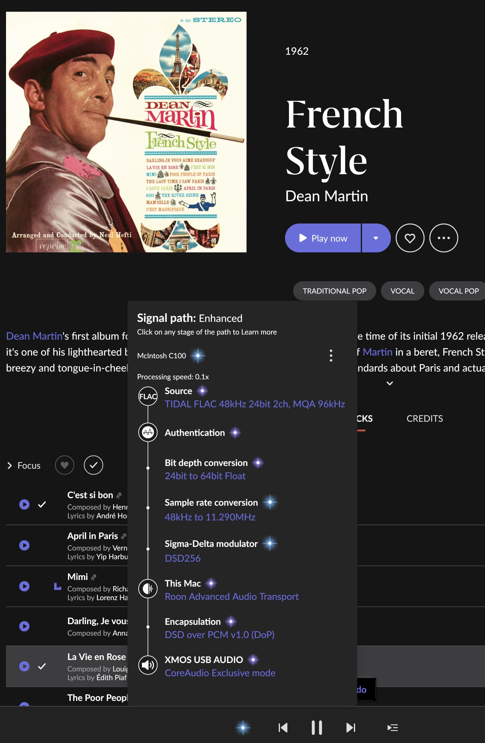

First order of business, your system for whatever reason is far too slow for the Signal path that you have depicted. Processing speed: 0.1x is not even remotely fast enough, and that could be causing glitches.

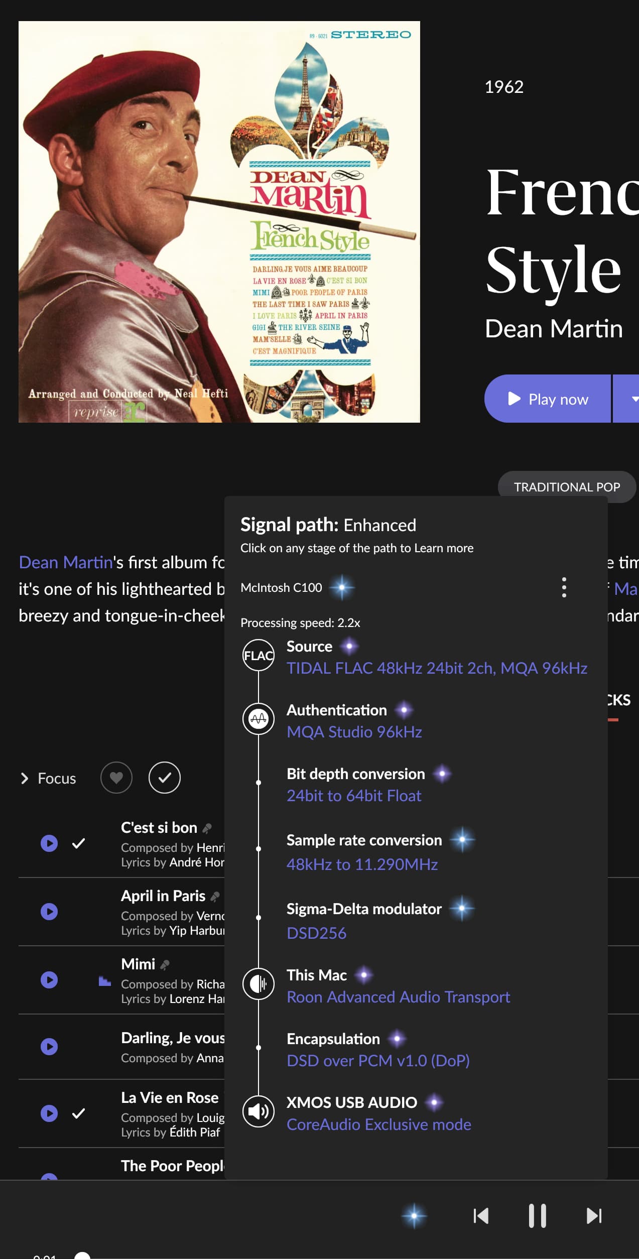

Hi AJ - Thanks for the reply. Gosh I just saw the screen shot and its incorrect I must have captured it right at the beginning of the play as it was buffering. See the new one. I captured it just at the steam started. It can process at 2.2x times just fine. So that is not an issue
