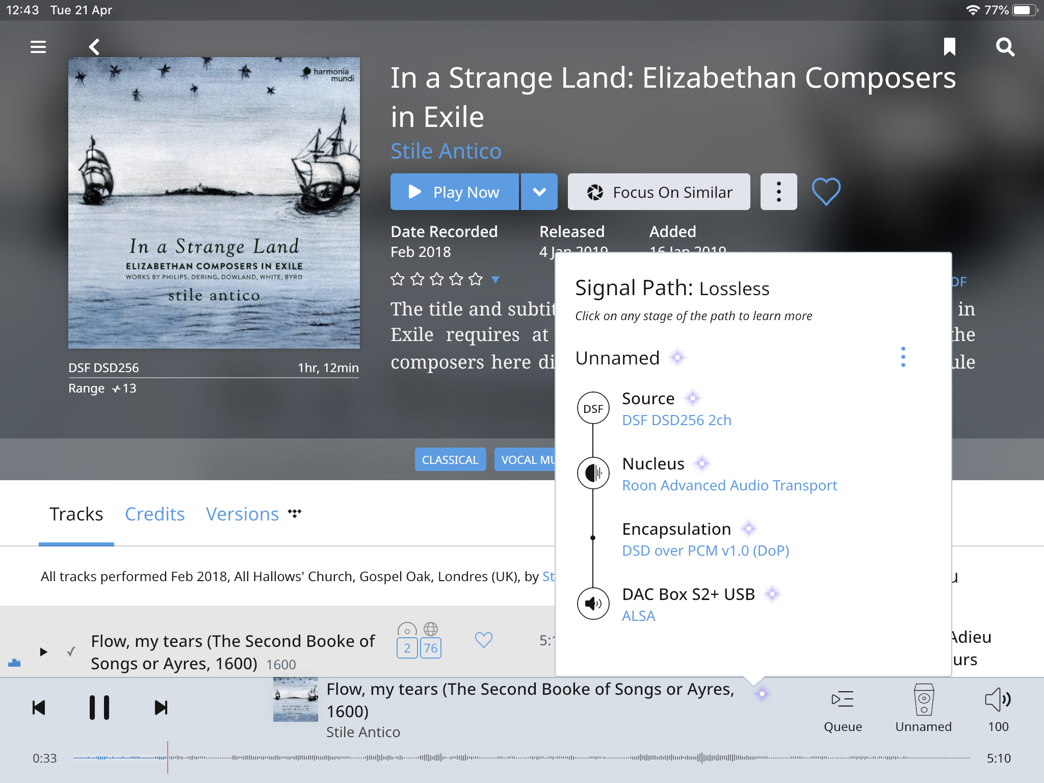

Just plugged the Pro-Ject DAC Box S2+ directly into the Nucleus and it’s able to play DSD256 DoP. DSD512 DoP not possible as that exceeds the maximum PCM rate of the DAC for encapsulation. I’m not bothered about 512 though.
So it seems the issue is with the Pro-Ject Stream Box S2 Ultra, not the DAC or Roon. I wonder if the streamer won’t play DSD256 because I’m running it wireless? I’ve seen that some streamers eg. Lindemann Limetree Network restrict their maximum sample rates when going wireless.

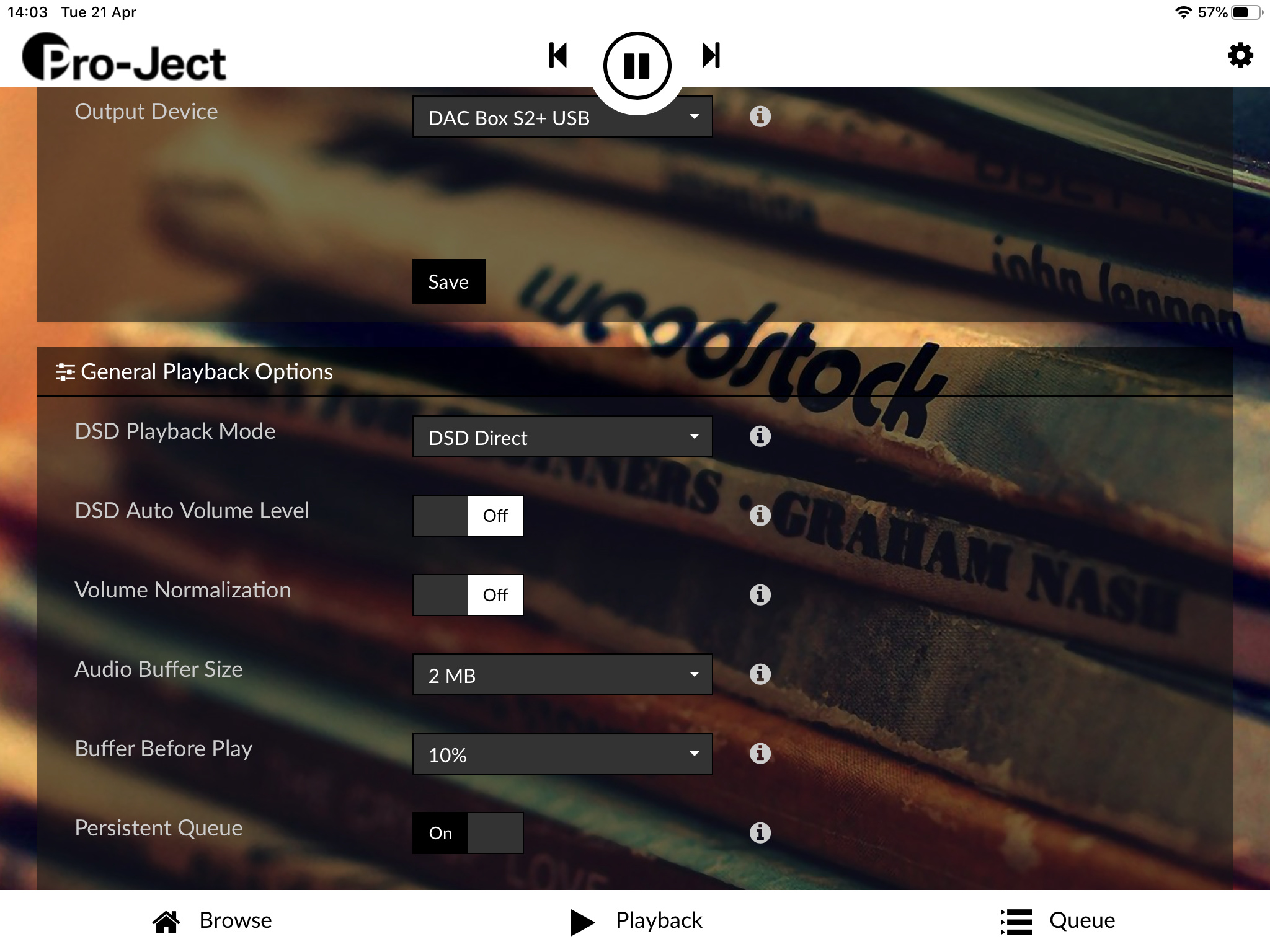

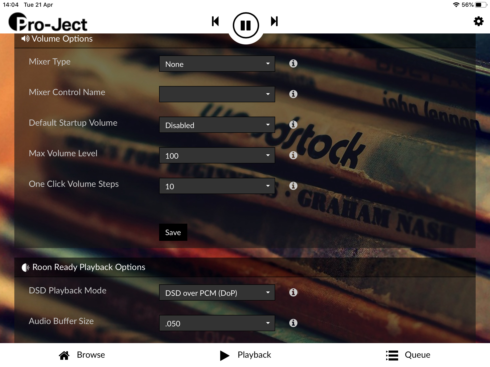

I would recommend that you post a screenshot of your S2 Streamer audio output settings here. Then it is easier to spot if you are missing something.

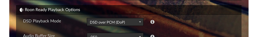

I’ll do that but the streamer’s settings get overrided by the streamer’s own ‘Roon Settings’ sub menu. As such, the streamer could be set to output DoP but the streamer’s Roon settings could be set to Native DSD. When using with Roon only the later has an effect.

Also, I notice on your screen shots, you had DSD Playback Mode set to DSD Direct, yet below you had:

There are two options in the streamer menus for DSD output setting. One is for the streamer when used with its own software, the other is for when using the streamer with a Roon. The streamer’s own settings don’t affect playback when using Roon, so it’s only the streamer’s Roon settings that matter.
