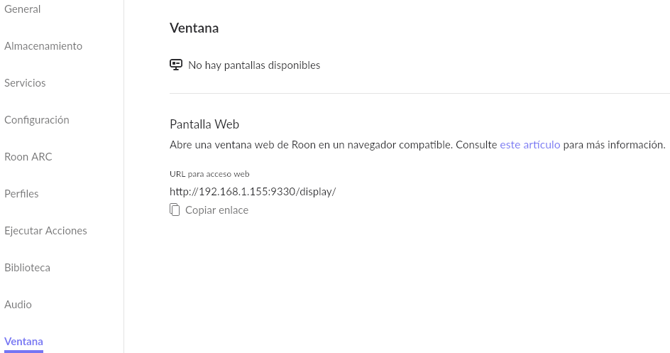

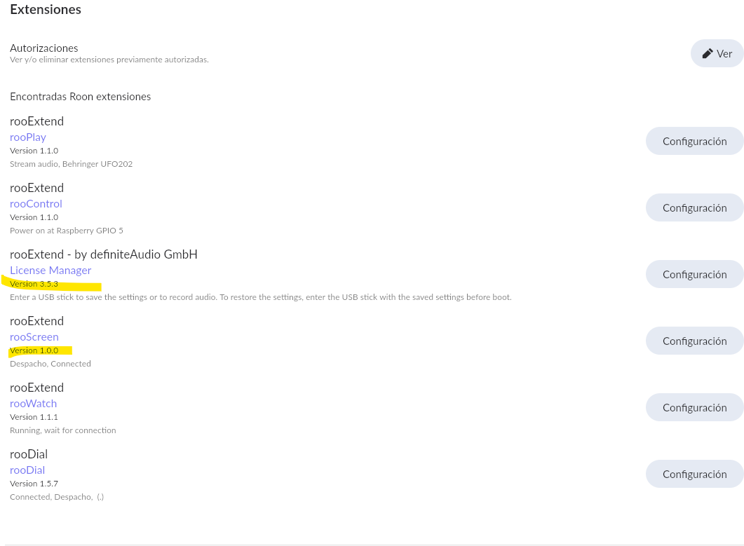

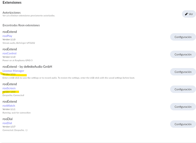

Hi @DrCWO , i´m finally back on 3.53. But I’m also back to the original problem, no available display (see the screenshots) . If this give you a clue, yesterday I could see the display available but last night rooextend rebooted unexpectly and after that reboot the display is no longer available, I can send you the logs if you need them. Thanks again for your support.

  • All extensions are running correctly: rooDial 1.5.7, rooPlay 1.1.0, rooWatch 1.1.1, rooControl 1.1.0, rooScreen 1.0.0

  1. After the fresh install, rooScreen initially worked — the display appeared in Roon and everything was fine.
  2. Then ROCK (Roon Core) rebooted overnight (i do it once per week).
  3. After that reboot, the display disappeared from Roon — “No hay pantallas disponibles” (No displays available).
  4. I restarted the Pi 4 (with ROCK already running) — the display did NOT come back.
  5. The rooExtend service page (http://192.168.1.128) is accessible and all extensions show as running.
  6. However, trying to access the rooExtend web interface initially returned ERR_CONNECTION_REFUSED from Chromium, though the service page itself works.
Ethernet test: in my opinion, WiFi is NOT the cause
Following your suggestion about WiFi and UDP packet loss, I connected the Pi 4 via wired Ethernet directly to the router. The issue persists exactly the same way — Roon still does not show the Chromium display. In my opinion, this rules out WiFi as the cause of the problem.
