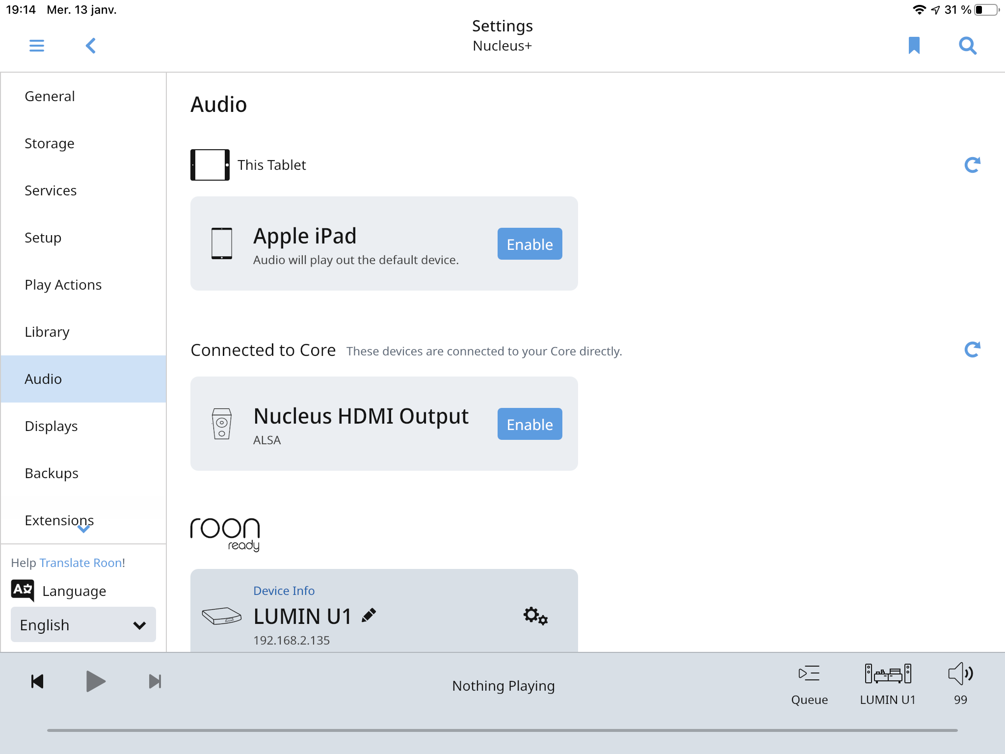

Can you share a screenshot of Settings > Audio for us?
Yes to both questions.
Screenshot:
