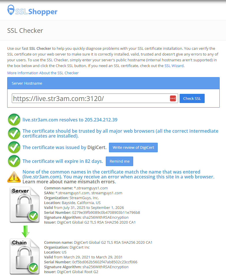

That may be, but it does appear to have a mostly valid TLS cert:
Reference: SSL Checker
I don’t have an account, so I don’t have a way to test beyond that. These days, it’s uncommon for services to support reusable passwords without encryption.
That’s interesting. I see that same result but if I try and connect I get
net::ERR_CERT_COMMON_NAME_INVALID
(Presumably the name mismatch error)
