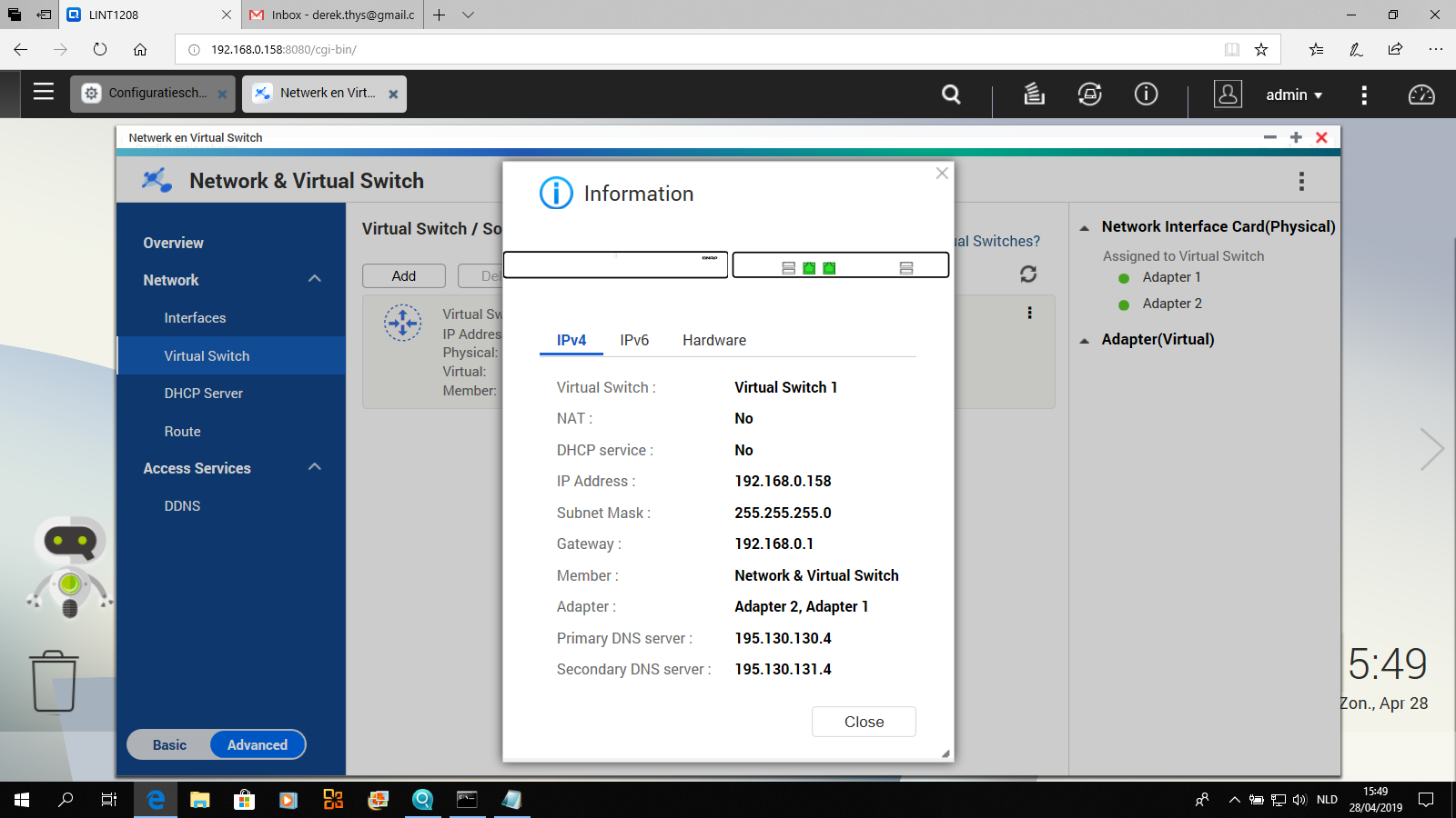

Using the new virtual switch I want to use the second adapter to connect to the
End point. (for the time being a Meridian MS600).
I was able to define the switch, but Roon no longer sees the MS600.

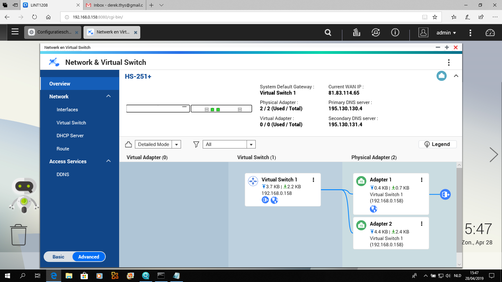

Why not connect the meridian to the router as well. Not sure how well the qnaps work as a physical layer 2 switch at all its designed to route vms on the nas not actual hardware. In you image both ports are assigned the same IP so that wont work at all. I dont think the VS should be running on both ports its usual to have it assigned to just one of them. The QNAP will bridge internally to it as far as I understand. Which method did you use to set it up.

The virtual switch is defined to use both ports.
Both Adaptors get the same IP address as does the virtual switch.
(I do find this a bit strange, but I can’t change it. The Qnap configures it that way.)
