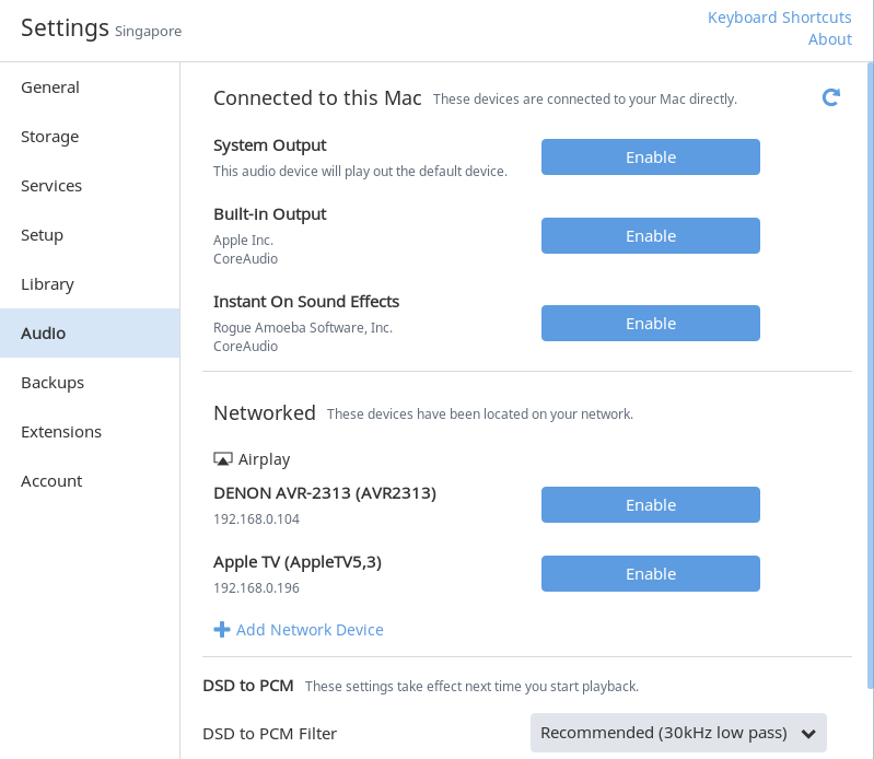

However, when I installed for testing purposes a second Roon Core on my iMac running on macOS (10.12.6), doing a fresh install from scratch, all connected audio devices are recognized. But this was also the case when I did a fresh install a couple of days ago on my Qnap NAS. That begs the question how long it might take before I run into the same problems with the macOS installation. But anyhow, this is not a solution to my problem, because I recently purchased a NAS just because I don’t want to use my desktop computer to manage my multimedia library.
These are the devices found when the Core is installed on the iMac:
