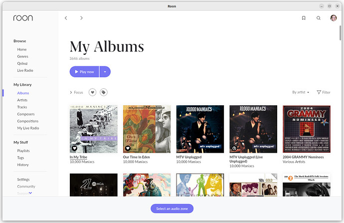

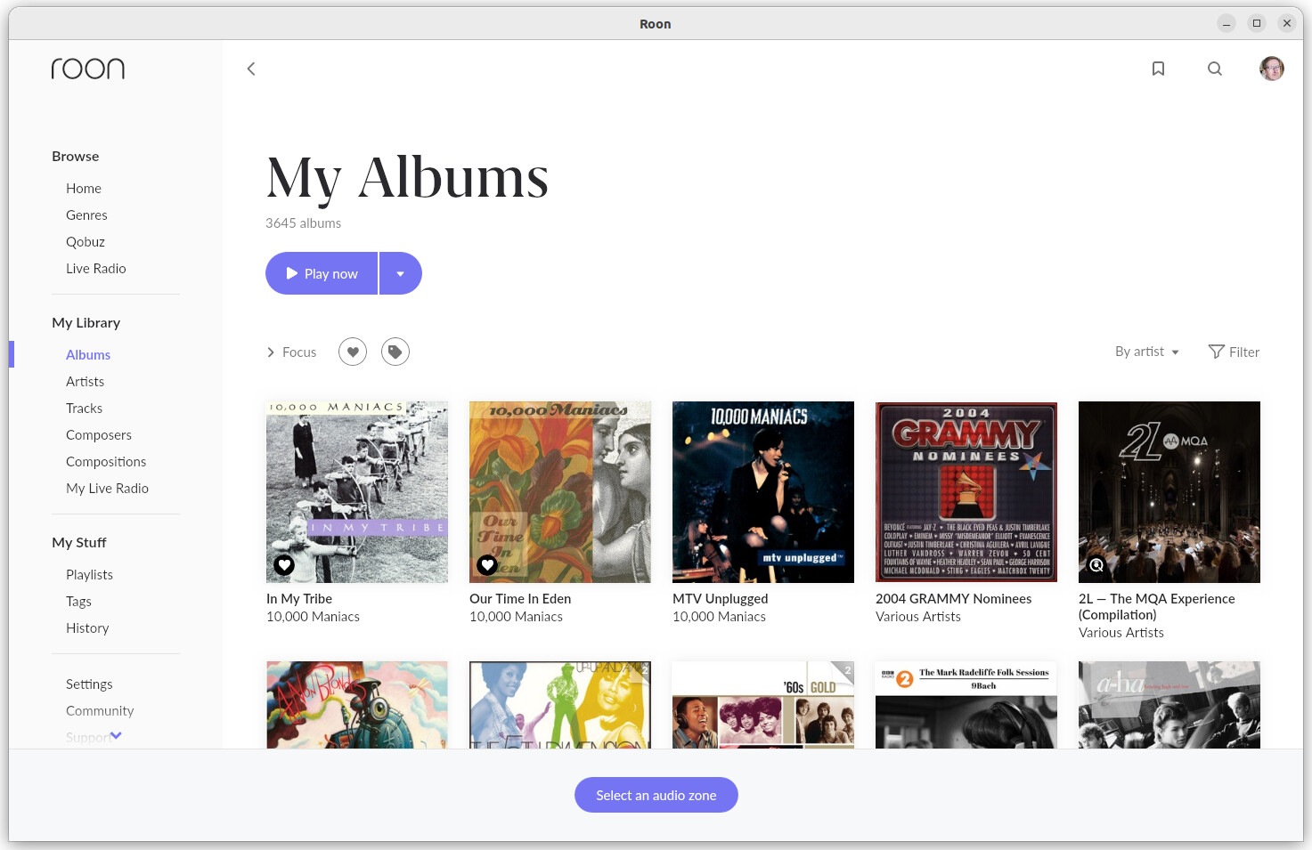

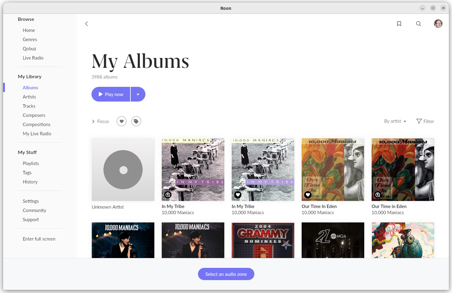

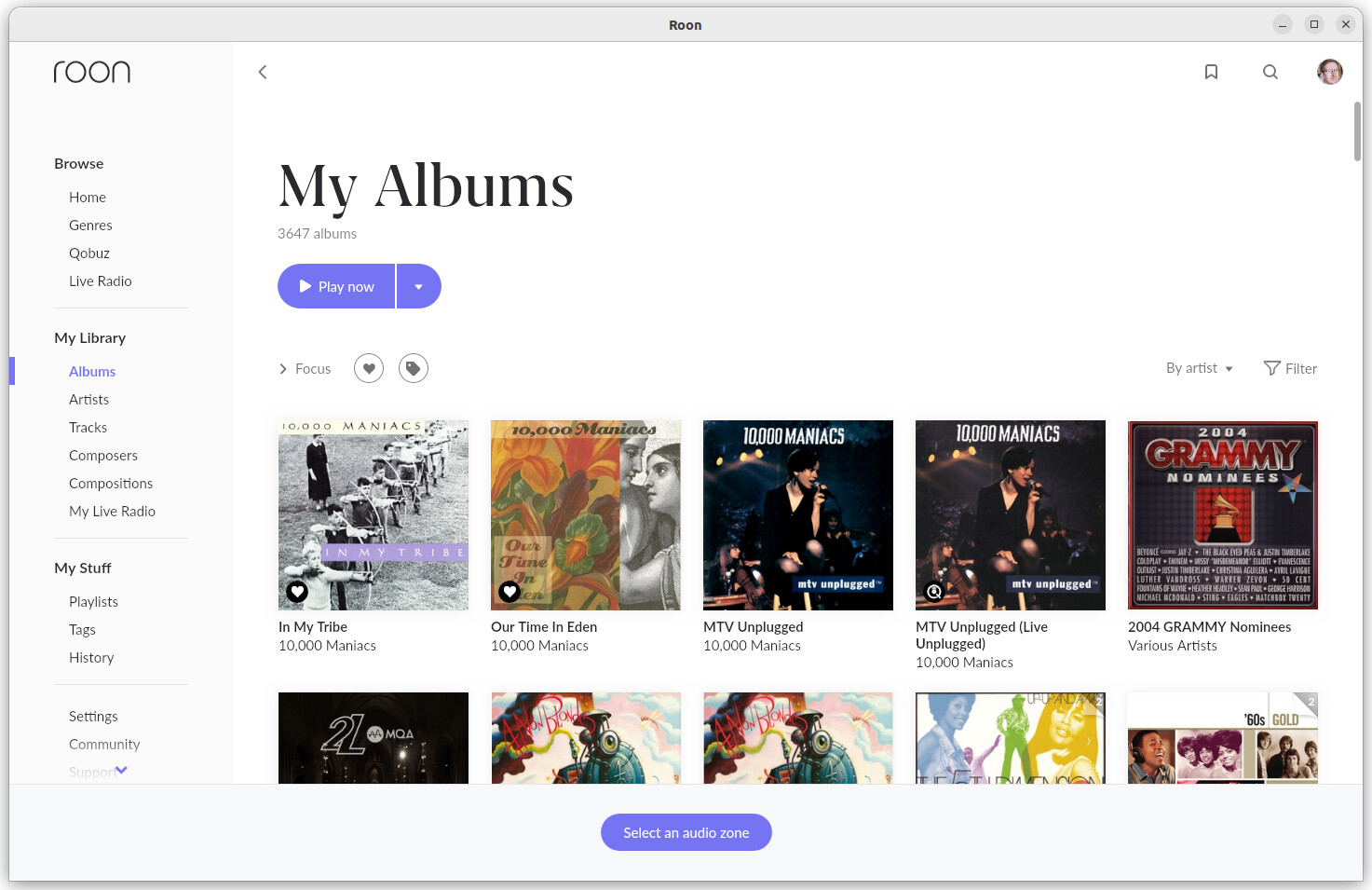

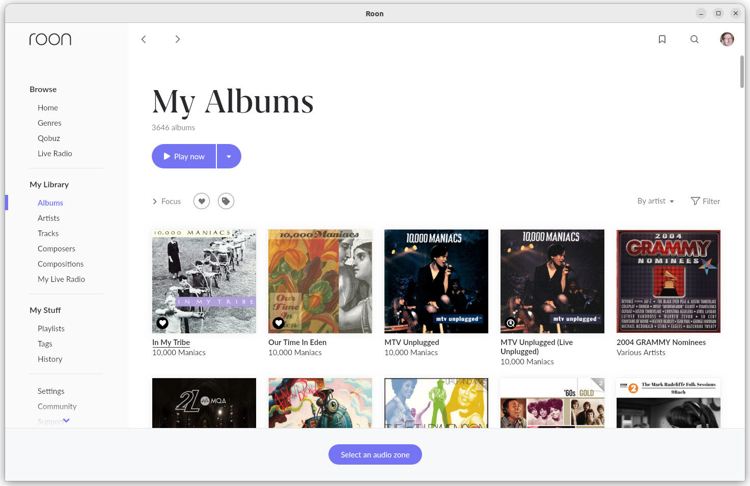

Perhaps this helps explain things?
Note 3647 albums, and the two 4 Non Blondes albums.
You mean grouping? With show hidden tracks and albums grouping now longer shows them as grouped they are al seperate and track count goes up. I dont merge albums only group.
mjw
4

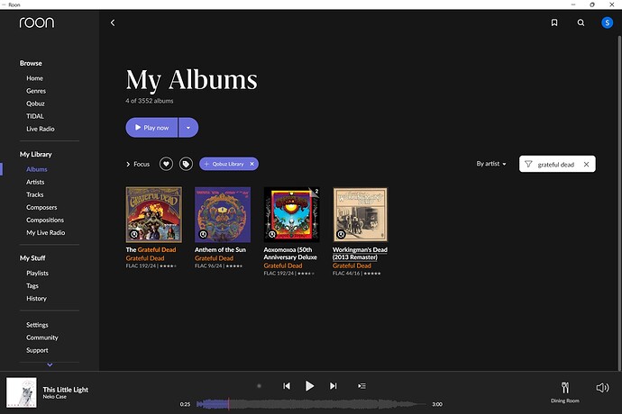

Yes, group alternate versions will reduce the album count.

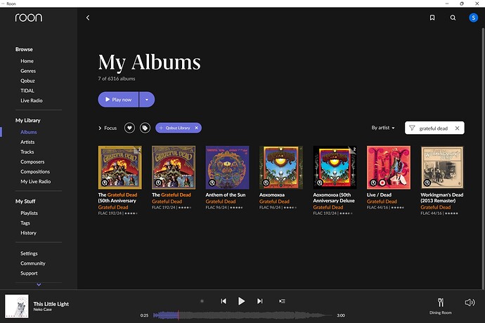

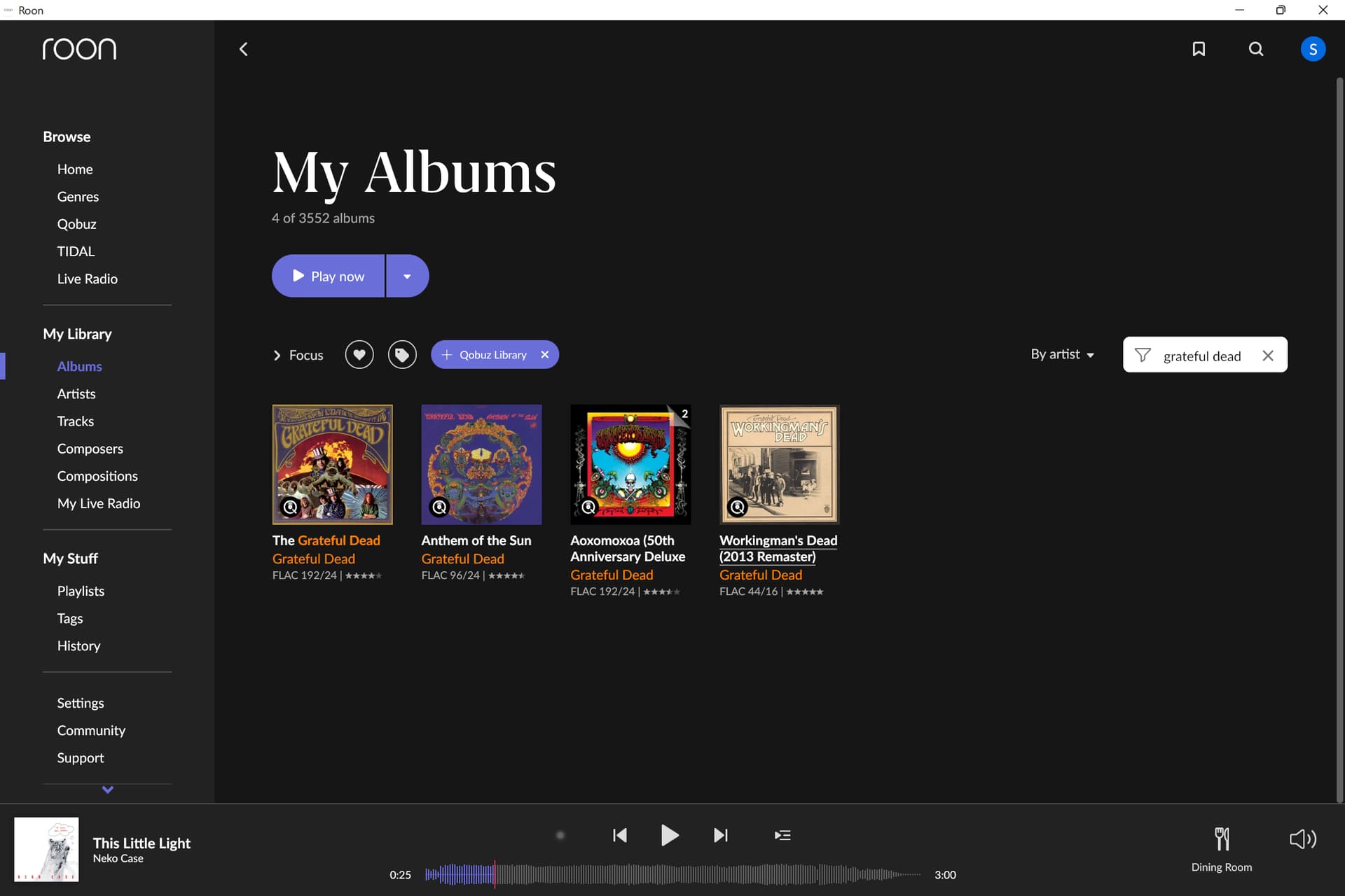

Did you have show hidden tracks on before you did that exampke as it will reduce as one as will now be hidden as its in the group. Seems odd that show hidden albums would not take that into account. If I clicck show hidden all my groups are shown as separate albums from the group and it will say I have that amount showing in album count.
example with show hidden each one of these dupes is grouped with alternate versions, 7 albums show, 7 albums in the count.

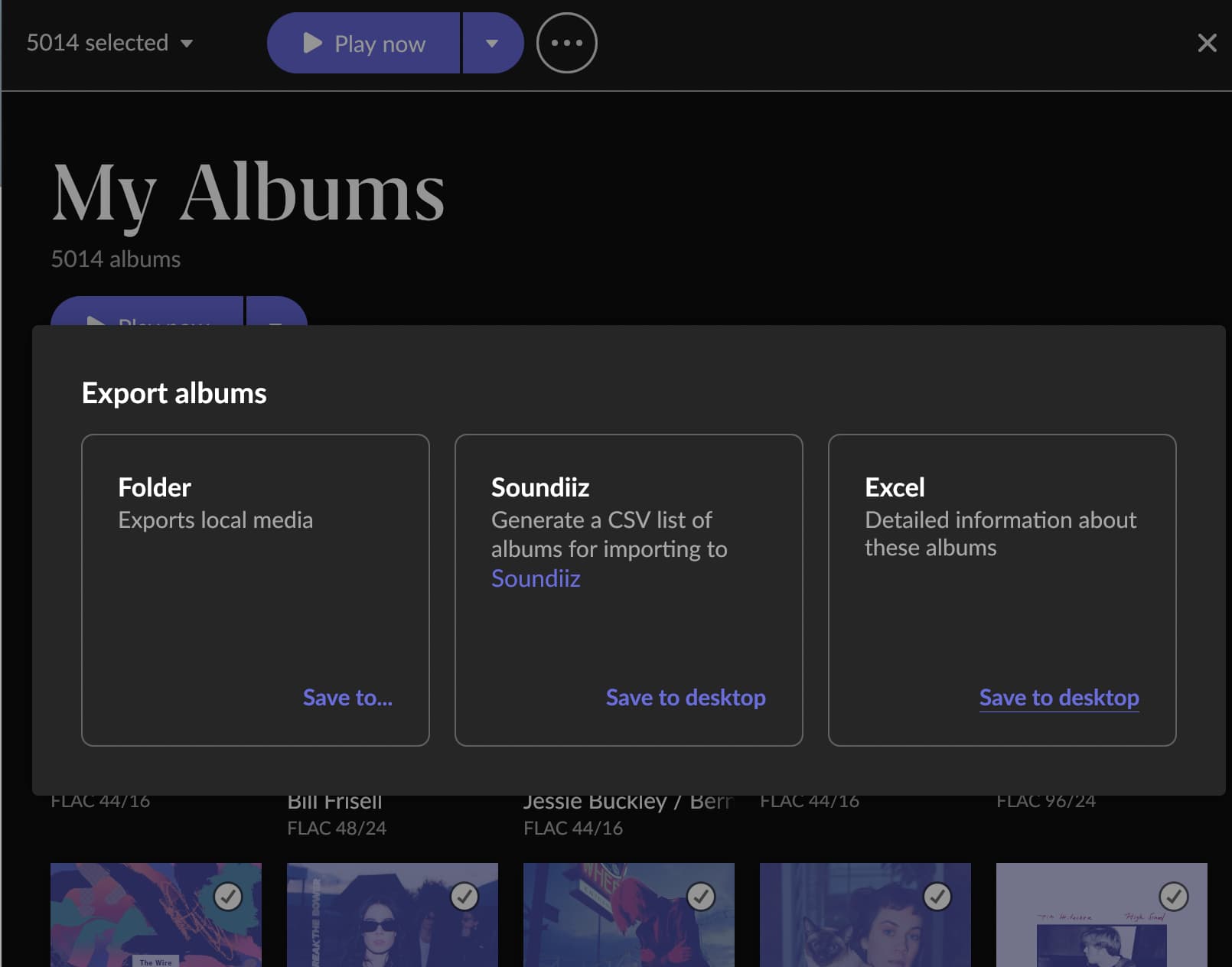

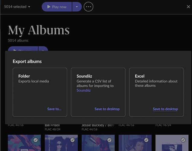

My current model. Keep a second independent Roon Server instance on my laptop with just the Qobuz favourites. Use it sparingly. When Roon or I decide to do a 'spring clean" on my main Roon server (not sure when this happens automatically - maybe on every Server reboot or update, maybe when logging out and into Qobuz again - a normal refresh doesn’t do this reliably), the chance that the second server updates at the same time is very small. So I see occasionally a difference in album count. I then do an Excel album export for all the Qobuz albums from both and with a bit of spreadsheet manipulation it’s easy to isolate the differences - the albums showing in one but not the other. Then simply check if alternative versions are available and replace the dangling references where possible with correct ones. Updates willl of course be picked up in both cores.
Clumsy? absolutely but could not come up with something better. Maybe ignoring completely would be best .
