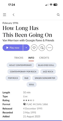

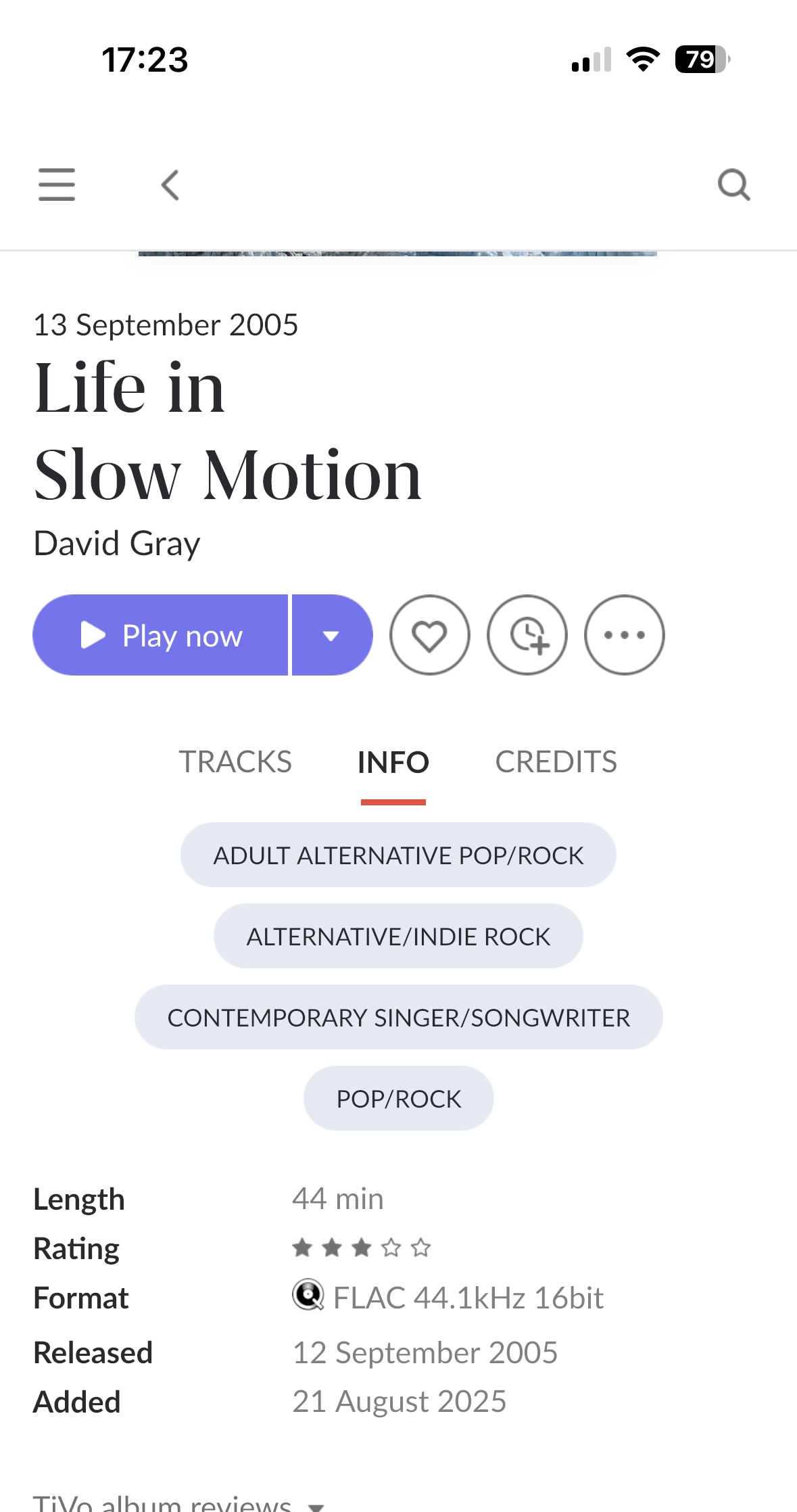

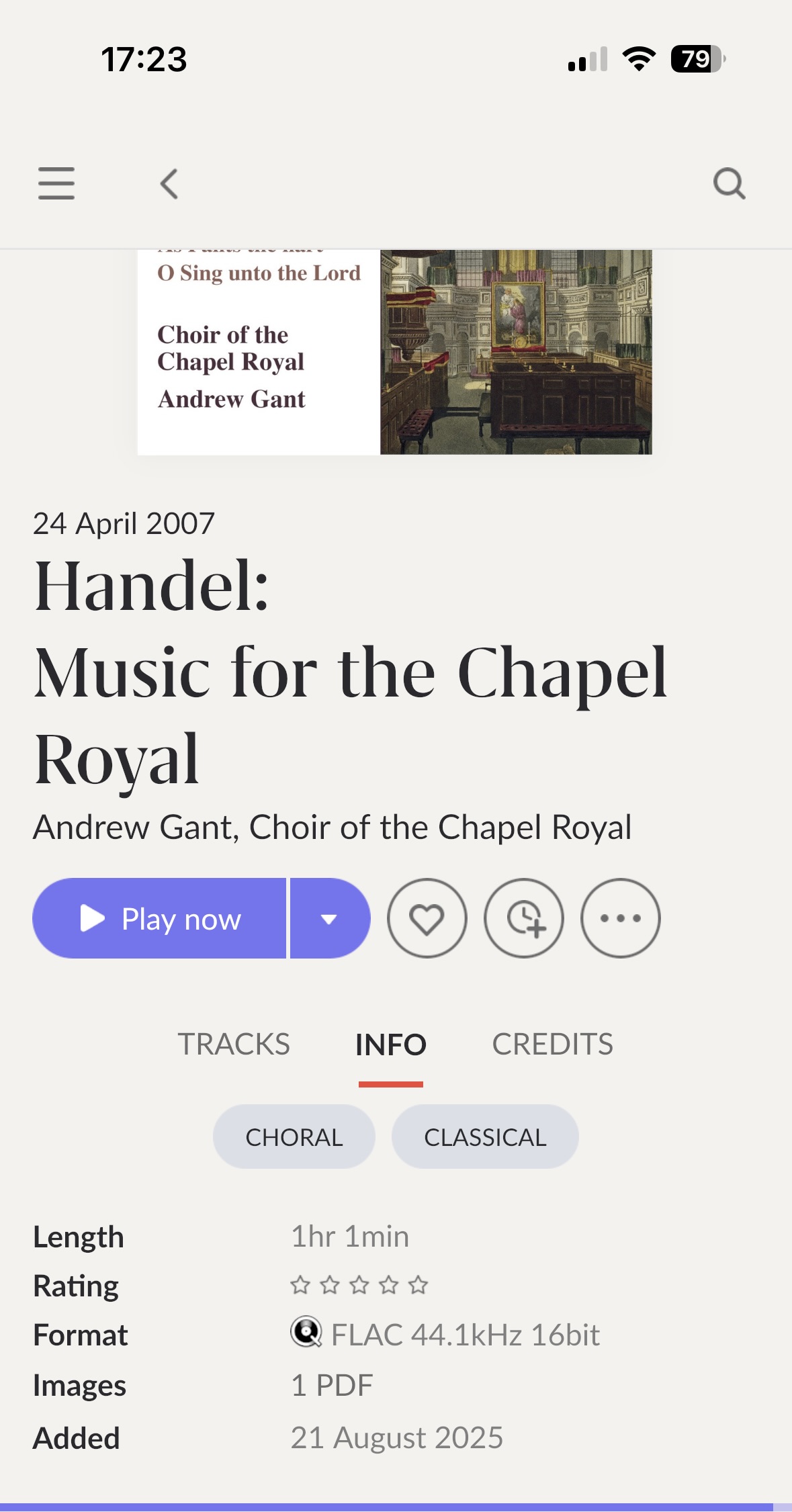

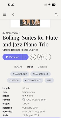

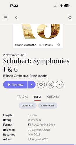

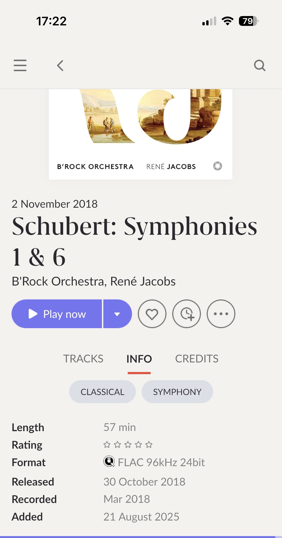

Of 1169 Qobuz albums, about 120 seem to have Aug 21 2025 for the date added; all of them were originally added long before that date. I am attaching screen shots of some examples.
