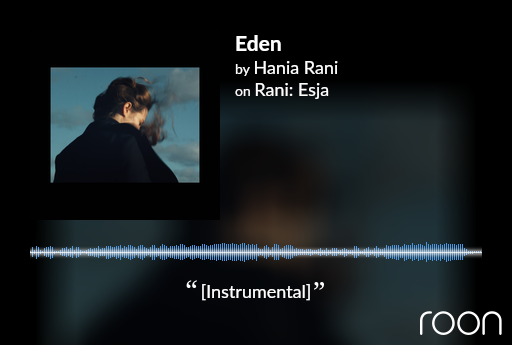

An example of mine that me (Qobuz purchase 44/24):
RoonShareImage-637819416295169802
Haven’t done any technical analysis yet, but for me distortion is clearly audible during louder passages.
However, I have not yet made a comparison with other download versions.
Is there distortion on both the downloaded and streamed version?

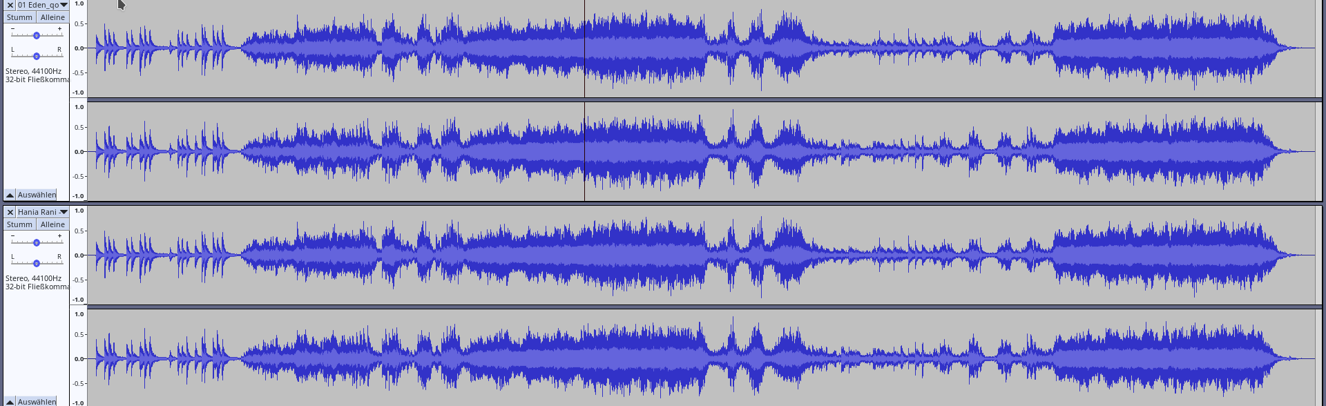

Please look at the flac using Audacity. You can easily see the clipping there. The Roon display is too small. In Audacity you should see many near-by peaks at the same level.
Both songs (Qobuz and Bandcamp) seem to be identical, at least visually.
Today I am no longer in a position to carry out such analyses. More info maybe tomorrow.
It really is a lot easier to hear clipping than to see it. In this case the waveform looks like it sounds, a bit bloated in the left channel. I still think it’s a poor recording of a nice piece of music. There’s also the possibility that it sounds as intended.
