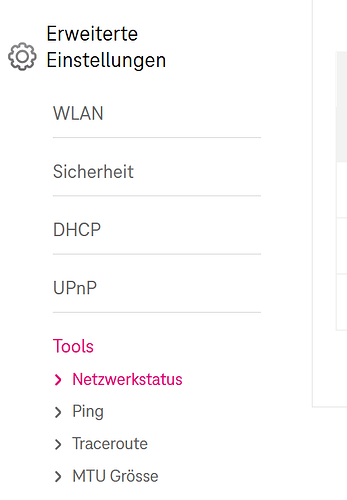

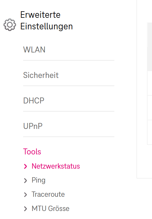

I can not find any settings in the router for bandwith prioritization, it is a simple 4 port device where now Roon server, Devialet and WiFi router are connected. Here screenshot of advanced settings:
