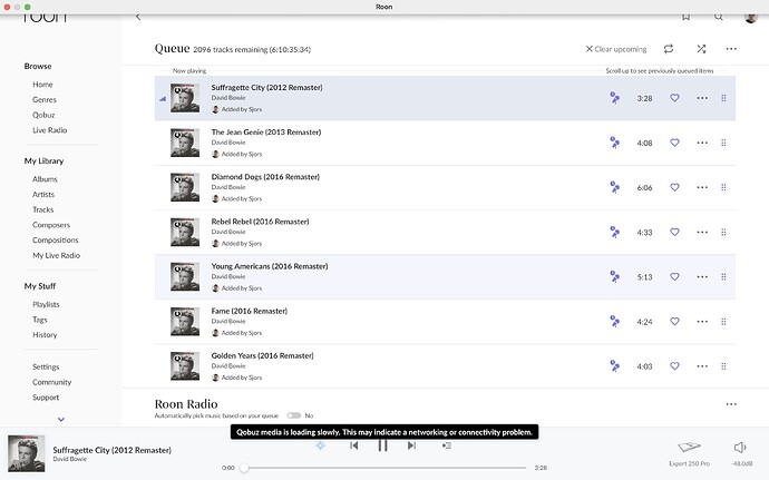

Hello,
I’ve seen the text a lot on my screen: “Qobuz media loading slowly. This may indicate a networking or connectivity problem.”
The track I choose to play isn’t played and Roon skips to the next, in my Play Queue.
What could I do for a smoother playback performance maybe? Looking forward to hear from you.

I have my server (Apple Macbook) and also my Roon Ready device (Devialet Audio) connected fully wired. And as a Wifi router Fritz!Box all up to date. For optimal performance as far as I can see.

Hello @Sjors_Ehv
Have you already tried power cycling the Fritzbox router?
If this doesn’t work, is your current setup still the same? …
No additional network equipment?
If so, would you try how it goes if you remove the Fritz!Repeater 2400 from the chain?
Just to get a clue.
If it turns out that the issue no longer exists when everything is connected directly to the router, you can think about other options:
Axel_Lesch, yes I did a power cycle on my Fritz!Box, this morning.
My current setup is all wired. From router to the server as well as from router to my streamer and Roon Ready device (Devialet audio). Also I’ve removed the Fritz!Repeater out of my network some time ago.

Do you have the option to test another endpoint, not Devialet?
Axel_Lesch thank you for sharing. I’ve watched the short video and it indeed looks smooth to me. That’s good!
No, I don’t have another Roon endpoint here. Except for my iPhone, Macbook and iPad that I usually don’t listen to with Roon on.
For testing purposes, could you enable the iPad/Macbook as an endpoint in the settings and see how it goes?

Yes I could and I will.

My beloved Devialet 250 Pro with Core Infinity is the streamer as well. Yes I have the ethernetcable already plugged in. And WiFi is turned Off also. :slightly_smiling_face:
Thanks a lot, Sjors
Axel_Lesch, I’ve just tried iPad/iPhone as an endpoint and it went well. After I switched back to my Devialet endpoint and it went well as well. It went clearly better than before and I wish it will be going like it does now. Thank you very much for the feedback.

… if the problem occurs again, might it help to deactivate the Devialets as an endpoint in the Roon settings and add them again? Just an idea.
