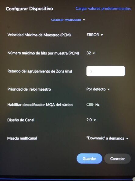

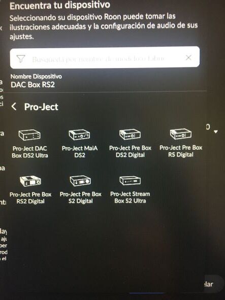

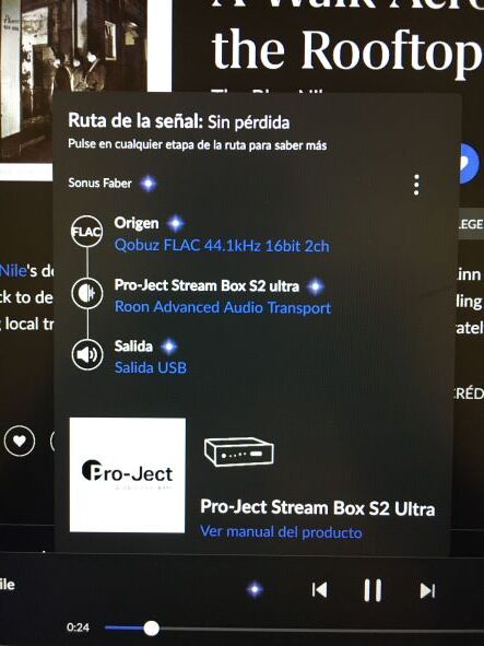

The reason for this email is to change my Streamer that was not Roon Tested or Roon Ready. I’m very happy with the Roon app I acquired the lifetime license some time ago, and not so happy with the old Streamer… it was time to change it! After much reading here in the forum I decided to take my amplifier and speakers to the music store and after trying several equipment, the one I liked the most and fit my budget was a Dac Project RS2, and Streamer s2 ultra. The Dac Project RS2 according to the store, what it says on its box and the manufacturer on its website, is Roon Tested and the Streamer is Roon Ready. Everything is going well but I ask them why the Dac Project RS2 does not recognize Roon comor Tested. Pro-Ject has several Roon Tested products that only appear in the configuration, but the RS2 does not. It generates doubts in its configuration.

I have researched this issue and it appears there’s a mixup on which pieces of hardware are Roon Tested/Roon Ready. The DAC Box RS2 is neither but the Pre Box RS2 Digital is Roon tested. This is likely the reason for the problems and confusion. Please let me know if you have any questions.
