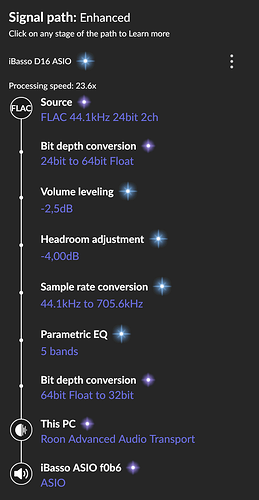

Could you post signal path screenshots of both ‘ok’ and ‘problem’ tracks playing?
I think that’s what I’d expect, so not clear why it sounds ‘not ok’.
What are the tracks? If I can find them on Tidal I’ll see if I get the same numbers - with the obvious caveat that I could be listening to a different master…
“Not OK” - have to turn the level up. Steely Dan “My Old School”
“OK” - Aes Dana, album “Inks”

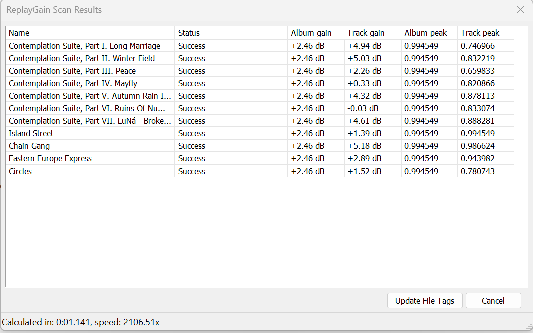

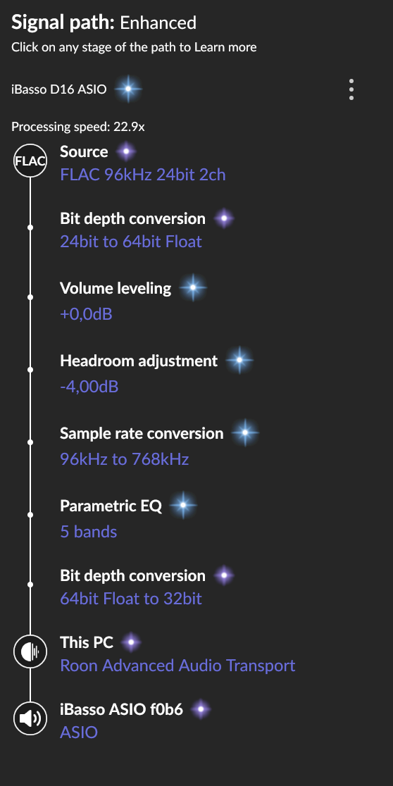

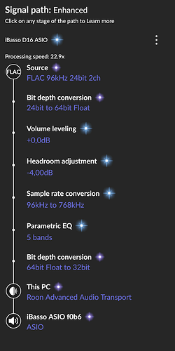

Here a small comparison on a low volume album: “Autumn Rain In A Secret Garden” - Csaba Pengő
Foobar2000 - + 2.4 dB
and Roon - + 0.0 dB
That would be a different of 2.4 dB
Torben

foobar2000 is using R128 LUFS -18. And works nicely. @Torben_Rick you should be able to scan and add RG tags to your 600 local albums in just a few hours in a batch mode with only a few clicks of your mouse to get it started.
Keep in mind that adding the RG tags won’t help you if you do not tick the option to let the RG tags override Roon volume adjustment tags. As you’ve shown above, Roon in your example would play the album at a much lower volume than use of the RG tags (+0 in roon vs. +2.4 in foobar RG tags).

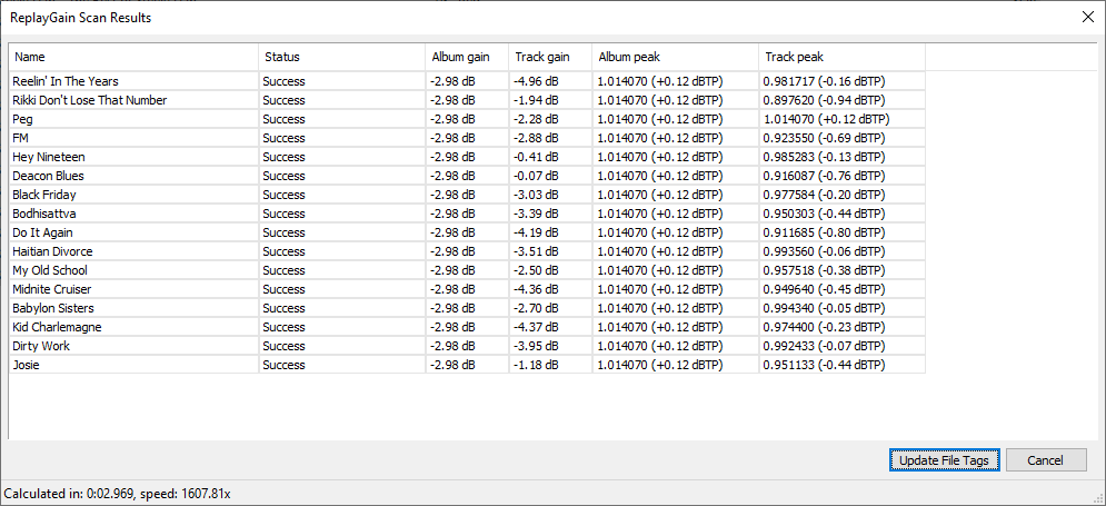

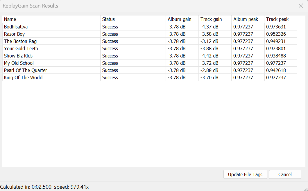

This is my result with what I’d consider a faily typical CD rip:
All the track gains are negative, which I think is what I’d expect from a remastered compilation from 1993.
I think what you are seeing is Foobar indicating that a positive gain is needed to bring the album up to -18LUFS; however, because the peak level of one track is particularly high, Roon can’t apply that much gain without clipping.

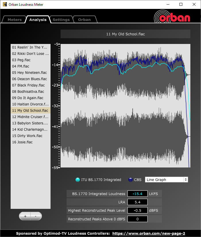

This is an R128 analysis of My Old School…
… which to my mind confirms the -2.5dB RG track gain is about right.

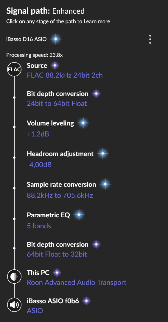

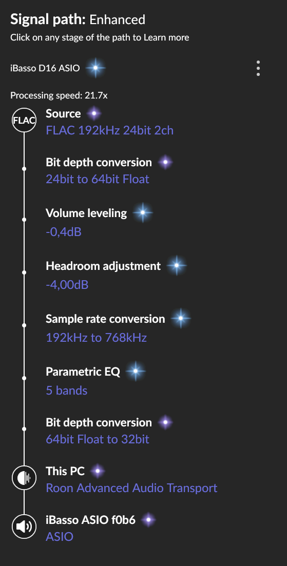

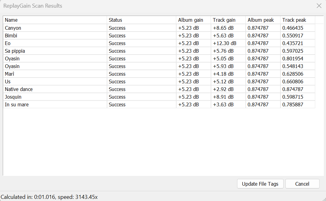

Here a another example: Peo Alfonsi & Salvatore Maiore - Alma
Roon adds +1.2 dB
Foobar2000 adds + 5.23 dB
Foobar2000 would probably the right one compared to other albums.

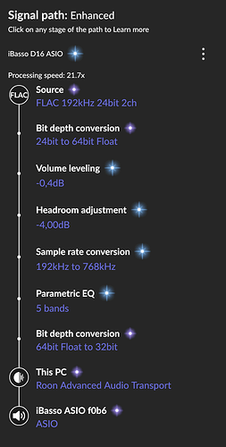

This is -14LUFS
and this is -23LUFS
Torben
And now, does the different target value change the relative loudness perception between different albums or tracks to the better?
