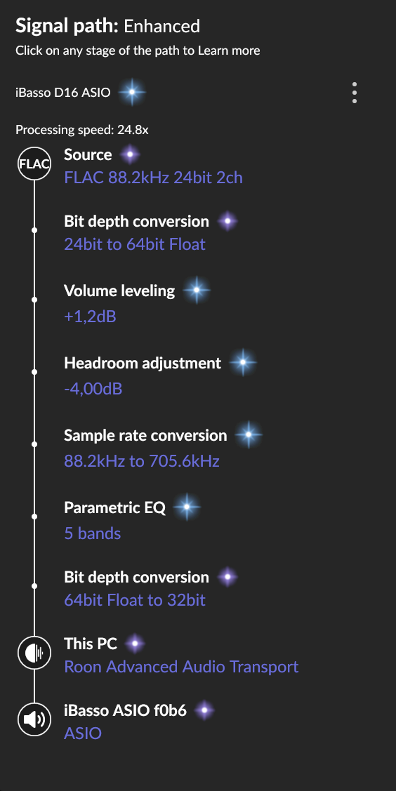

So, there should be a Volume leveling value difference of 9 dB between the -14 LUFS and -23 LUFS settings. But there is only a 5.2 dB difference [1.2 - (-4) = 5.2]. That is 3.8 dB of Volume leveling unable to be applied.
The reason is Roon’s Volume leveling will not amplify into digital clipping. And that affects a lot of higher dynamic range recordings on the -14 LUFS setting — those recordings simply cannot have enough gain added to reach -14 LUFS without clipping.
If you want Roon’s Volume leveling to work optimally, you need to set it to around -23 LUFS. That will ensure nearly all recordings have negative value Volume leveling adjustments. The digital clipping limit will not come into play, and overall more consistent Volume leveling.
AJ

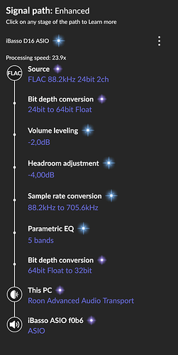

The difference is actually 3.2dB, which is worse.
Oops, right. I glanced too quickly at the Signal path and grabbed the second Headroom adjustment figure instead of the second Volume leveling figure.
Here is the math again:
[1.2 - (-2.0)] = 3.2
And that is bad, since the difference should be 9 dB. One recording is effectively 6 dB louder than the other because of inadequate -14 LUFS Volume leveling.
AJ
