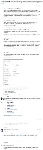

Are you saying that when you click on the link to a post I made, you can’t read it? It has had 516 views since 2020. I’m posting a screenshot of it here just in case it’s been made invisible:
No. I can read the link your original post and your screenshot. I just cannot see any discussion. All I can see is 518 views and then it was closed. I don’t think was one of the viewers, or if I was I cannot remember.
My question is, how your post relates to this thread. In your original post you have target LUFS set to -14. This thread is about the need to set it to anything between -16 and -23 for better results, especially if you have a lot of modern masters. Did you ever try that? Was the result the same or better?
I guess I was responding to @Torben_Rick’s post Questions about Volume Levelling - #5 by Torben_Rick saying he found he still had to adjust levels when leveling was active, and not to the OP’s questions. But it doesn’t really matter what the leveling types are and how to use them and what the proper level should be if roon doesn’t apply the right correction to play two recordings at the same loudness level.

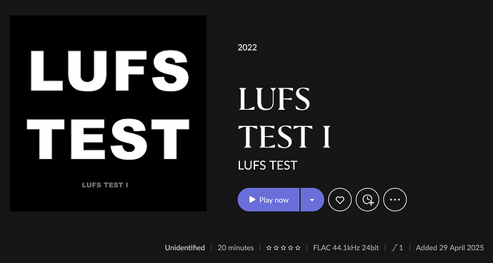

For test I just bought this album:

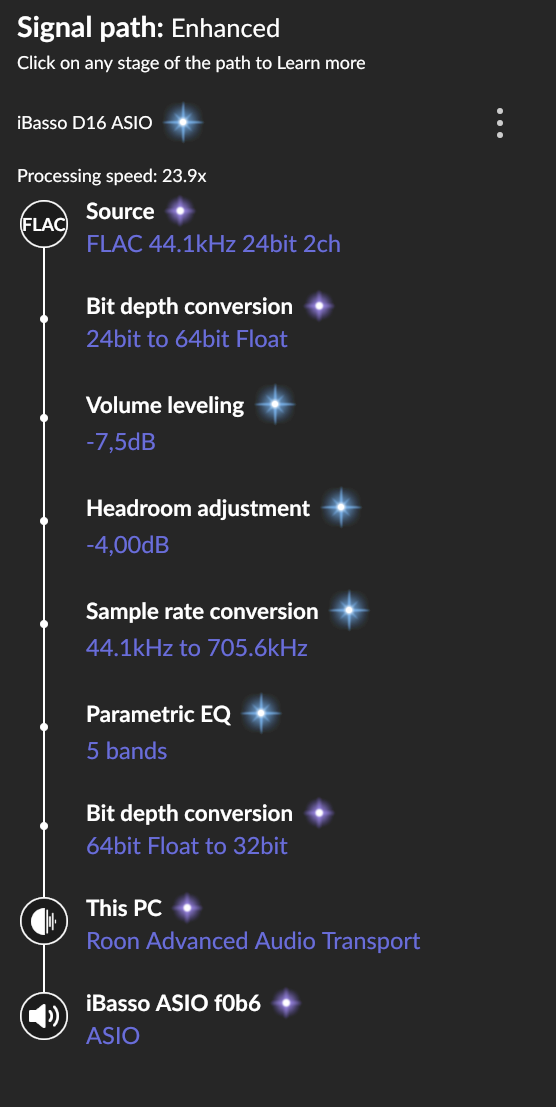

In Roon all tracks show -7.5
Torben
What target LUFS have you set?
-14LUFS and Album
Torben
That test album is also available on Qobuz streaming.
I set LUFS to -23 and Auto. Roon levels all tracks to -16.5dB.
However, perceived volume is lower for each track as LUFS is increased. I’m not sure what is being tested. I assumed that roon would level the tracks so they all played at the same volume. That is clearly not happening.
You may not see this because you are blocking me, but if you want Roon to level tracks within an album you need to set it to Tracks, not Auto.

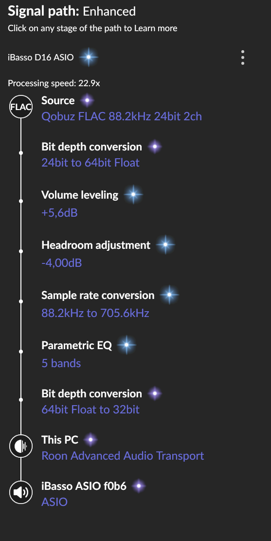

You use “Auto” - but why is there such a big different between “Auto” and “Track”?
Track:
Auto:
Torben
