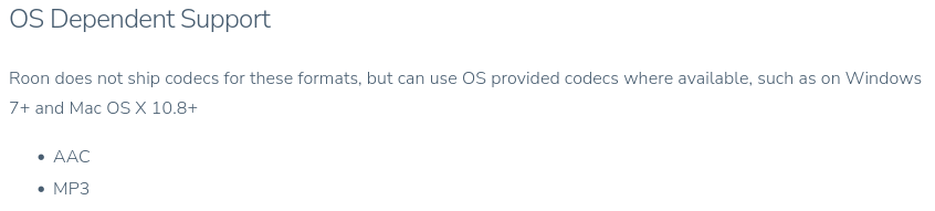

Did you make sure that you have the required codecs installed/available on your Roon Server machine? What is your Roon Server installation (Windows, MacOS, Linux, NAS)?

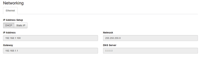

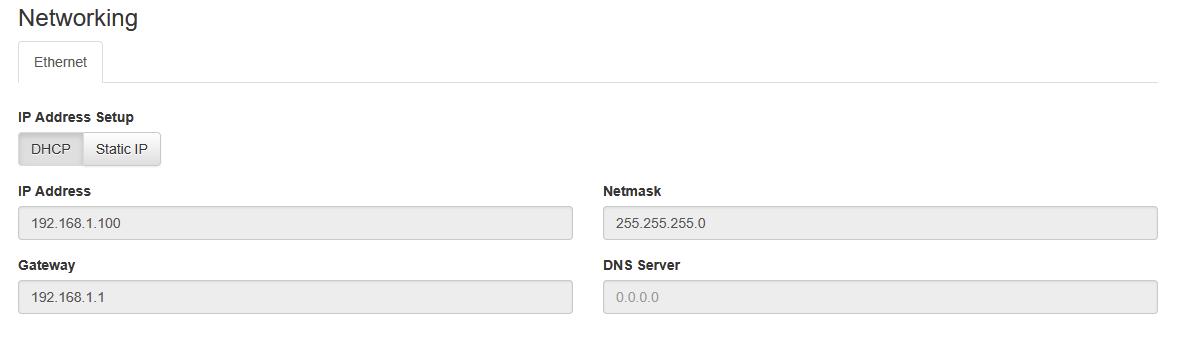

I’m particularly curious about the DNS settings on your Nucleus One. Have you configured any DNS servers directly on the Nucleus One?
As a test, could you try manually setting the DNS servers to Cloudflare (1.1.1.1) or Google DNS (8.8.8.8) both on the Nucleus One and within your Tailscale configuration?
You can check the Nucleus network settings using the WebUI

Thank you! I think you are right, there is something wrong with the DNS…My DHCP is managed on a NAS, I don’t know why it does not work for the moment, I will investigate (but the DNS is well taken on the other devices…).
Thank you for your reply! I have a roon Nucleus so I think this is okay?
Yes, a Nucleus should ship with the required Codecs, like using Windows or MacOS. However, if you used ROCK, you would have to provide and copy in the ffmpeg codec.

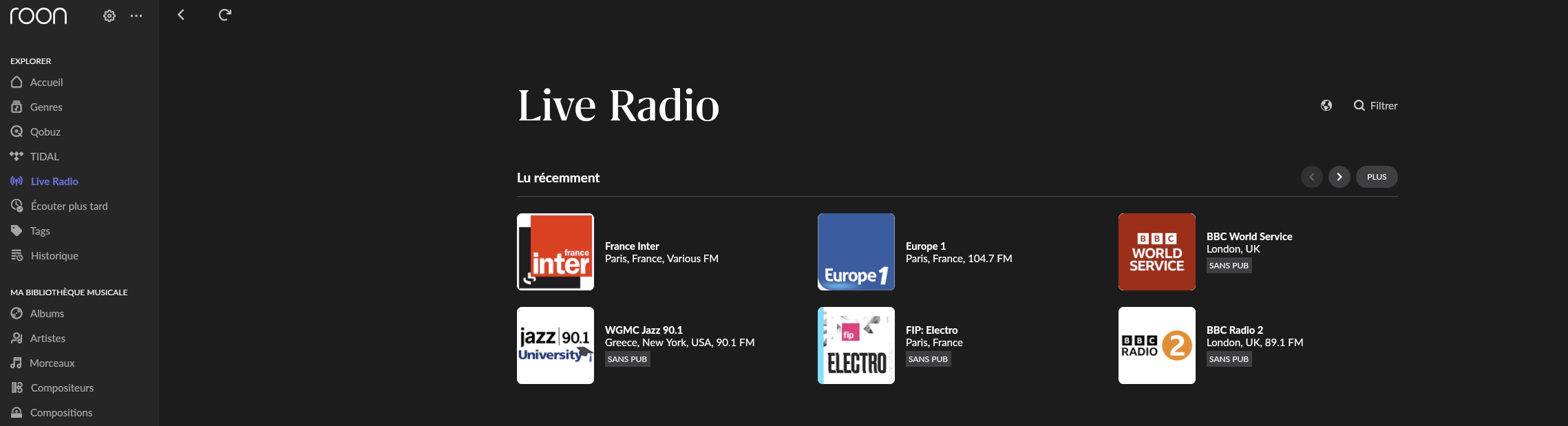

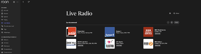

I think the network settings are correct. Also, some radio stations work (BBC Radio 2 works), but others don’t (BBC World Service, France Inter)… I don’t understand why for now!
