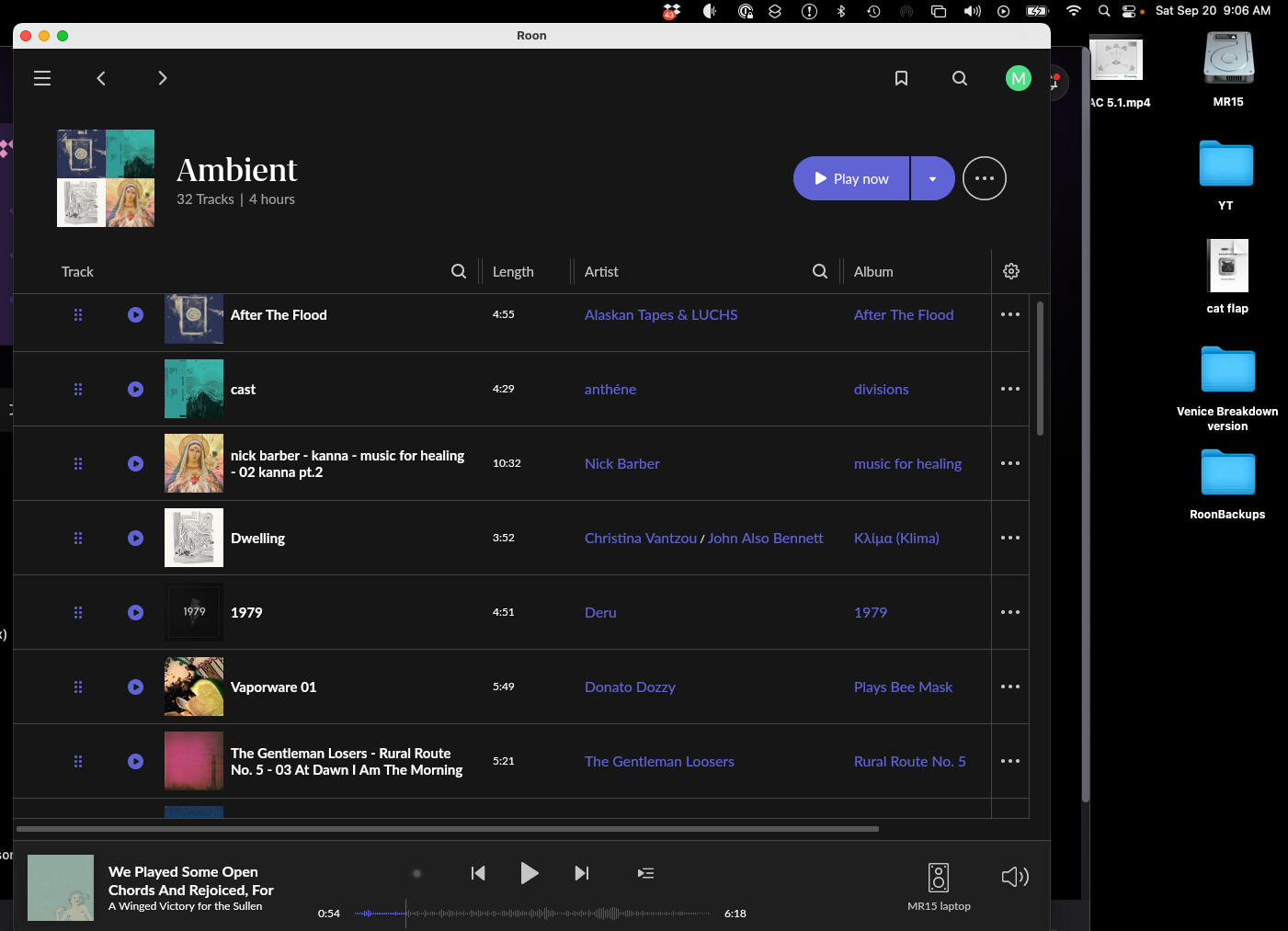

Here’s the last time it stopped: Sep 20 approx 9.05
Can you see anything in the log that might tell us whats happening?
This is where it stopped. I then went back to the previous track and played it, and then it played this same track totally fine.
