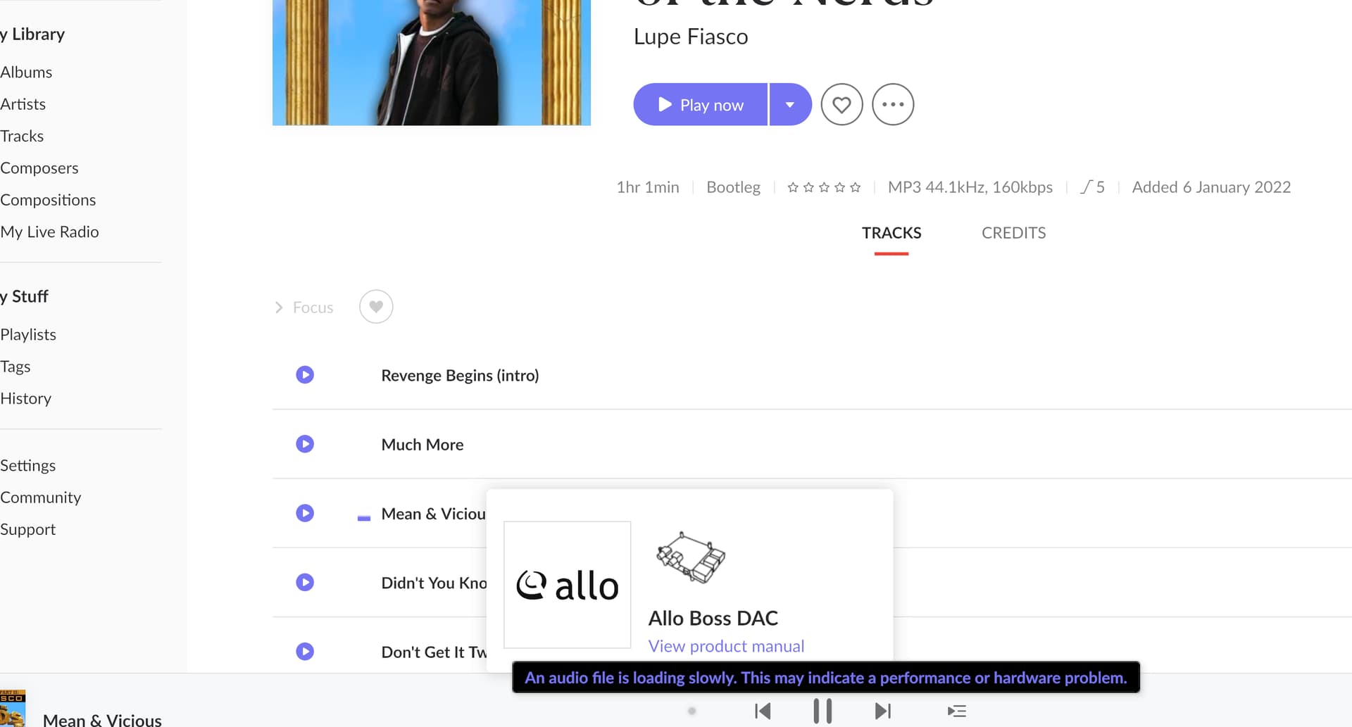

I recently built a room bridge with a raspberry pi 3 and a hifi berry hat. While listening sometimes mid song it skips to another song. I pulled up the client on my Mac, it flashes a message that’s too fast for me to catch. But it’s something about network slowness. Where do I find details about the issue. Also my network isn’t slow the client is about 15ft from the ap.cc

Below is the screenshot of the error. It happens no matter what the bit rate is. I’ve received it on 192K or flac music. If I play these same songs to another endpoint no issues. Do you need to see other bit rates?

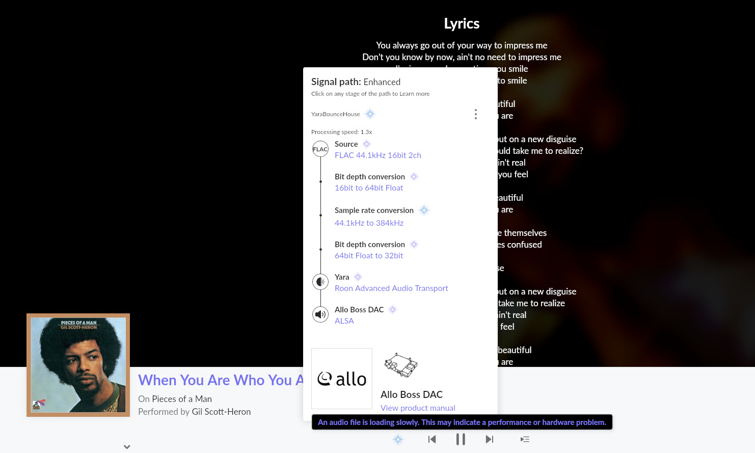

What happens if you disable sample rate conversion? Your Core is struggling to perform this… note the processing speed of 1.3.
As an aside, you could try Power of 2 upsampling instead. I find that this yields positive results with the PCM5122 in your Allo Boss. But only try this after disabling.
I disabled conversion sampling. Do I need to turn that on? My core is on a VM, there are more resources to throw at the VM. I don’t know that my ears can hear huge differences in sound. My goal with Roon is to play music on the sound systems throughout my house. Im not totally sure what “Power of 2 upsampling” is, but again do I need it?

No, it’s not essential. I’d keep sample rate turned off unless you can hear a difference. Max power of 2 is an upsampling algorithm used in digital signal processing. You can read more here.

Please share a screenshot of the entire signal path.
Do I read that you are using a RPi3 on wireless as your endpoint ?
If so you will find all sorts of threads mentioning exactly what you are quoting.
Roon is data intensive and hence network intensive , wireless often is a weak link. Many users (me included) gave up on wifi in preference for ethernet purely for stability (No matter how fast your WiFi is )
If you can run an ethernet cable (even as a test) to the pi and see if that improves matters. I one used a WiFi Extender with an Ethernet port to rig a cable on wireless that was way better than “raw wifi”
