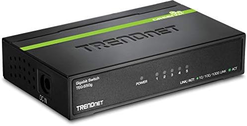

For others that may bump into this thread, Andrew Gillis (of SGC/Sonore/Vortexbox) recommends this:
