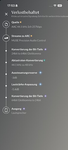

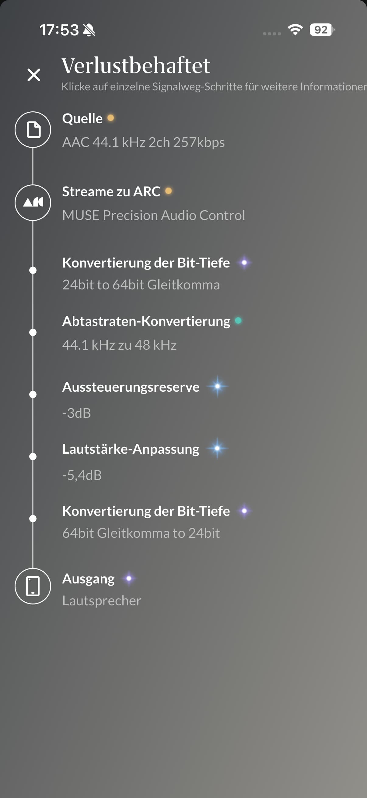

When using ARC my iPhone gets really warm and the battery is draining much quicker than streaming videos or surfing. That‘s strange because in ARC the display is off the most time. I‘m using ARC only in my local network as it feels more native than the Roon App, which btw. also make my iPhone getting warm.
I only use Loudness normalization and no other effect. The quality setting for playback is set to automatic. Most of my files are AAC256. It seems that Roon does not use the AAC decoder from the hardware and processes everything in software. Is there a way to force native AAC decoding?
Can you please show the signal path
This was the path when writing the post.

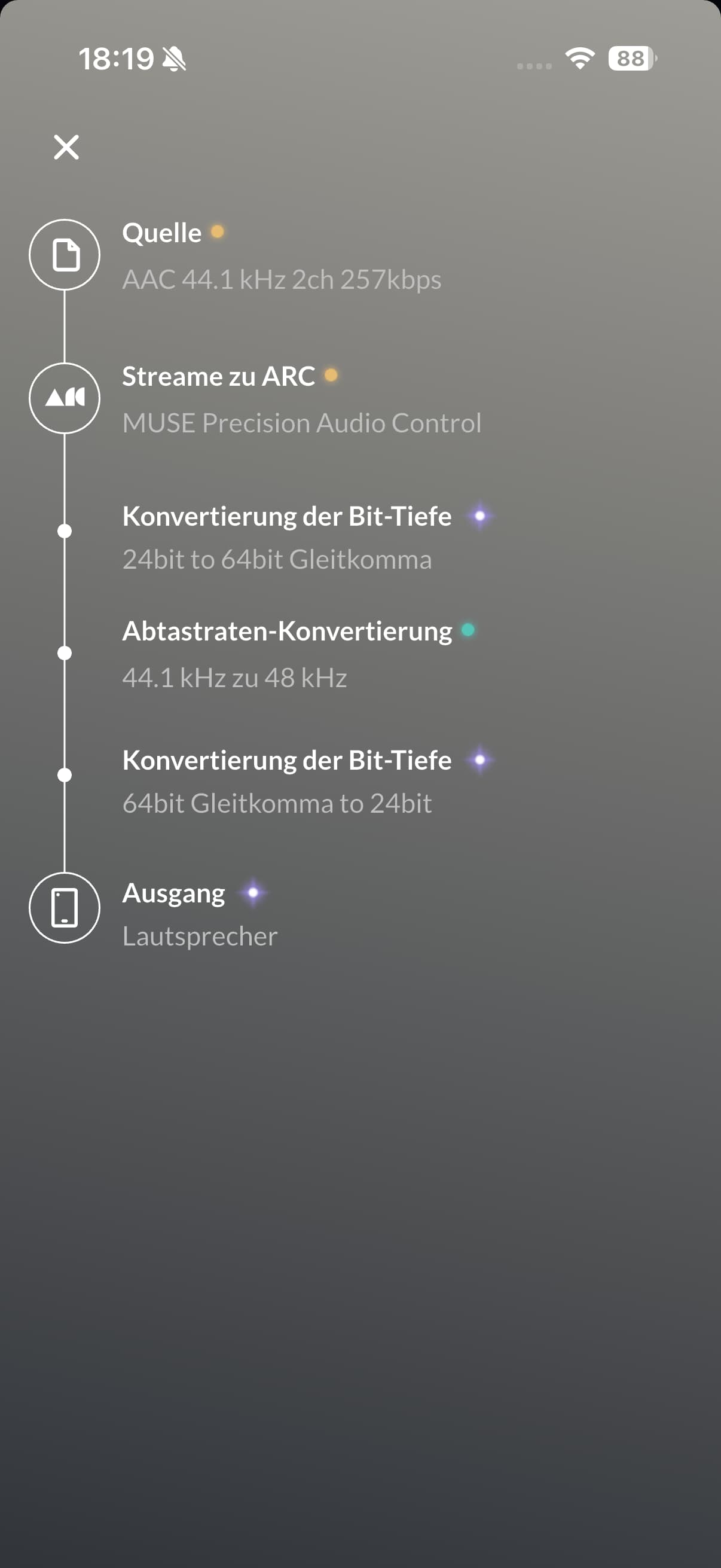

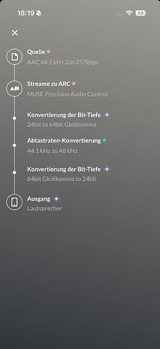

I now tried to disable everything I’ve found (volume leveling, headroom management, etc.), but I can’t get ARC not to convert between 24 bit to 64 bit and back. It seems an iPhone only supports 48 kHz, so I can’t get rid of the 44,1 to 48 conversion.
No, because it converts to 48 kHz (necessarily) and all DSP happens in 64 bit space. This won’t be the big drain, though.
