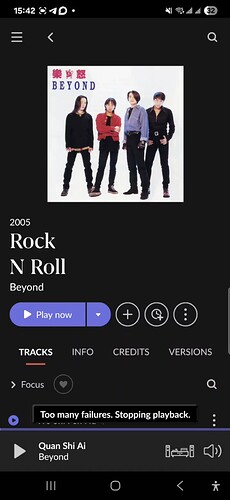

I have noticed that certain albums, whose original titles are in Chinese and are available and playable without any issues on the KKBOX app, do not appear in the search results when I use Roon. Furthermore, for some albums, even when I search using their full English titles, I frequently encounter a “fail to play back” error.

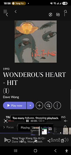

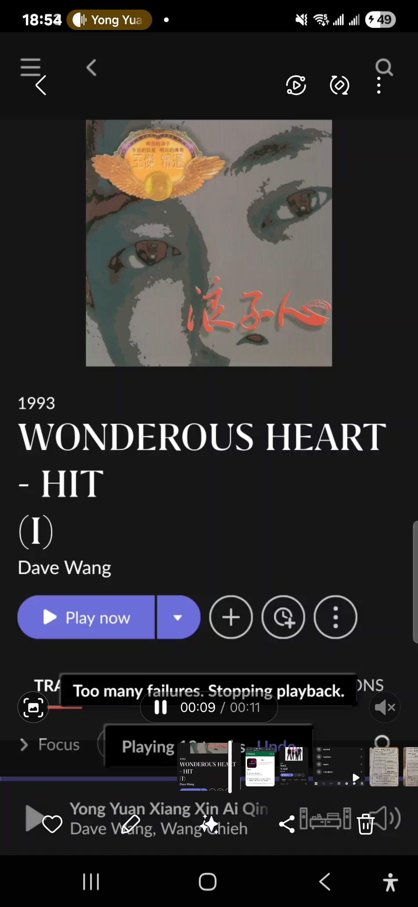

Actually I can search such album by artist name, and display English name which original name is Chinese, but appeared “Too many failures. Stopping playback”. It seems that kkbox cannot recognize such album using the English album name.
I am ready. The time 19:07 GMT +8
