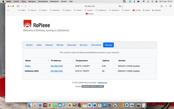

Worked for me…thanks for your work on this product.
Works here, too. Thanks, as always for your great contribution to this community, @spockfish
