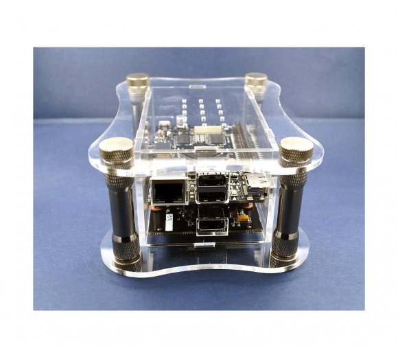

This update is for the Signature model. Ropieee will not work or install on the original USBridge that uses the Sparky SBC board.
The USBridge Sig is built around an RPi Compute Module which is why it is able to run Ropieee.
This is the original model USBridge that will NOT run Ropieee:
IMG_0936
whoops soz. I’ll remove & repost.

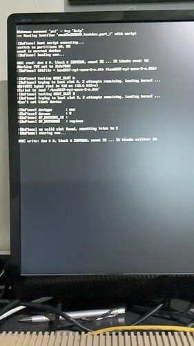

I’ve got the same problem with RPi Zero 2 W.
@spockfish
Please attention for ZERO.
Same experience here. This is where it stops. It is a bit blurry, as it goes very fast, It immediately reboots after this screen.
Hi @Erwin_Schurmann ,
This pointed me in the right direction to figure out what was going on.
Good news is that I’ve got a patch that works - it does however will take me until later tonight before I can release it.
Regards,
Harry
