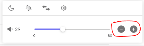

I think, correct me if I am wrong, that when one can change the volume of a zone via Roon Remote with the “+” and “-” keys, it should be possible to use a USB HID device to change the volume of that same zone.
Amongst others. Play/Pause/Previous/Next also.
Indeed, also those functions (Play/Pause/Previous/Next) will than work. But that is an easy trick to check if it will work before one will buy a USB HID device.
