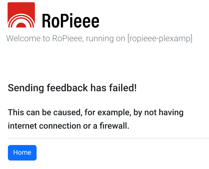

Is there a manual way to send feedback? Mine has failed, and I don’t think it’s a firewall issue, as it’s exposed to the internet behind a standard router like everything else. It should be able to send it’s diagnostics (unless I should be enabling uPNP for this device or forwarding a port…)

I’m not sure what you mean exactly. If you can’t send feedback from the RoPieee webpage (how do you come to the conclusion that it failed?) then there’s nothing else I can do.

Maybe I wasn’t clear. The update didn’t fail. Sending the feedback log continues to fail. I was just asking if there was maybe a way to download the logs locally and then email it the old fashioned way. I also know my way around a linux command-line. I was also thinking maybe I could SSH in and find that same info. In any case, thanks again. I guess I will just flash the latest version.
Sounds like a corrupt sd card or dead so I would burn a new one - not the existing one just to be sure
