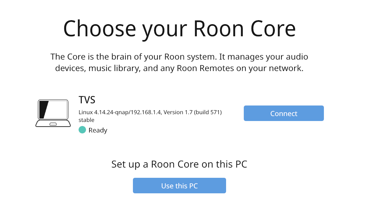

After I did the last update for Roon, none of my remotes can connect to the ROON server. The ROON server is ready (green an I am seeing it from the remote however I cannot connect)
I have a QNAP TVS 471, connected with a Netgear Nighthawk 8500 router.
The only updates done lately were for the QNAP - firmware 4.4.2.1320 and Roon 1.7 - 571. Before the updates the remotes were working fine.
Solutions tried without success: rebooted everything router, QNAP, remotes.
Reinstalled Roon server.
Cannot find access connections from remotes.
Thank you in advance
There is an known issue for the QNAP app:
There is also a fix for it:
Until the fixed version is available in the QNAP App Centre you have to live with the current situation or manually install the fixed App:
I hope this helps.
Hi @Petre_Draghici,
Are you also using the latest version of Roon on your remotes/controllers?
I would try using the updated package for QNAP that @BlackJack mentioned to see if that helps as well.
First of all thank you for the quick support.
The unauthorized solution worked for now. I will keep you guys in the loop for any new developments.
PS: Roon and all the remotes are last versions
Hi @Petre_Draghici,
This update is not in Roon itself, but the way that Roon is packaged. I would perform the manual install as Blackjack noted or the new package should be up once it goes through the QNAP app approval process.
