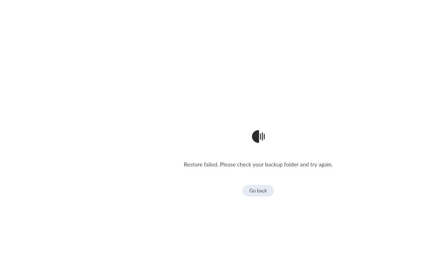

Repeated Roon crashes on Nucleus Titan during backup restore (ref#I13CF7)
· Roon keeps crashing and asking me to restore a backup. It takes me multiple times to restore a backup (I have multiples). Only occasionally does it actually "take" the restore. More often it crashes and asks me to do it again. When it does take, I typically try to backup again to get a new backup and that crashes. I am running Roon on a Nucleus Titan. I could use help in getting myself back up and running.

Hi @Brian_Fay,
Thanks for writing in and for sharing your report! From a fresh diagnostic report, we can see repeated network failures, which could be playing a role in your issues.
As a next step, I’d simplfy your network setup temporarily, and get a direct ethernet connection from your Nucleus directly to your primary router. Then, reboot everything and see if you experience the same issues.

I am working on that so please do not close this. I have purchased a high speed ssd drive to add to the titan. I will copy my backups from my nas to this drive and then attach directly to my titan. That should help us to ensure that connection issues is not the problem. Make sense\? Once completed, we can work to restore from one of the many backups that i have already. Sound good?
Hello @Brian_Fay,
That makes perfect sense. Using a high-speed SSD attached directly to your Titan is a great way to “remove the middleman” and rule out network instability as the cause of the restore failures.
While you are setting that up, I wanted to point out a specific detail in the logs you shared that confirms why your NAS-based restores were likely failing. We see multiple “Host is down” errors and a critical “Result[Status=NotAvailable]” during the backup restoration process.

These errors indicate that at the very moment Roon was trying to pull data from your \BearStation NAS, the connection dropped or the NAS became unresponsive. Because a database restore is a continuous, high-intensity data transfer, even a split-second “hiccup” in your network or a brief period of unresponsiveness from the NAS will cause the whole restore to crash.
Moving the backups to a local SSD should bypass these CIFS/SMB timeouts entirely and give the Titan a stable, direct path to the data.
Got it. i was able to successfully restore yesterday and tried to backup to my SSD directly attached to the Nucleus. However, it crashed during the backup process and disconnected from Roon Server. I tried to connect unsuccessfully for some time and eventually got back, up and running. What are my options to get it back to a regular backup to my attached SSD?

From a fresh diagnostic report, we can see the SSD was plugged in around 07:04 local time and was seen by the system. At 13:44 local, a manual backup to the SSD was triggered. It initialized successfully, created the NEW BACKUPS for ROON folder, and began computing files to back up — then crashed at 13:47:16 with this error:

The backup failure triggered a database corruption event and crashed the Roon broker. The memory stats leading up to this show the process was consuming a staggering amount of RAM — climbing from 194MB to 9,524MB physical in under 5 minutes before hitting the wall.
Later on, the service came back up. The SSD was still mounted and visible. The system then ran a restore operation from the old BearStation/music share at 02:53 UTC (22:53 local), which succeeded. This was Roon recovering the database from the prior backup on BearStation.
We then see a handful of successful manual backups. From there, Mar 31, 01:00 (local) — Scheduled auto-backup to SSD → SUCCESS Only 148 incremental files, completed in ~5 minutes. Clean.
Mar 31, 03:00 (local) — Scheduled backup to BearStation → FAILED (NotAvailable) The BearStation music share was still unreachable (consistent with the kernel logs showing constant LOGON_FAILURE).
Mar 31, 04:00 (local) — Backup to BearStation backups_new share → SUCCESS This one did mount and complete — so BearStation itself isn’t dead, but the music share specifically has the credential/access problem.
With that, we also reviewed the Nucleus system log, and saw 99%+ of all log content was a single repeating error:
CIFS: Attempting to mount //BearStation.local/music
CIFS: Status code returned 0xc000006d STATUS_LOGON_FAILURE
I would investigate the BearStation credentials, re-enter the SMB username/password in Roon’s storage settings. The continuous LOGON_FAILURE suggests something changed (password rotation, NAS update, guest access disabled)
In addition to this, the SSD backup appears to now be healthy, no action needed there. The first attempt failed due to OOM; subsequent runs worked fine.
  • Monitor memory usage — if the library continues to grow, this OOM condition could recur. Consider whether the Nucleus Titan has enough RAM for the database size.
Although it looks like you have ~25k tracks and ~15GB of RAM, which should be plenty.
