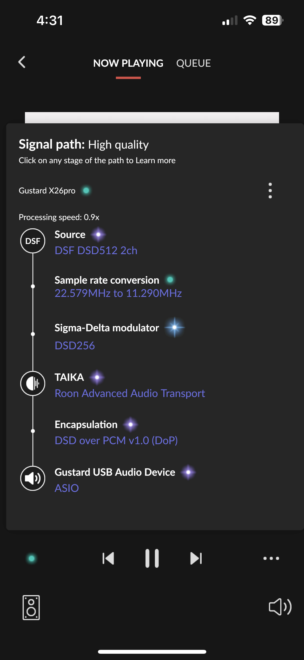

Roon doesn’t give a Native DSD option for the Gustard x26pro DAC (using the latest firmware and ASIO drivers available). Native DSD is required to make use of its DSD512 playback. Without it, Roon will only allow up to DSD256, which means Roon downsamples instead of providing bitperfect playback. Please work with Gustard (if necessary) to provide a Native DSD and DSD512 support for the x26pro when using their ASIO driver.

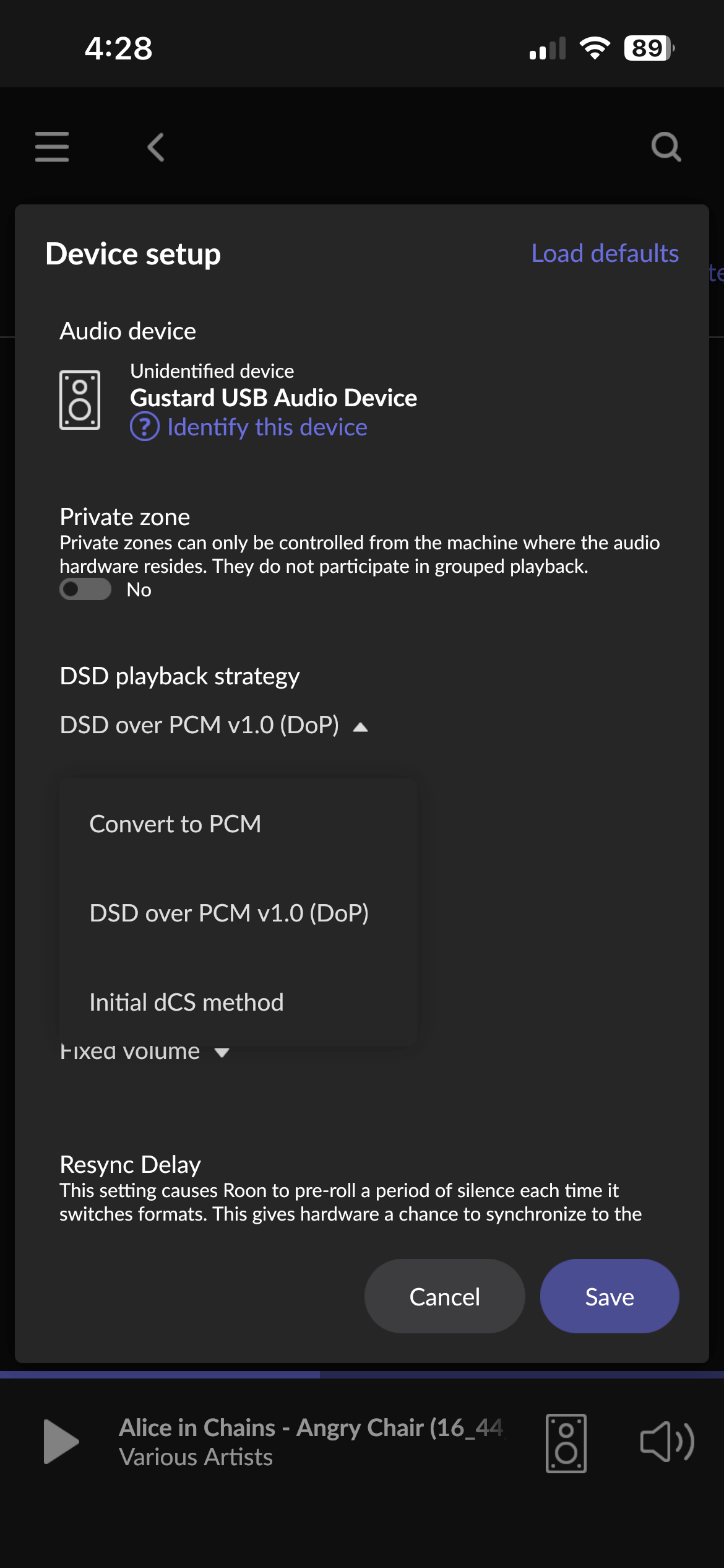

On windows to achieve native DSD and such a high rate you will need an ASIO driver installed from the manufacturer Roon doesn’t work with Gustard to achieve this, it’s up to them. You also need to enable the ASIO drivers output in the audio settings menu for the dac.

The DAC supports up to DSD256 via DoP and DSD512 via Native DSD. I can only realize DSD256 via DoP at this point (and I know that’s the ceiling for DoP on this DAC).
Native DSD is not selectable (which is why I’ve opened the bug), but curiously some “Initial dCS” scheme is (even though it doesn’t work at all).
Show your signal path so we can see if Roon is using the ASIO driver. If it is then you need to reach out to Gustard as it’s not working as it should. Have you tried any other apps to see if they can achieve native and 512. Does the DAC have a readout so you can check what it’s receiving to be sure it’s getting what you think.

A: Yes, it shows DSD 11.2 (aka 256) instead of 22.5 (aka 512). Which matches what Roon’s signal path shows:

@AMT thank you for the sharp eyes and the link to the 5.68 driver! It solved my issue. I can select Native and 512 now. :astonished:
